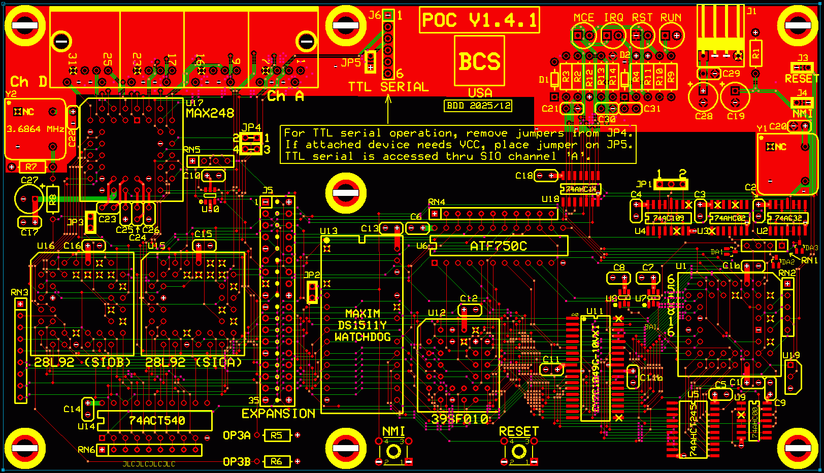

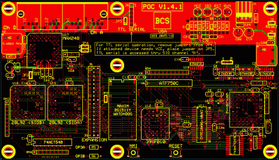

POC Computer Version One: Marching Onward
A while back, I bloviated a bit on POC V1.4, which wrapped up most of POC V1.3’s discrete glue logic into a 7.5ns 22V10 GAL.  The goal was to build a unit that could potentially be clocked beyond 20 MHz.  Unfortunately, V1.4’s stretchable-clock design proved to be not be up to the task, and the unit pooped out above 16 MHz, same as did V1.3 (and for the same reason).  POC V1.4 has joined the hall of shame, alongside a couple of other failed designs.  :D
V1.4’s shortcomings led to further clock generation experiments, resulting in a new clock circuit design that checked out at 40 MHz.  The question then became one of how to test the new-and-improved clock generator in a real-world application.  I had considered butchering up V1.3 to do the testing, but was reluctant to risk wrecking the only specimen of that design.  I concluded the way forward was to update V1.4. to V1.4.1.
V1.4.1 is mostly an evolutionary step; except for the clock generator, a larger address space and slightly different memory map, it is functionally similar to  V1.3 and V1.4.1.  Here are the schematic, PCB layout and GAL equations:
v1_4_1.pdf
POC V1.4.1 Schematic
(387.13 KiB) Downloaded 35 times
POC V1.4.1 PCB Layout
v1_4_1_gal.txt
POC V1.4.1 GAL Equations
(7.19 KiB) Downloaded 28 times
Salient features are:
  • Larger Address Space
    V1.3 and V1.4 have 128KB address space, of which 112KB is RAM, and 64KB of that is contiguous, extended RAM ($010000 - $01FFFF).  V1.4.1 has 256KB address space, of which 242KB is RAM and 192KB of that is contiguous, extended RAM ($010000 - $03FFFF).
  • Selectable Wait-State Duration
    The clock generator can be configured to stretch Ø2 high for either one or two clock cycles.  The latter may become necessary if I can get this thing to run in the 25 MHz range.
  • Discriminatory I/O Wait-Stating
    In V1.3, any access to the I/O block ($00C000-$00CFFF) results in a wait-state, even when accessing a device that doesn’t require one.  This behavior is due to limitations in V1.3’s discrete glue logic.  V1.4.1’s logic discriminates between devices that must be wait-stated and those that can run at full speed.
  • Better Data Bus Management
    During testing on V1.3 with the logic analyzer, I determined that some data bus contention was going on during a read cycle when the 65C816 switches from emitting the bank bits to listening on the data bus, this despite the /RD (read data) strobe being qualified with Ø2.  I added a transceiver to the data bus to keep it isolated until after the rise of Ø2.
  • New Expansion Port Arrangement
    I devised some electrical and mechanical changes to the expansion port with an eye to being able to try out several different card designs, as well as to correct some deficiencies noted in the past.
    • New Socket
      Past POC units used a DIP28 socket on the mainboard as the expansion port, an arrangement that has had less-than-sterling reliability.  V1.4.1’s expansion port is a Samtech square-pin female header (P/N SSW-118-01-T-Q) whose 36 pins are arranged on two rows spaced 200 mils (5.08 mm) apart.  Aside from offering a more-positive retention characteristic, this header makes it possible for a vertically-mounted expansion card to be self-supporting, something that wasn’t practical with the slot-style expansion connector on V1.4.
      The expansion layout I devised also permits mezzanine-style card mounting, similar to what V1.3 has.  As a greater force will be required to plug a card into the Samtech header than was required with the DIP socket, I added an extra mounting hole to the PCB near the expansion socket to prevent flexing when inserting a card.
    • Additional Signals
      The new expansion port includes signals that would be needed to correctly interface 65xx-type I/O devices, e.g., a 65C22, to the expansion port.  The extra signals are GCLK (global clock, which is a non-stretched signal in phase with Ø2) and RWB, the 65C816’s read/write signal.  One of the chip-selects assigned to the expansion port, XIOA, is not wait-stated and is suitable for use with a WDC 65C21 or WDC 65C22 at Ø2 speeds up to 20 MHz.
    • More Robust Power Connections
      There are three VCC and six ground connections, versus one VCC and three grounds with the DIP expansion socket.  Having only one VCC connection proved to be a bit of a trouble-maker with the SCSI host adapter, as the SCSI bus may sink upwards of 500 mA during some stages of its protocol.  During testing of the most-recent host adapter design, I noted a small amount of VCC sag was going on during SCSI activity and decided that it had to be corrected.
  • Flash ROM for Firmware
    I have been using 27C256 UV-erasable EPROMs since time immemorial, mainly because I had a lot of them, as well as an EPROM eraser that could erase 20 at a time.  With heavy usage, some have developed “stuck bits” and thus my supply has been slowly depleted.  While I still have quite a few EPROMs, I finally decided to get with the times and switch to a 55ns 39SF010 flash ROM for the firmware.  The flash is in a PLCC32 package, which of course affected the PCB layout.
  • RTC Mounted On Main Board
    Like V1.4, V1.4.1 has the Maxim DS1511 RTC mounted on the main PCB.  V1.3 and earlier mounted it on the SCSI host adapter because the RTC’s socket was pressed into service as the expansion socket.
  • MCE Indicator
    The MCE (machine check exception) indicator is a red LED that is indirectly driven by the 65C816’s E output, which is high when the 816 is running in emulation mode.  The 816 is immediately switched to native mode following reset, which means MCE should be dark during normal operation.
    In the first stage of POST, which is prior to any I/O being established, a memory test is conducted on critical RAM areas.  If a failure occurs during this test, there is no way to report it on the console, but it could be reported with the MCE indicator.  Ergo the 816 will be returned to emulation mode, causing MCE to illuminate, after which the 816 will be halted with the STP instruction.  I’ve been contemplating a way to make MCE flash when this sort of fault occurs.
There are no DIP packages in this design, other than the GAL.  With a few exceptions, discrete devices are either SIOC or SOJ.  As two latches are needed to generate the A16 and A17 signals required to support extended RAM, I decided to use a pair of 74LVC1G373s (SOT-23 packages), which have a D-to-Q Tpd rating of 4ns maximum on 5 volts.  The GAL logic includes the state of A16 and A17 in decoding decisions, so the very rapid Tpd of these devices helps to maximize overall glue logic performance.  All GAL logic is combinatorial, so the estimated total prop time through the logic will be 11.5ns, worst-case.
Testing has shown that the 0.6µ version of the 65C816 typically emits a valid address 12ns after the fall of Ø2.  At 20 MHz, Ø2 low lasts 25ns, which assuming the 12ns number is consistent, leaves 13ns of Ø2-low time to generate a chip select and determine if a wait-state is required.  The wait-state hardware (a J-K flop) uses a timing clock signal that slightly lags Ø2, so there is some leeway in how quickly the wait-state enable (/WSE in the schematic) must be asserted relative to Ø2.  It was this aspect of the older design that faltered above 16 MHz.
So the next step after I have slept on this design for a few days will be to build it and see if it goes or blows.

Thanks for the updates BDD. Gosh, between the 'POC saga' and Barnacle's 'FAT quest' there's a lot of addictive reading for Christmas.
I'm going to watch this space for your results, as I also am pondering upon how to improve the glue logic speed of my 65816/pico2 contraption.
Glenn-in-France
PCBs have arrived, so it’s time to warm up the soldering iron!
Posts: 9426
POC Computer Version One: Slowly Marching Onward
V1.4.1’s SMT soldering has been completed, but the stresses and strains of daily living (plus wrestling with a TLS project on a client’s mail server) seem to be consuming too much time.  Also, my wife, who underwent surgery in January, but did not recover very well, is needing a lot of care right now.  So there’s that.  I’ll eventually get to finishing V1.4.1, but not sure how soon.
