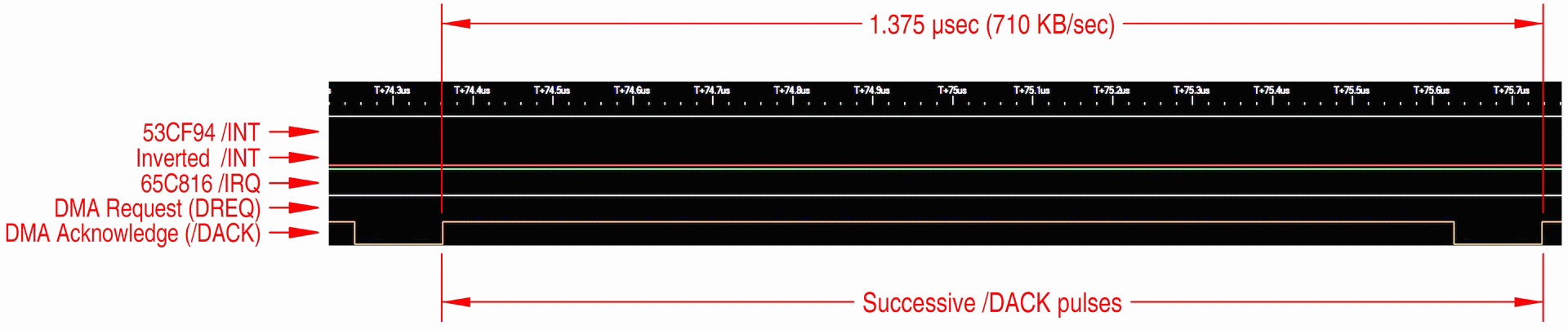

POC Computer Version One: SCSI Revisited
Posted: Fri Jul 05, 2024 8:29 am
by BigDumbDinosaur
Many pages ago, I described the SCSI host adapter I built to attach mass storage to my POC units.  First a little history...
The core of the original host adapter was the 53C94 “advanced SCSI controller,” an NCR device that was second-sourced by AMD and others, and was used in the host adapters of a number of different systems.  The C94 is a member of a family of NCR SASI/SCSI controllers that dates back to the early 1980s, well before SCSI had been defined as a formal standard.  The C94 has considerable intelligence, offloading virtually all aspects of the bus protocol from the host system.  That intelligence makes it possible to support SCSI without the need for the driver having to know much about the bus protocol.

The next capture shows successive /DACK pulses in response to being toggled during the “request sense” command’s data-in phase.  This capture is with a new SCSI driver that takes advantage of the HBA’s delayed IRQ feature.
Data-In Rate — Successive /DACK Pulses
Recall that /DACK is toggled to read a byte from the CF94’s FIFO.  Hence the interval between successive /DACK toggles can give a fairly-accurate picture of the effective data transfer rate.  /DACK rises as soon as the MPU has fetched from the FIFO, so /DACK’s rise is the reference point I used.  That period was 1.620 µsecs with the earlier HBA design, which is equivalent to an average transfer rate of 603 KB/second.  The actual transfer rate is somewhat slower than what I estimated from the cycle count in the read loop executed during data-in, possibly due to a jiffy IRQ hitting at some point during the transfer.
With a new SCSI driver not having the SEI - CLI pair in the data-in loop, the logic analyzer indicated that 1.375 µsecs elapsed between successive /DACK pulses, translating to a transfer rate of 710 KB/second, an 18 percent improvement.  The 710 KB/second rate was exactly the same as the rate seen during a one-block disk write (512 bytes); the data-out loop has never had a timing race.
For now, 710 KB/second is about as fast as POC V1.3 is going to go during SCSI operations.  This limit is essentially a function of how rapidly the MPU can do “pretend DMA” during an information transfer phase.  Ø2 clock speed is mostly the determining factor, and Ø2 at 16 MHz is as fast as the V1.3 hardware can go.  In theory, if V1.3 could be run at 20 MHz, the transfer rate could increase to about 880 KB/second.  The next POC design should take care of that.  :D
