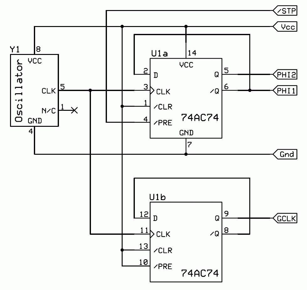

Re: POC VERSION TWO POINT TWO: Wait-States

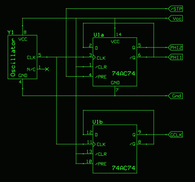

Opinions?
Green on a black background kinda sucks. (Oh! -- about the circuit, you mean! :wink: :P )

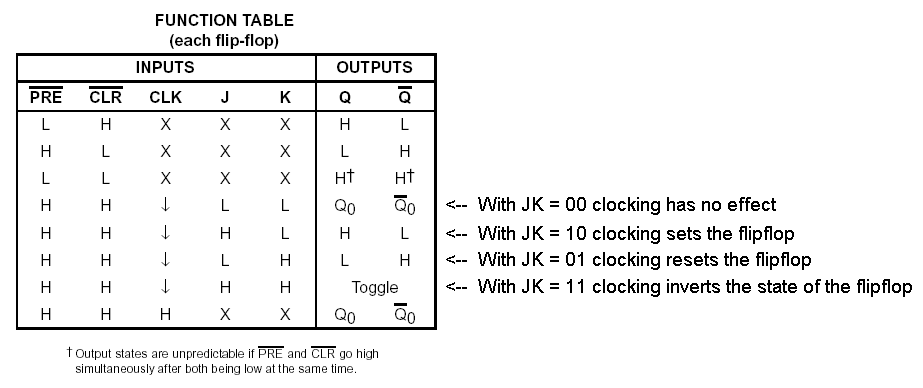

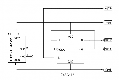

Don't forget the humble JK flipflop (below). I've drawn this using 'AC112, but with trivial changes the 'AC109 will also work. (With J and /K tied together the '109 can masquerade as a '74, which increases the potential utility of the other flipflop section in the package.) With this circuit it's better if your /STP signal becomes valid before the rise of Phi2 (but I assume that's already the case).

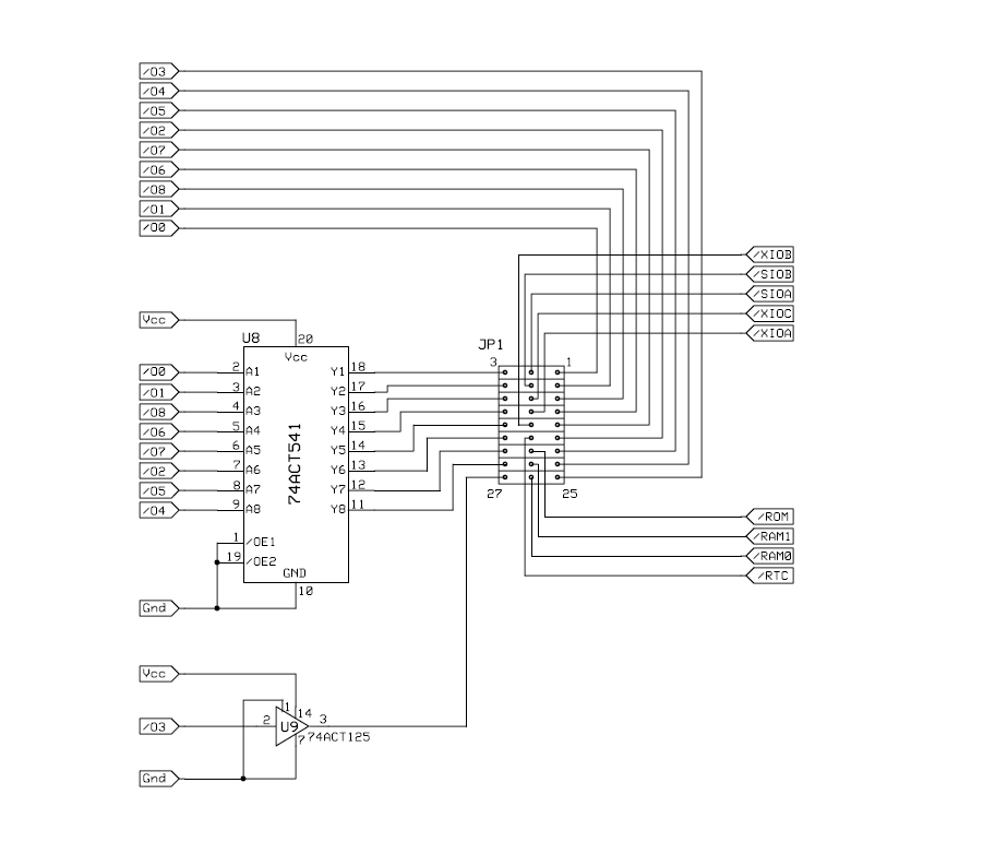

On another topic, I noticed the following portion of your schematic (below). Maybe eight of those nine jumpers can be omitted. Assuming the 'ACT541 is in a socket, it could, for testing purposes, be removed and replaced with a male header wired to simply bridge the inputs straight to the outputs (which is what the jumpers did). Of course the test would apply to all 8 of the signals -- IOW you can't pick & choose on an individual basis. That doesn't seem to me like a dealbreaker, though. If necessary you could use pullup resistors to alter the VOH of individual signals.

Opinions?
Picky, picky! :D
Two-Phase Clock Generator w/Stop
Yes, that would work as well. Once advantage the 'AC74 has over the 'AC112 is the former is in a smaller package.
The CPLD logic is such that it would make a decision on wait-stating when GCLK goes high. At that point, the effective address has settled and I have the whole of the GCLK high phase in which to assert /STP and stop everything. Similarly, when the wait-state expires, /STP would be de-asserted during GCLK high, keeping Ø2 in phase with GCLK. In both case, so my thinking goes, the change of state of /STP will always slightly lag the rise of GCLK due to the CPLD's pin-to-pin delay (7-10ns), which should eliminate any glitches.
In any case, my main question is if my idea is even feasible.
On another topic, I noticed the following portion of your schematic (below). Maybe eight of those nine jumpers can be omitted. Assuming the 'ACT541 is in a socket...
The 'ACT541 is in an SOIC20 package, hence the jumper block.

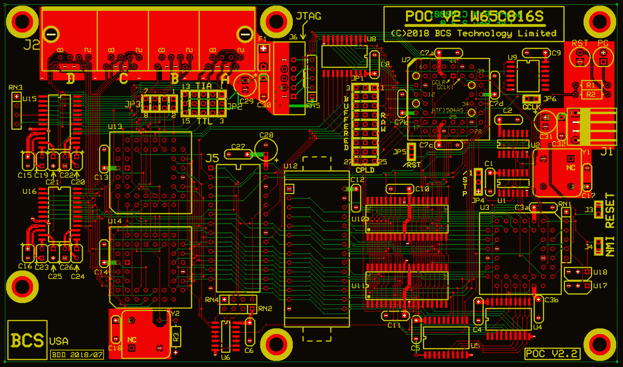

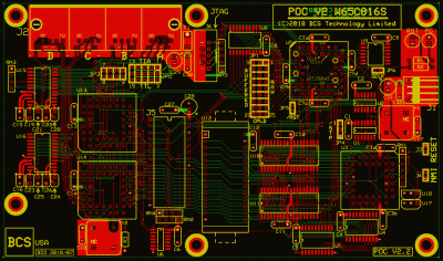

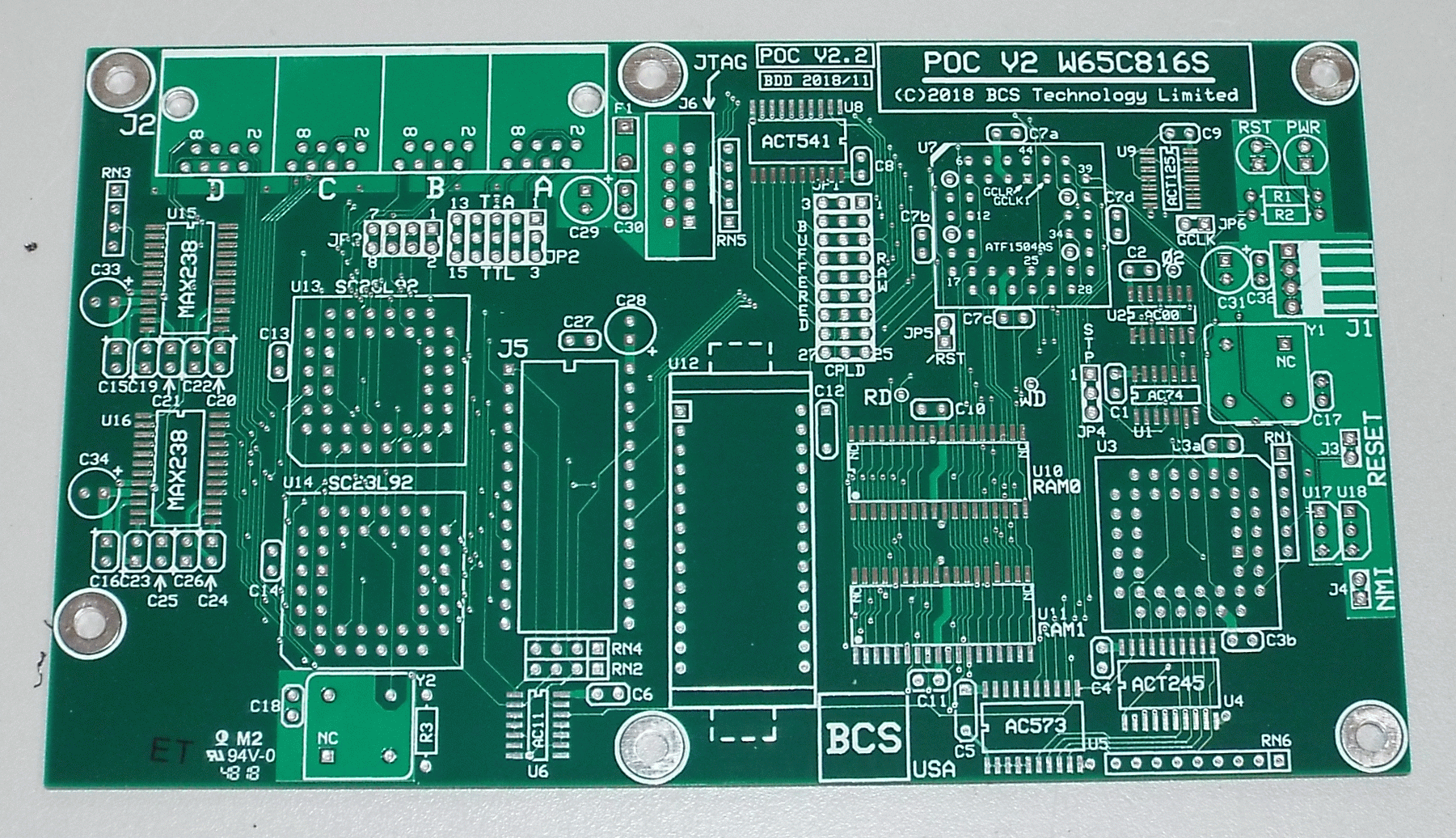

POC VERSION TWO: V2.2 Update
I added some circuitry to implement "clock stretching" to be used in lieu of RDY for generating wait-states. The clock control circuitry is arranged so I can isolate it with jumpers from the rest of the system for experimentation purposes. I also did some rearranging of the PCB in order to get a more favorable routing of the /IRQ line and some other traces. The updated schematic and PCB layout are attached. I will go over these once more in a day or two to double-check for errors, after which the Gerbers will be submitted to get boards made.
poc_v2.2_schematic.pdf
Schematic
(364.34 KiB) Downloaded 188 times
Printed Circuit Board

Post by GaBuZoMeu »
Well, no response of anyone else so far.
I downloaded your schematic and take a glimpse on it - didn't find anything annoying :)
You have made no provisions for a (G)CLK signal on the expansion header - probably you intend no sort of extension that could benefit from that.
Regards.

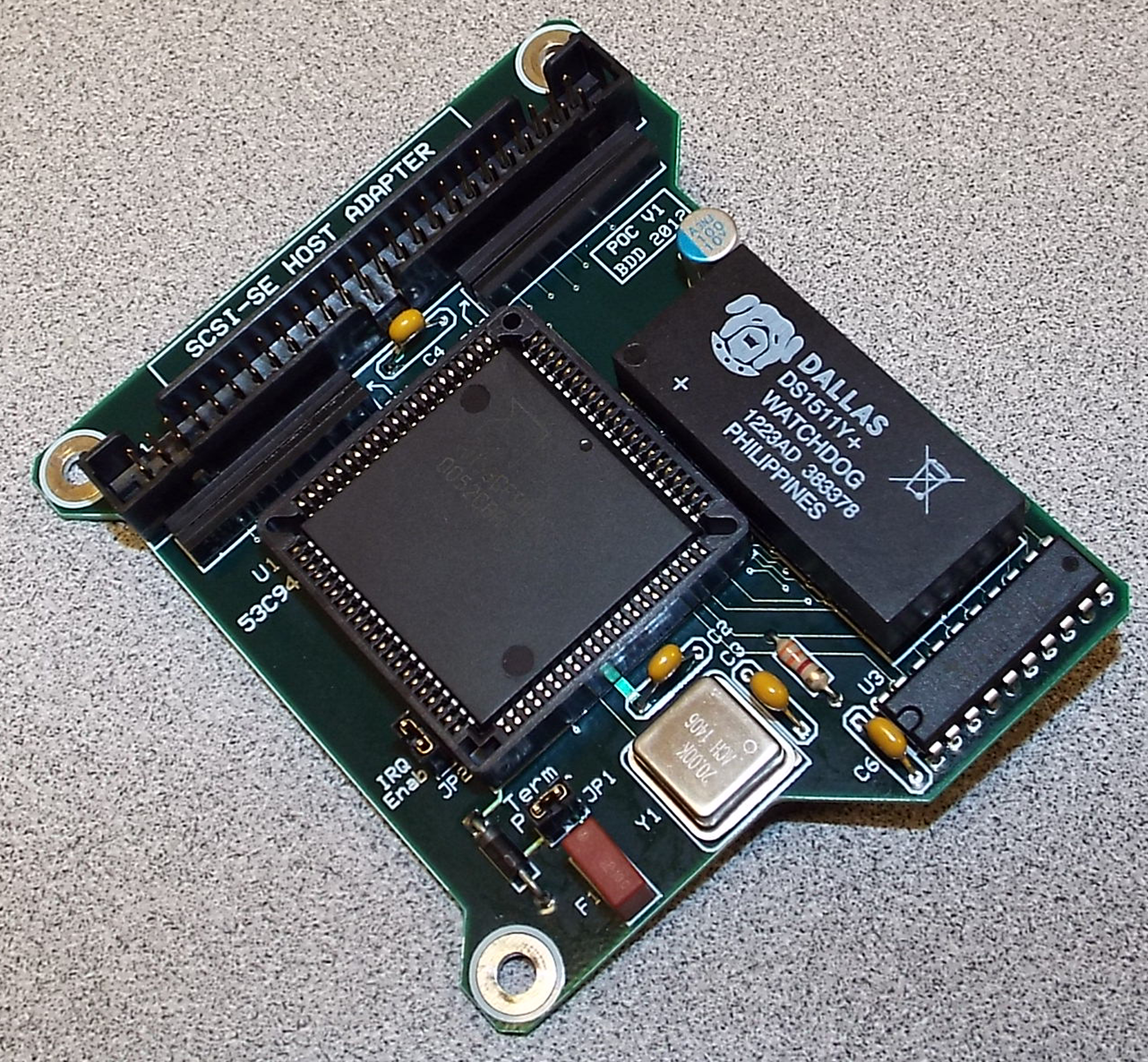

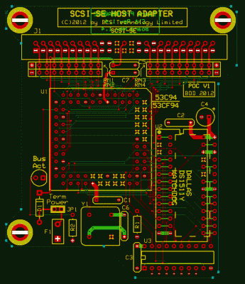

Anything that would be connected to the expansion socket would be using the Intel-style read/write circuitry and would not require reference to GCLK. The only peripheral I have built to date to plug into expansion is a SCSI host adapter, which has its own clock source.
SCSI Host Adapter PCB
scsi_hba_schematic.pdf
SCSI Host Adapter Schematic
(99.45 KiB) Downloaded 180 times
SCSI-SE Host Adapter

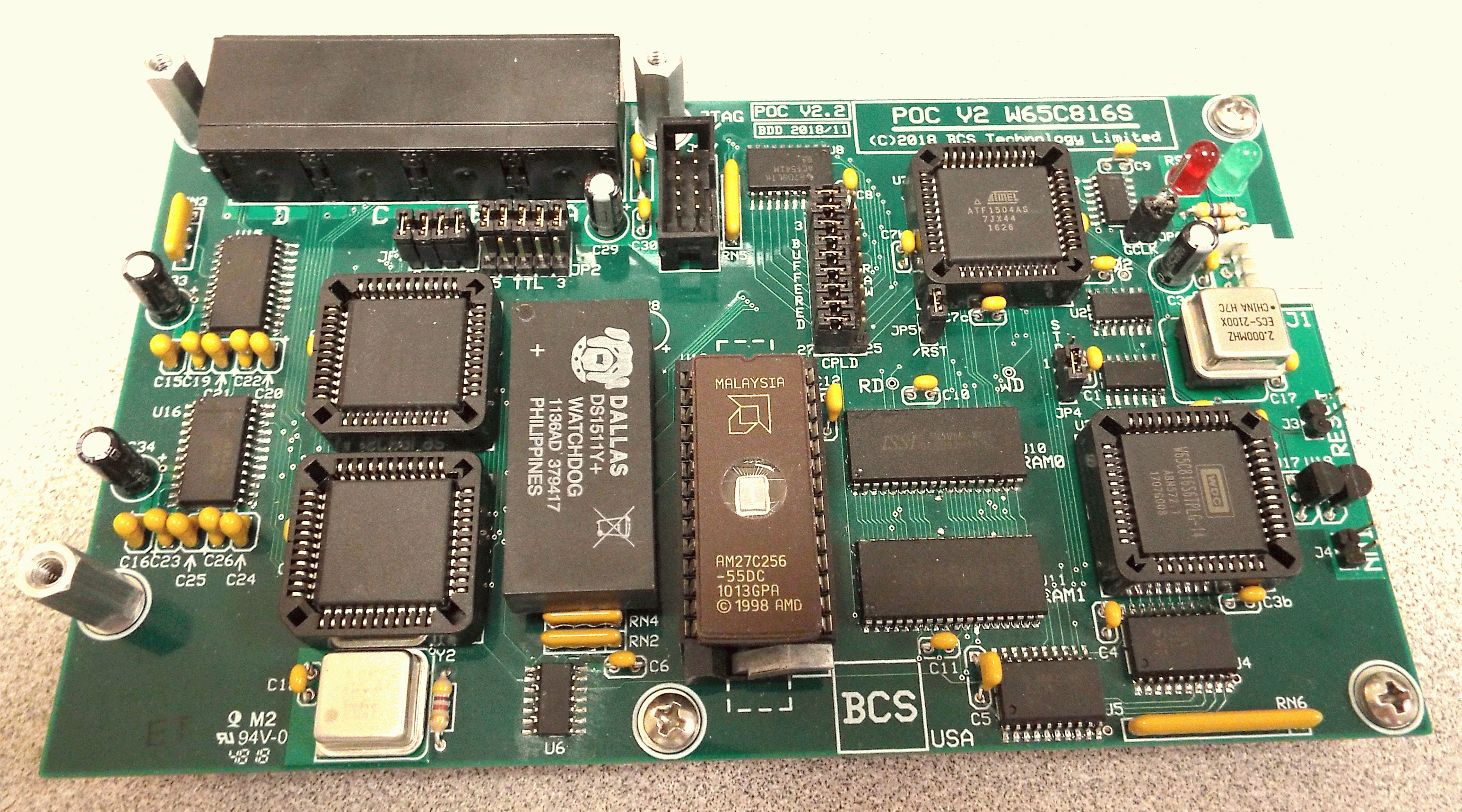

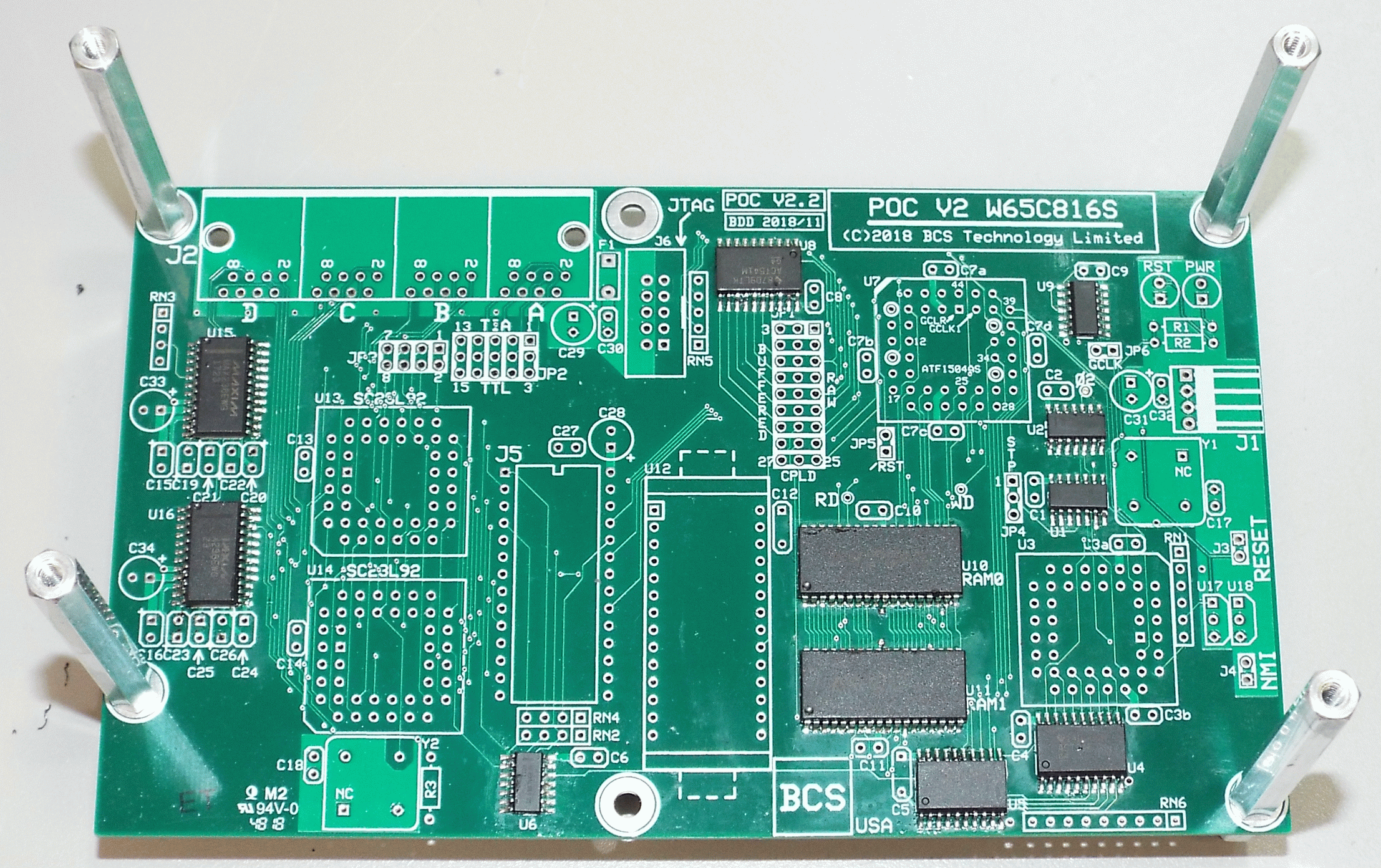

Like everything else, this project ended up on the back burner as I grappled with medical maladies. I was able to assemble the unit and do some preliminary testing before I ended up in the hospital. However, too much time has elapsed from then to now. So I need to start from scratch with testing—I have no recollection of how far I had gotten—and see if it will go or blow. Meanwhile, I'm in a race to catch up with client work I was doing when the hospital beckoned. :D So I am not sure when I will be able to get back on this.
Meanwhile, here are some photos of POC V2.2 I had taken during and after assembly.
POC V2.2 Bare PCB
POC V2.2 Bare PCB
POC V2.2 PCB w/SMT Devices
POC V2.2 Assembled
POC V2.2 Assembled

Looks very nice. Good to see another '816 system going!
Posts: 9425
Re: POC VERSION TWO
Thanks! Of course, I have no idea at this point if it will work. :shock:
