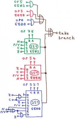

With K24, we have a mechanism for switching the instruction set (selecting a different microcode)
during run time... but it all is 6502 related.
What, if one would be trying to switch to a non_6502 related instruction set ?
I'm not talking about trying to be cycle or timing compatible to a non_6502 CPU,
it's just about the possibility of being able to run the legal instruction set of a non_6502 CPU.
Let's start with the 6800.
Simply because the design team that did the 6800 later had some 6502 relevance...

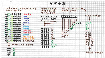

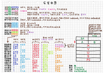

Unlike the 6502, 6800 is big endian (high Byte first).
Stack operations seem to be post_decrement and pre_increment, like with the 6502.
What happens during the interrupts still needs to be investigated.
Conditional branches are a little bit more sophisticated than with the 6502,
on the other hand there is no decimal mode: just DAA and a half carry flag.
To me, the rest of the 6800 instruction set looks somewhat trivial:
6800 would open a vector to implementing something like the 6809.
A TTL CPU designed to run the 65816 instruction set almost would have enough registers for a 6809 emulation.
6809 is big_endian, too.
But unlike with the 6502 and 6800, Stack operations seem to be pre_decrement and post_increment, like with 68k.
6809 is NOT binary compatible to 6800, because some of the opcodes have moved places in the table.
6809 is a complicated beast, with two prefix Bytes, and with two post Bytes (PUSH\PULL, and indirect addressing).

A crude (but more detailed) block diagram for handling the conditional branches,
which BTW does not include the 65C02 "test Bit and branch" instructions.
