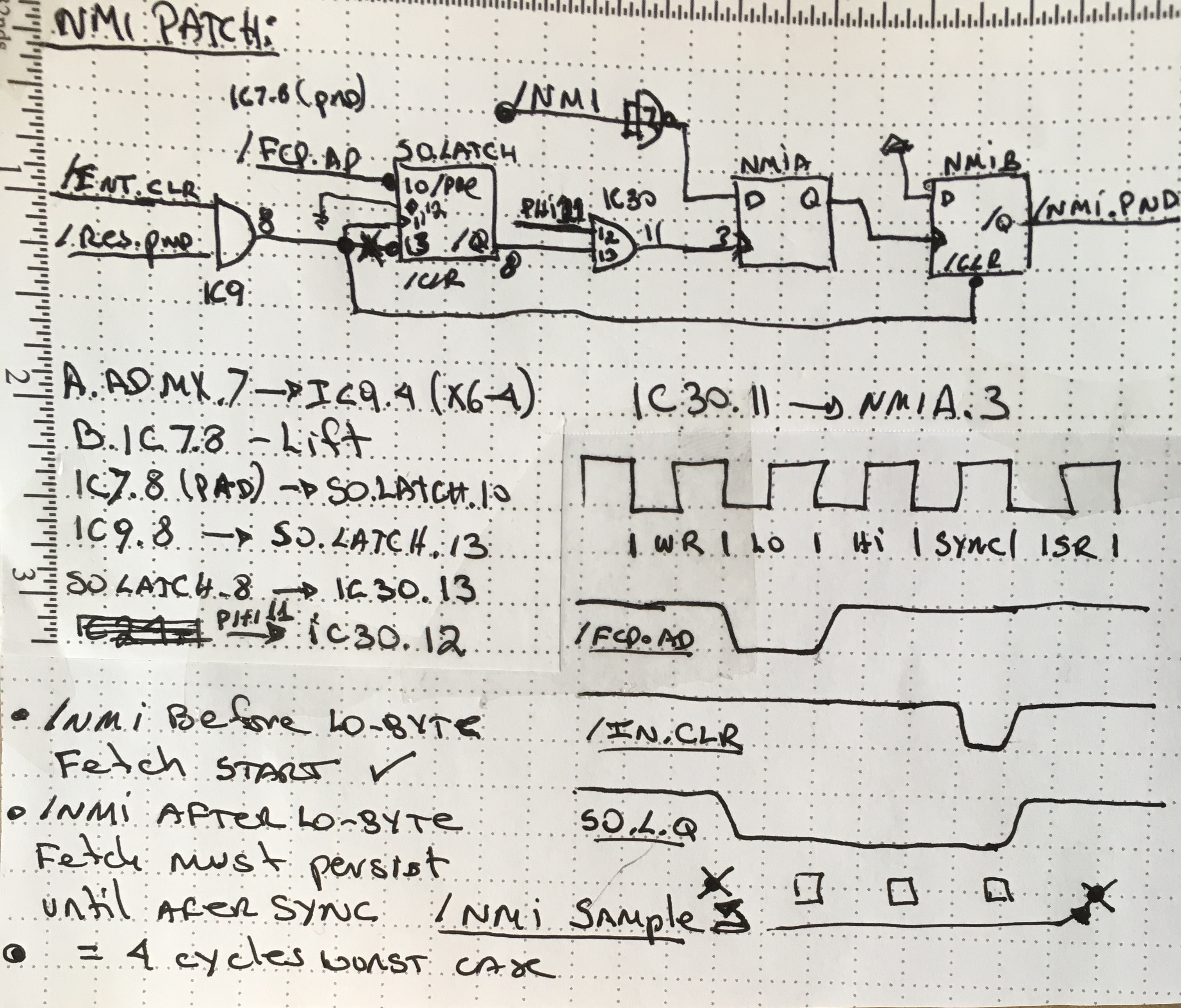

Alrighty then ... the boards are getting harder and harder to patch, with jumpers chris-crossing each other and ICs repurposed here and there. And yet there is more: turns out Impossible Mission also suffered from a “Lost NMI”. :evil:
I didn’t know whether to feel dismayed or grateful at this point. Truth be told, these bugs would have been nearly impossible to find were it not for these two games (IK+ and Impossible Mission). In each, the code hangs within a few seconds of start, and the Analyzer shows the problematic interaction between IRQ, NMI and RDY just before the breakdown very clearly. Nice!
In the end, the solution here was to inhibit sampling of the NMI pin at the beginning of the vector low-byte fetch, and to resume only once the final SYNC cycle of the BRK sequence is finished. In this way, a “Late NMI” is safely deferred until after BRK completes. The NMI will then interrupt the sercond SYNC of the ISR in progress (just as happens with the NMOS 6502).
Here now is the patch:
And with that, Impossible Mission came to life!
Differences in the TTL CPU to the NMOS 6502 handling of NMI are now as follows:
  1. NMI is sampled on the fall of PHI2 (rather than the rise of PHI2 for the NMOS 6502),
  2. A “Late NMI” arriving after the vector low-byte fetch must persist past the completion of the final SYNC cycle in the BRK sequence, or it will be lost. This means the minimum pulse width for a “Late NMI” is 4 cycles (rather than 2.5 cycles for the NMOS 6502).
I don’t think I can get a closer match to the NMOS 6502 behaviour without adding more ICs to the boards. Here’s hoping that won’t be necessary. By way of recap, the compatibility changes we have so far are as follows:
  • Implemented NMOS 6502 RDY to pause only on Read cycles
  • Verified the behaviour of all Dead Cycles for both NMOS and CMOS microcode
  • Implemented the RWW sequence for NMOS RMW instructions
  • Fixed the sampling of NMI to more closely reflect the NMOS 6502 behaviour.
And somehow I have a feeling this might not be the last of it. More testing ahead! :)

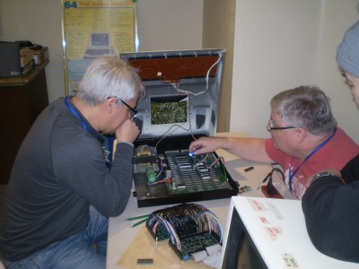

Also in our plans for the day was to carry-out our very own Connect-A-thon! — a.k.a testing the TTL CPU with other machines. Forum and TPUG member Steve Gray generously volunteered his Commodore PET 8032 for the first test (thank you Steve). Although we'd taken precautions, it was hard to feel absolutely certain the CPU's fast AC logic wouldn't generate overshoots that could damage the PET’s circuitry. After some debate, we decided to go ahead with the test despite the risk that we might have overlooked something. Thankfully, all was well and the PET booted with its familiar jingle-beep and no magic smoke. :)
Steve’s PET had suffered a failure in the video hardware earlier in the day, so unfortunately the display remained blank. Despite this shortcoming, everyone agreed it was a successful boot up, and we moved on to test with Jeff’s KimKlone, which, until today, featured a Rockwell 65C02:
KimKlone booted on reset, but crashed a few milliseconds thereafter. Steve and Jeff suspected the power supply, and decided to “borrow” a hefty capacitor from the PET. Scope in hand, Jeff tried to enhance KK’s power supply with some "on the show floor" patching:
Unfortunately, KK refused to run even with the new CAP installed. We tried various captures with the logic analyzer, but soon realized we had been at it for hours and the room was empty ... the serious debugging would have to wait. :)
