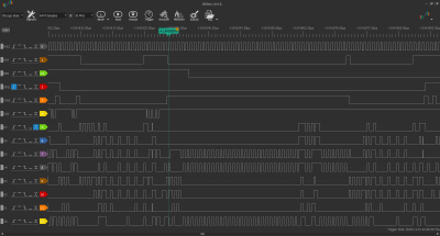

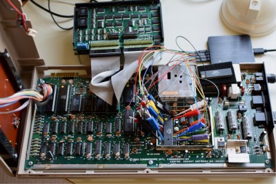

I finally had a chance to patch the NMOS RMW fix. I had to tap lots of signals on the VIC chip to find the problem, but eventually got it: a missing Dead-Cycle write was failing to clear the Raster Interrupt.
The patch turned out to be quite simple in the end -- to replicate the NMOS Dead Cycle write we need to bring R/W low one cycle after the RMW sequence begins. Thankfully, the 65C02 /ML pin circuitry already signals the right moment, so it was easy to drive R/W low at the right time. And after much fuzzing trying to regenerate the right address and data bus values, I gave up and just let bus capacitance handle it. :roll: (It does seem a bit lame, but the right signals are already on the bus! Why not just reuse them.)

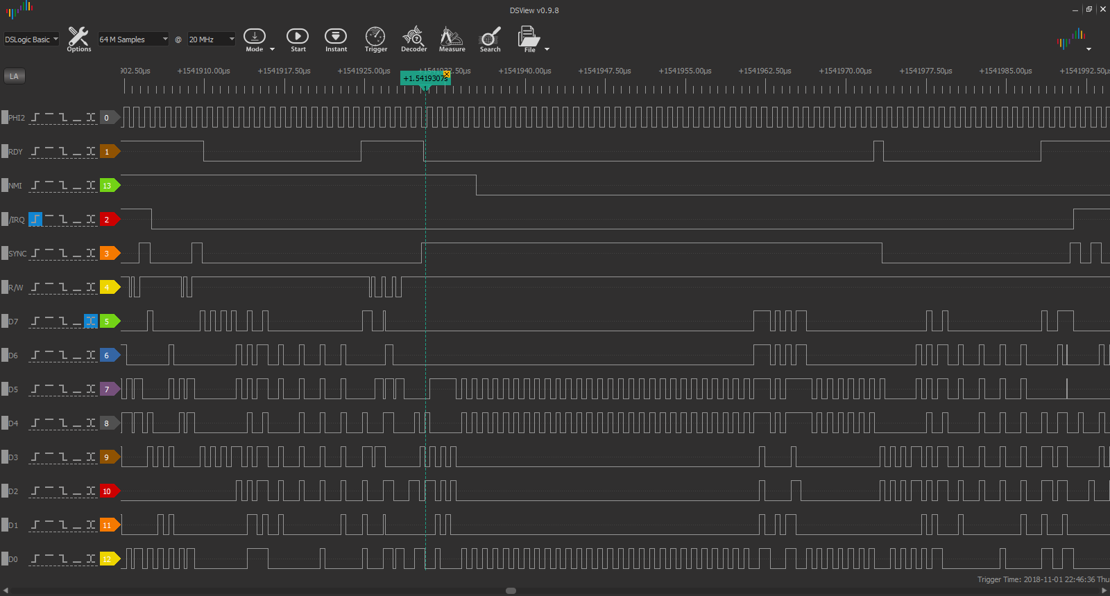

Ok, so firing up Bubble Bobble, it was great to see the RMW cycles as R-W-W now, with a "1" written to D0 to clear the Raster Interrupt and the /IRQ pin going high immediately thereafter. So cool! :D
And it always amazes me that things can be so totally broken in one instant, and then suddenly start working perfectly in the next ...

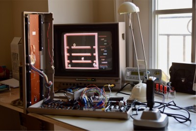

Time for some game play! :P
