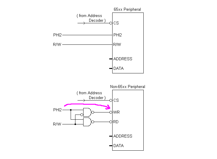

Hmm, let's back up a little.
Where I think the ability to stretch both phases of the clock would be of value would be in interfacing older 65xx peripherals to a modern 65C02 or 65C816 running at high clock speed.
Yes. But even a non-65xx peripheral such as your 28L92 DUART will require stretching of the Ø2 low phase if the CPU clock rate is raised sufficiently.
I'm not saying you've reached that point. But one can't conclude that omitting the low-phase stretch is acceptable simply because "neither ROM or I/O is clocked by Ø2." Your DUART is driven by signals derived from Ø2. (diagram below)
The #1 concern is to avoid writing to an incorrect address (although indeed some devices have registers which are also sensitive to spurious reads). To avoid accessing an incorrect location, we need to wait until the address from the CPU is stable, then continue waiting (with Ø2 low) until the device's address setup time has been satisfied. Only then is it alright for Ø2 to go high, allowing the access to commence. This is true both for 65xx and non-65xx peripherals (and for RAM, too, although RAM is presumably not an issue for POC at present).
I haven't studied POC in detail, and at first I thought the clock stretch only applied to ROM. With ROM it's OK if the stretcher circuit only stretches the high phase. The lack of an extra allocation of low phase (ie: address setup time) might mean the read initially occurs from an incorrect address, but a ROM can recover from that. As long as the total cycle time is sufficient, things will eventually sort themselves out, with no harm done.
Writes are a different story. While it might be tolerable to accidentally read an incorrect address before reading the correct address, it is definitely NOT okay to accidentally write to an incorrect address before writing to the correct address! Now that you've reminded me you're also stretching I/O accesses (which could include writes), it seemed worthwhile to clarify that the Ø2-low phase will in some circumstances require stretching.
Even with non-65xx peripherals, it is the usually rise of Ø2 which begins the access
