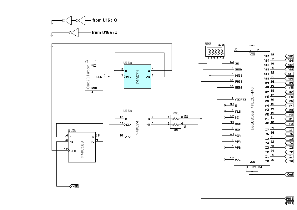

Some probing with the logic analyzer enabled me to determine why POC V1.3 is slower than POC V1.2 (16 MHz vs. 20 MHz). It is, as I suspected, due to the extra glue logic needed to deal with the banking, specifically the logic that keeps ROM and I/O from mirroring in bank $01.
If I try to run the system faster than 16 MHz, prop time through the glue logic results in the clock generator not getting the "stretch the clock" signal soon enough before Ø2 goes high—and the clock just keeps going like nothing happened. ROM and I/O can't respond in the 25ns available during Ø2 high at 20 MHz and the machine augers in.
Oh well! I'm fine with it, as I didn't even expect the unit to run at 16 MHz.

Posts: 3526
Re: POC Computer Version One
Could you sketch that glue logic please BDD?
I'm guessing Ed means mean V1.3. There's a schematic in this post.
And I like the clock-stretch circuit you've got there, BDD. I've taken the liberty of editing away some detail to clarify its workings.
  • U16a (highlighted with color) will always invert its state on every oscillator cycle
  • U16b (immediately below) tries to copy what U16a is doing, but it gets messed with if /WSE (the "stretch the clock" signal) goes low :)
Well, there are two possible solutions to investigate. If the glue logic that generates /WSE can't be made faster, maybe the /WSE timing can be accommodated as-is.
In order for a stretch to occur, /WSE needs to go low before the J-K flipflop U15b gets clocked. So, how about delaying the clocking of U15b? At the top of the diagram I've drawn two possible options. In both cases the goal is to add delay in the path that leads to U15b's clock input.
It's hard to predict how much advantage you'll gain -- it might be substantial or it might be negligible. As you continue to increase the delay on U15b's clock, at some point you'll run afoul of a different timing constraint further downstream. Myself, I'd wanna try an experiment. It only requires a couple of bodge wires (and a spare gate).
Your clock stretcher doesn't use actual Ø2 for its decision, and that could prove to be a very significant advantage. :!:
