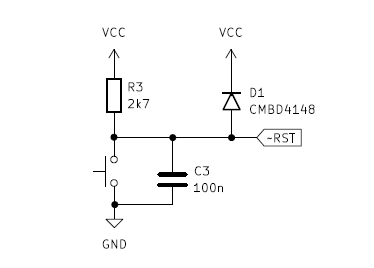

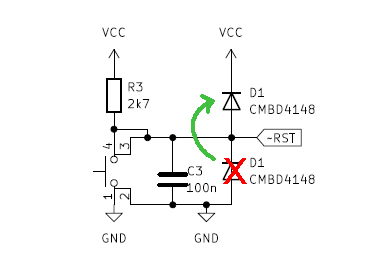

Regarding the reset circuit, the '4148 diode appears (due to a typo?) in an illogical place.
reset circuit .png (8.69 KiB) Viewed 2712 times
As originally drawn (between ground and -Rst) the diode will never conduct, and may as well be omitted.
Instead I believe it ought to be between -Rst and Vcc. In the rare but dangerous circumstance of Vcc sharply dropping from 5 volts to zero (as when an accidental short occurs), the diode ensures that the voltage on the capacitor also gets pulled low. This addresses the very real risk of the CPU getting fried. :!:
(I mean fried in the sense that the reset input of the CPU would get damaged by the voltage on the cap, which would momentarily exceed that of the CPU Vcc pin which is at zero. IOW, without the '4148 diode, the cap will get discharged by the CPU's reset input instead.) :(

Regarding the reset circuit, the '4148 diode appears (due to a typo?) in an illogical place...Instead I believe it ought to be between -Rst and Vcc...
Good catch!  You must’ve been on your second cup of coffee when you spotted that.  :D

When I viewed the diagram above, for a moment I thought "Ehh?" so I boiled it down to its essence:
Boiled down.png (5.08 KiB) Viewed 2684 times
I actually only did this for myself but when I saw the result I thought "Why not", so here it is.
Gr :D :D tings, Louis

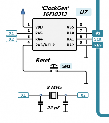

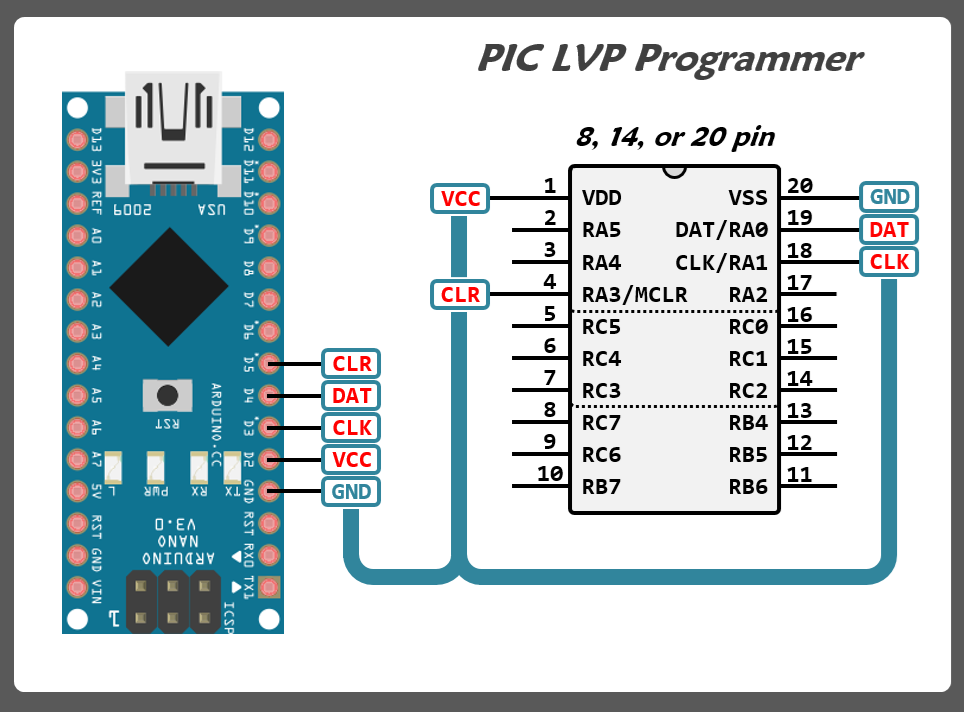

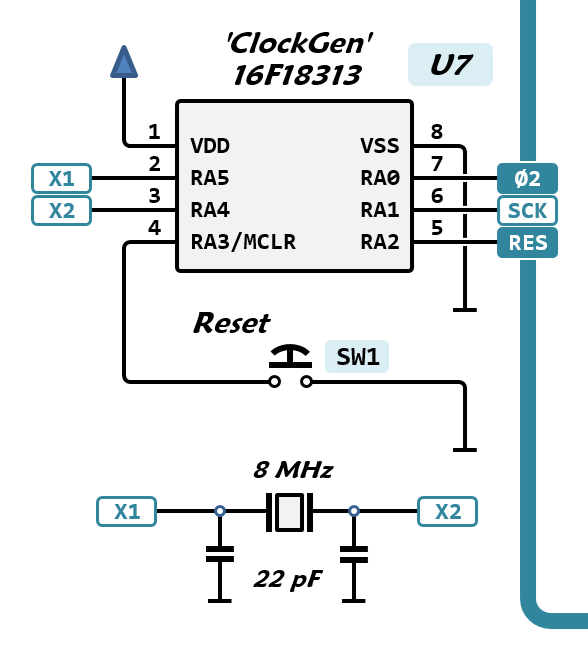

Speaking of reset circuits... I used a little 8-pin PIC16F18313 chip (currently $1.16 single quantity at Mouser) awhile back to provide an econo' reset function as well as CPU and ACIA clock signals. With the least bit of encouragement I could create an Arduino 'sketch' to allow programming the PIC microcontroller with a relatively inexpensive Arduino Nano (or Uno) clone.
Here's an excerpt from the attached PIC microcontroller ASM source;
;  set 'CLKR_div' constant for desired 65C02 clock frequency.
;               6 ->  0.5-MHz (Fosc / 64)
;               5 ->  1.0-MHz (Fosc / 32)
;               4 ->  2.0-MHz (Fosc / 16)
;               3 ->  4.0-MHz (Fosc / 8)
;               2 ->  8.0-MHz (Fosc / 4)
;               1 -> 16.0-MHz (Fosc / 2)
CLKR_div equ    4               ; 2.0-MHz PHI0 CPU clock
;  set 'NCO1_inc' constant for desired ACIA clock output.
;          2517 ->    38400-Hz (  2400 * 16) @ 0.01659%
;          5033 ->    76800-Hz (  4800 * 16) @ 0.00327%
;         10066 ->   153600-Hz (  9600 * 16) @ 0.00327%
;         20133 ->   307200-Hz ( 19200 * 16) @ 0.00169%
;         40265 ->   614400-Hz ( 38400 * 16) @ 0.00079%
;         60398 ->   921600-Hz ( 57600 * 16) @ 0.00004%
;        120796 ->  1843200-Hz (115200 * 16) @ 0.00004%
;        241592 ->  3686400-Hz (230400 * 16) @ 0.00004%
NCO1_inc equ    120796          ; 1.8432-MHz (115200 * 16)
