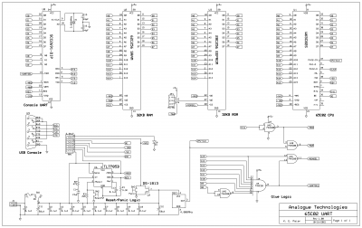

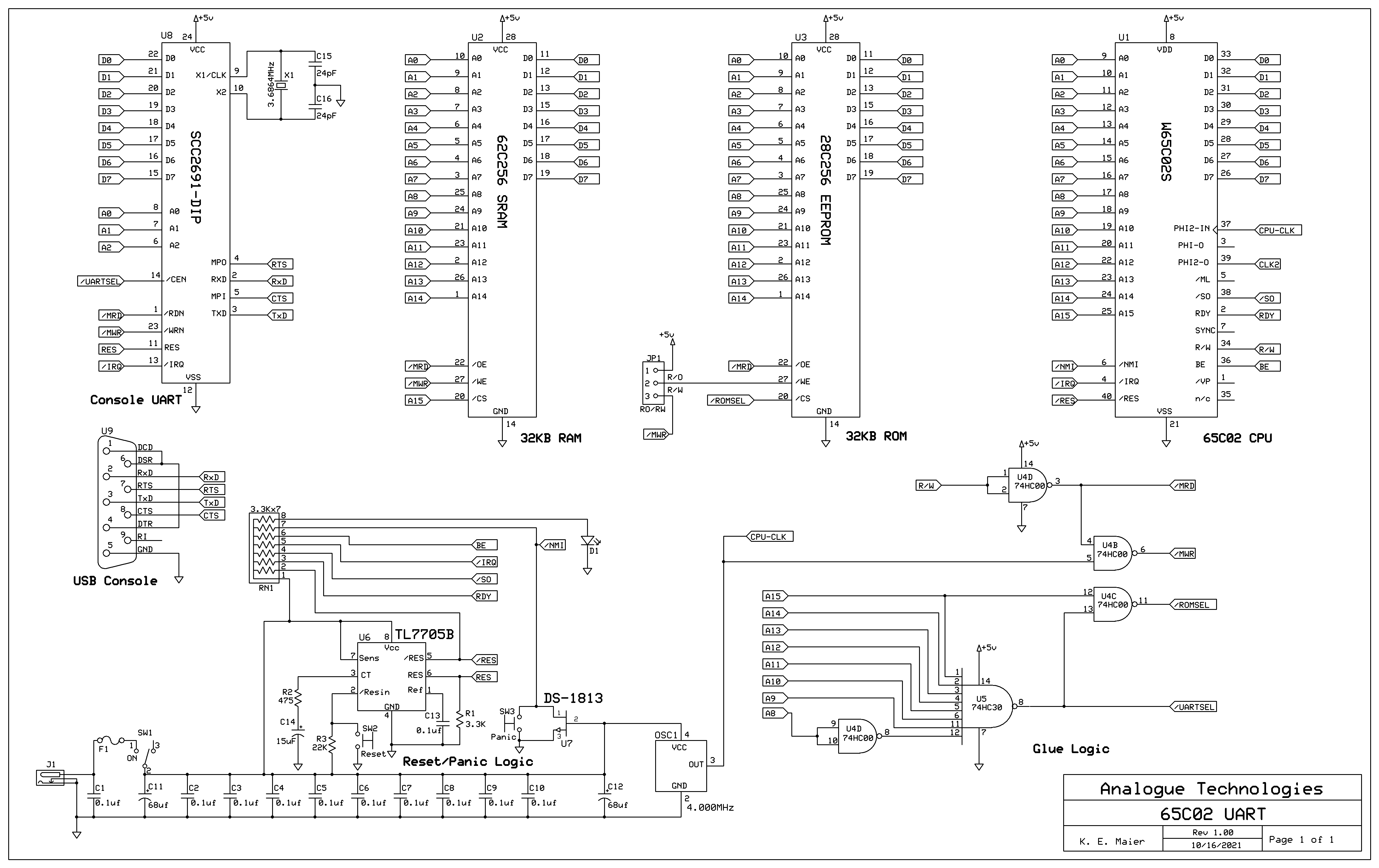

sburrow wrote:
Attached is a newer schematic. I was talking to BDD and he suggested starting with UART only first, and then work my way up.
I was using his schematic for his DUART alongside the datasheets and other things.
My memory map changed a tiny bit, it's now full 32K RAM, I moved the I/O addresses to overlap the ROM a bit now. The '688 makes it easy to do this though.
No 6522 VIA if you can see. Not that I do not plan on including it. This is just supposed to do ONE thing: terminal with Linux. From here, I will add on.
Thoughts?
Thank you all for your time and help on this!
Chad
A better plan, IMHO. Some things to think about:
1- No need to use a can oscillator for the UART. I've always used a simple crystal and a pair of 24pF caps attached directly to the X1/X2 pins (SCC2691 and SC28L92).
2- That's a pretty busy set of chips for glue logic. It can be simplified... Look here: https://sbc.rictor.org/sch2.html - 7400, 7430, 74138.
3- Consider the TI TL7705 Reset chip. A few more components to implement it, but you get both reset signals (active low and high) and can configure the delay time.
4- Using a MAX232 for voltage level conversion.. and having the same to attach to your computer seems like a lots of parts for no gain. Consider a FTDI USB-UART interface, much simpler.
5- Bypass caps... no such thing as too many (within reason). Also, 2-3 larger filter caps is a plus (I use a trio of 68uF caps on my Pocket SBC).
6- Add a LED indicator for power... just use one of the spare resistors in the resistor network to drive it.
7- Consider adding a polyfuse for safety, in case you accidentally short something... helps to keep the smoke inside the parts!
8- A power switch!
As you're using all DIP parts, you can start on a solderless breadboard and get things working. You'll also need a way to program the EPROM.
EDIT: no reason to use a toggle switch on the reset, just a momentary button switch (same for NMI).

Wow, awesome list! Thank you floobydust, or KM. I'm going to go line by line:
1) I suppose that makes sense. Is using a crystal instead of a can better because of space or power concerns?
2) Yes, I needed ONE too many NAND's... If I check out that TL7705 like you said, I can probably reduce that by one chip. Also, my 74'688 *basically* does the same as the 74'30, in effect. The 74'154 is a bigger version of the 74'138, but I had the spare addresses so I figured "why not?"
3) Neat! Good idea, that would save some glue logic too.
4) My USB-UART adapter is coming in the mail actually! BDD was suggesting to go with straight TIA-232, and I'd get a PCI card for my Linux box to help. I have not discarded the USB idea. Thank you.
5) I've seen like 10 of the things put together in a network. Haha! Ok, if you say so.
6) Yes, that's a good idea, and semi-parallel's Garth's debugging concerns.
7) I just learned what a polyfuse is, and yes that makes sense. I have been thinking of using a 5.1V zener diode near the power supply, would that do any good?
8 ) What's wrong with just powering on from plugging it in? i.e. the ZX80. Yes, of course, that is a good idea, thank you!
9) So my thoughts on the reset switch is that I can just keep it on reset while I, well, do whatever I want. If it's a button I have to hold it down, but a switch I can walk away for a minute and make a sandwich. Any particular reason I shouldn't make sandwiches?
The breadboard is in my future for sure. I have one, and will get a second one. Already have been testing a few chips together here and there with it.
As far as the EEPROM, I was thinking of using my Raspberry Pi GPIO pins, some basic Python, and a spare 12V power supply. If I was reading the datasheet correctly (on the EEPROMs), I apply 12V to the VCC (specifically to erase), and then go about my business writing with TTL levels. Maybe I didn't read that correctly? I also believe it's different from EPROM where I have to apply 12V somewhere else, thus not as easy? Confirm with me on this if you can, I'd like to not spend a ton more money on an EPROM programmer if I can.
Thank you again KM, this is excellent advice!

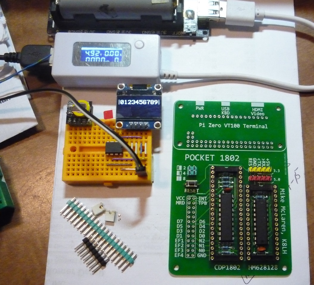

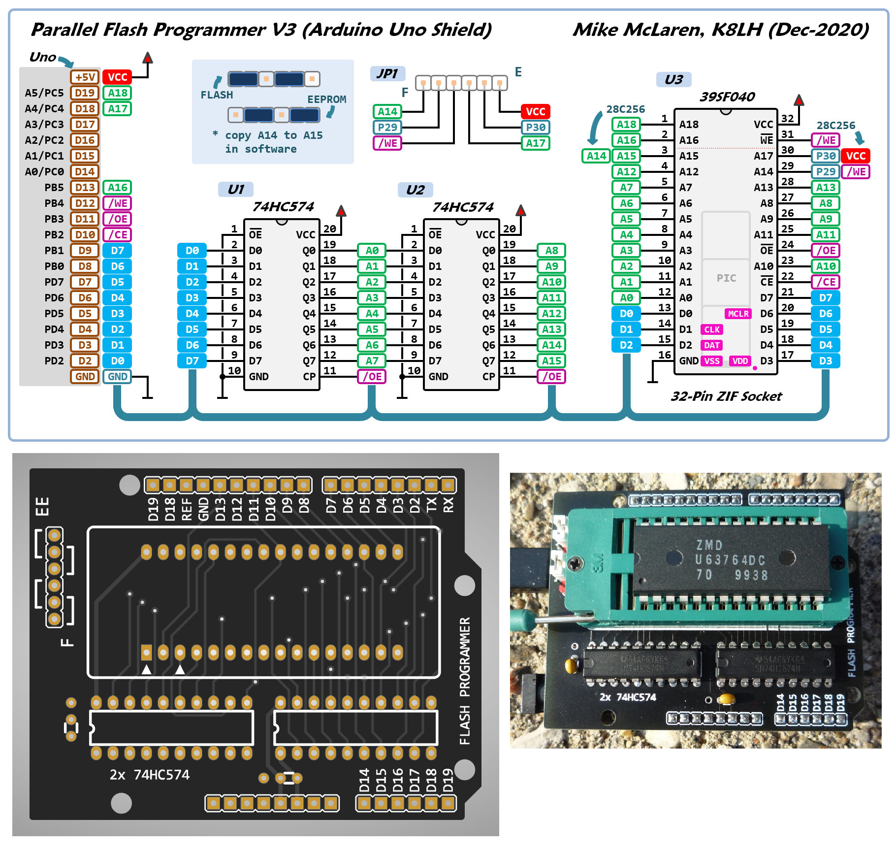

Chad (and gang):
I'm a proponent for using Flash ROMs instead of EEPROMs. The 128K 39SF010A in DIP-32 package is $1.52 at Mouser while a new 32K AT28C256 (DIP-28) costs more than $11. Both types are relatively easy to program. I use an Arduino Uno R3 and a DIY programming shield to program the SST 39SF series Flash ROMs as well as 28C256 EEPROMs (see below).
I would also recommend using 64K or 128K RAM chips in new designs. The extra active high chip enable pin often comes in handy. I'm necessarily frugal and have paid as little as 52¢ a piece (including shipping) for a handful of skinny W24512AK-15 chips and as much as 75¢ a piece (including shipping) for wide HM628128ALP-70 chips from Chinese vendors these last few years. Prices for new 32K or 128K RAM chips are very close (32K AS6C62256 $4.03, 128K AS6C1008 $3.91 @ Mouser, not including shipping).
Squeezing a design to fit on a 4"x4" PCB can be a challenge. Placing smaller chips beneath larger chips in the open space inside a machined pin socket may be an option (see below).
Good luck on your project.
Cheerful regards, Mike, K8LH

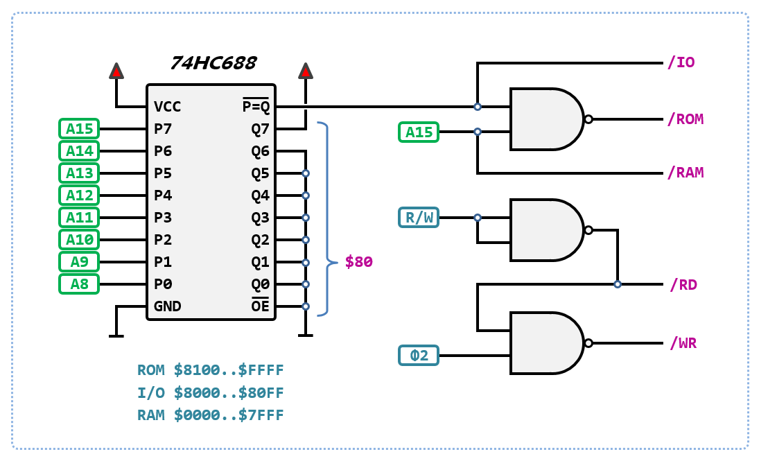

Is your decoder logic correct? Don't you want an active low ROM select when both A15 and P=Q are high? If so you can free up the gate that you're using to invert the P=Q signal and use that gate instead for the positive reset gate...

4) I went back to the datasheet. There is an OPTIONAL erase mode using 12V, but other than that, yes, just regular TTL will work.
As far as getting a programmer, and knowing if I have the right data on there or not, good point. Things on my Christmas list: analog oscillator and EPROM programmer.
Thank you for the corrections!

Lastly, for the smaller post about the logic:
P=Q comes out low when they are equal, low enable for I/O space. I invert that to make it high temporarily. Then I NAND it with the A15 which is also high at that point. High NAND High = Low. That runs into the ROM. So yes you are correct, when they are both high I want it low. The only problem was that P=Q comes out low.
EDIT: I went back and rethought my logic some. For ROM I need A15 high and I/O enable high (as in, not enabled). Ok, I think that's right? Thank you again.

I guess I have more time on Saturday mornings. It's actually kind of cold here in Texas today!
Anyways. Attached is the PDF of some updates.
Big changes:
1) I changed the 28C256 EEPROM to the 39SF010 Flash ROM, with bank switching onboard.
2) Added power switch, changed reset to button, kept the DS1813's, added power LED, replace extra can with a crystal.
3) Put in single-cycle feature with a SPDT button, using some left over NAND's to debounce.
4) LED's on data bus and a beeper at $80FF (Idk if I put it in correctly, it's a first for me.)
5) Theoretical replacement areas if using FT232 or FT245 USB boards.
Thank you all so much for your help on this. So much learning going on here! I love it!
Chad

The /RAM, /ROM, /IO select logic still doesn't look right. Shouldn't it be something like this?

Michael, I am *sure* that's my ROM select arrangement. Surely that's what I was thinking in my mind at least. You are definitely correct on that diagram.

I agree with Plasmo, you're making progress... but it's all a learning curve. Everyone will make some suggestions, that doesn't mean you need to implement every one. I still think keeping simple is the right way to go... one I/O device (UART) and that can keep you busy getting it to work.
I'll offer this schematic. It's a very simple circuit, based on my C02 Pocket SBC, sans the PLD, expansion connector and some other caps, etc. not needed. There's one I/O select driving the UART.
Just follow the overall design piece by piece, hopefully it's logical to you. The I/O select is at $FE00, and is 256 bytes wide, with 32KB RAM from $0000-$7FFF and EEPROM from $8000-$FFFF (sans $FE00-$FEFF). All of the caps are grouped together, basically a 0.1uF for every device, along with a couple larger filter caps.
You don't have to build it, but at least it's a simple system that will work. Have fun ;-)
