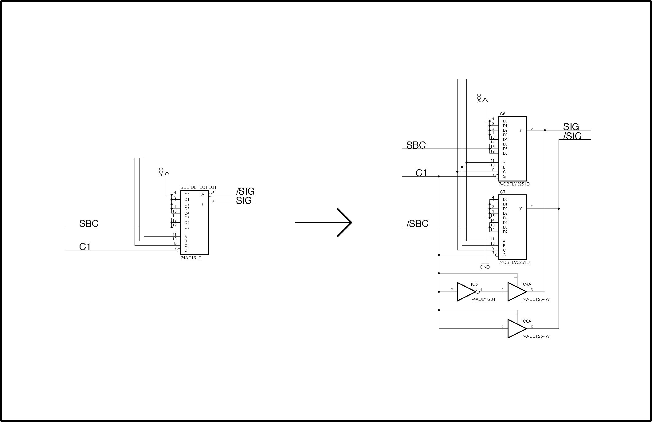

Hi Drass, It gets confusing that you use different ic references in the schematic and the description, (some do not even match in pin layout or function, but I assume that particular one must be a typo). In at least one case you exchanged analog switch type circuits, where disabled outputs become high impedance, by chips with low disabled outputs, which act very differently. You also refer to 16 bit versions of registers in the description, but there's only 8 bits on the schematic. Please, can you comment on this?
Re: 100MHz TTL 6502: Here we go!
Posted: Mon Oct 19, 2020 11:26 am
by Drass
Apologies Joan. It looks like I included my back-of-the-napkin tpd in that post rather too hastily. There is a lot of shorthand there!
Let me explain:
This schematic is more of a sketch as to how we might solve the problem, rather than a fully worked out spec. We have not decided yet which IC families to use for which compoenets, as there are tradeoffs to consider for each situation. For example, 74AVC16374 registers are faster than 74AUC16374s, but they also impose more capacitance on their inputs — not to mention the supply voltage differences. We might choose one or the other in the final design, or even use each for different aspects of the design. In the meantime, I just used AC chips as place holders. For example, I used 74AC574s as registers where in fact a pair of these might be implemented with a single 74AUC16374 in the final design. I used the 74AUC16374 figures for the back-of-the-napkin tpd because it’s the slower of the two alternatives we are considering.
Regarding the 74AC151, yes, it’s a powerhouse of an IC. Sadly, it’s not available in any of the logic families we are considering. I’ve yet to find a good replacement, so I went ahead and used the figures from a 74CBTLV3251 since the switch-time is what counts for the critical path. I’m working on the assumption that we will either find a good replacement IC for the final design, or that we might have to go with a “not so good” replacement otherwise.
This not-so-good replacement might require additional ICs, but can be functionally equivalent. For example, the inverted output of the ‘151 might have to be implemented with a 74AUC1G04. Or (if the additional delay associated with the inverter is unacceptable) we might go with two 74CBTLV3251s, and have one with the data inputs inverted. You are also right to point out that the enable input (/G) works differently on a 74AC151 than it does on a 74CBTLV3251. They are equivalent when the /G input is driven low, but when driven high, the CBTLV tristates its outputs, whereas a 74AC151 takes its inverted output high and its non-inverted output low. This behaviour can be emulated with a pair of 74AUC126s and in inverter.
The not-so-good equivalent circuit would then look something like this:(Not sure why the image below is not displaying as a thumbnail as usual :()
It’s not great, but the critical path is still the Sel-to-Y tpd of the 74CBTLV3251. I simply omitted all this detail in my back-of-the-napkin tpd. :roll:
Drass
P.S. Thanks for catching the typo. Yes, that’s supposed to be a 74CBTLV3257. I fixed it now.
P.P.S If someone has any ideas about how best to replace a 74AC151 using AUC, AVC, LVC, or CBTLV logic ICs I would be very appreciative!

Hi Drass,
Thanks for the clarification.
Your replacement of the 74AC151 by 74CBT3251 is interesting. I think that you should be able to replace the inputs of the 74AUC126s by just connections to +Vcc and GND. That would reduce some capacitance on the C1 line, and would also remove the inverter gate on one of them.

Good thought Joan. Thanks for mentioning it. All suggestions welcome! :)

Posted: Tue Oct 20, 2020 6:07 am
by ttlworks
Did a search, but faster 8:1 multiplexers (with a true push_pull output) than the 74AC151 are not available.
Another option would be to make creative use of 74AUC2G53 SPDT FET switches:
