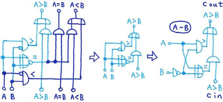

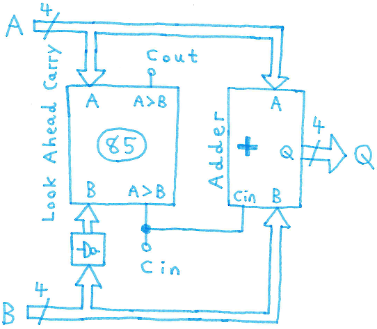

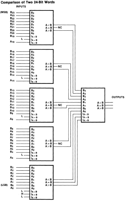

While flipping through the pages of the 1985 Fairchild 74F data book at Bitsavers,
the picture on page 4-29 (page 74 of the PDF) about cascading 74F85 magnitude comparators had caught my attention:
It somehow reminded me to cascading 74182 carry lookahead chips:
7485 is optimized for speed, so it isn't obvious from the gate level schematic in the 7485 datasheet,
but when drawing a (slower) Bit_sliced version of a magnitude comparator, I'm getting something like this for a single Bit:
The light_blue marked part is the logic which detects A>B, and when re_drawing that part a few times,
it appears to be just subtractor circuitry calculating A-B by inverting B (similar to how SBC works in the 6502 ALU).
So when we have a 4 Bit adder, and we want to build a 4 Bit carry lookahead circuitry for the adder carry output,
in theory we could just take a 7485 magnitude comparator and invert the comparator B input:

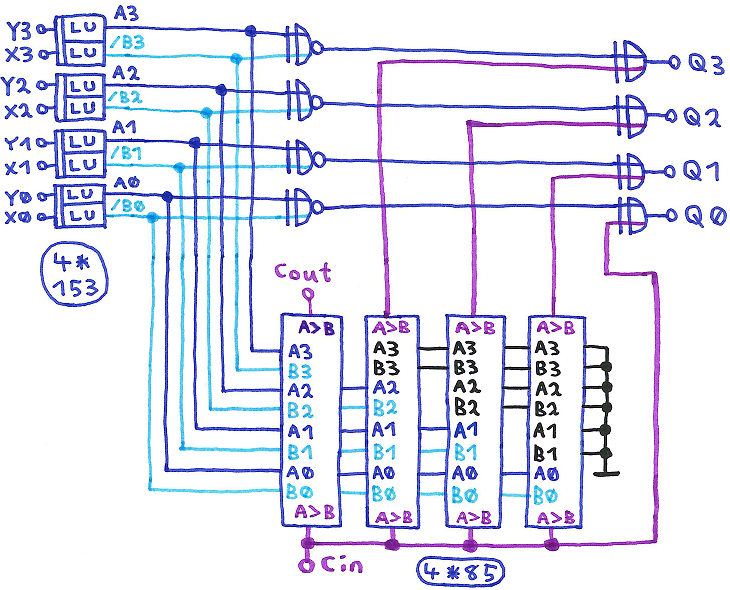

Now for a (hypothetical) 4 Bit ALU, with a 7485 based carry chain:
The boxes labeled "LU" are logic units based on 74153 4:1 multiplexers.

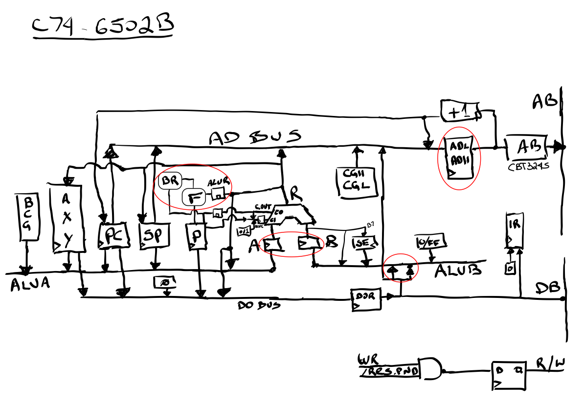

I thought I would share the (very rough) block diagram I’m working with for the new design.
Some optimizations to note:
  • The ALU inputs are registered (ALUA, ALUB and ALUC). They are pre-loaded in the cycle prior to the ALU operation.
  • The transparent latch (ALUR) at the output of the ALU, prior to the Flags logic, allows the BRanch test logic and writes to the P register to be executed in the cycle following the ALU operation (WriteFlags pipeline stage).
  • Inverting and non-inverting buffers work in parallel to connect the Data Bus to the ALUB input. A byte read from memory can therefore be inverted in the cycle prior to an SBC operation at no extra cost, thereby eliminating the need for inverters in the ALU itself.
  • ADL/ADH and R/W are registered as well, and are also pre-loaded in the cycle prior to their use.
As with the prior version, microcode is prefetched. The new Decode logic (not shown) enables the CPU to pre-load input registers, and otherwise get a jump on control logic (by decoding the Opcode on the fly). The ALU Execute cycle is made shorter by pre-inverting the B input as necessary. The ALU itself is much faster through the use of a FET Switch Adder. And finally, the WriteFlags pipeline stage takes care of all post-ALU processing.
Taken together, these improvements should make for lots of parallel processing and a much shorter critical path. We’ll have to see whether the concept holds up. :)

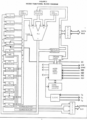

74377 is an exotic chip.
It's worth a thought if we could pick up an old idea from Jeff: building registers from 74163 4 Bit counter chips instead of using the 74377.
Hey, maybe we even could toss that 74283 based 16 Bit incrementer out of the design.
Would suggest to take a look at the 65CE02 block diagram:

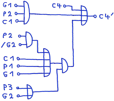

The BCD circuitry in our old TTL CPU design appears to be a bottleneck when trying to go faster than 20MHz.
There is an old article about BCD correction in the NMOS 6502, the interesting part starts here.
Our old TTL CPU design uses 74283 adders for BCD correction.
74283 isn't too fast.
NMOS 6502 does the correction without resorting to an adder:

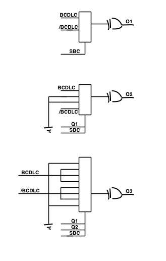

Edit: cor+ and cor- in the picture above might be generated this way:

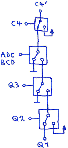

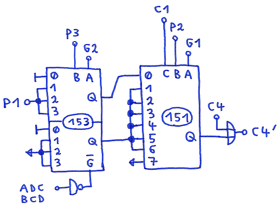

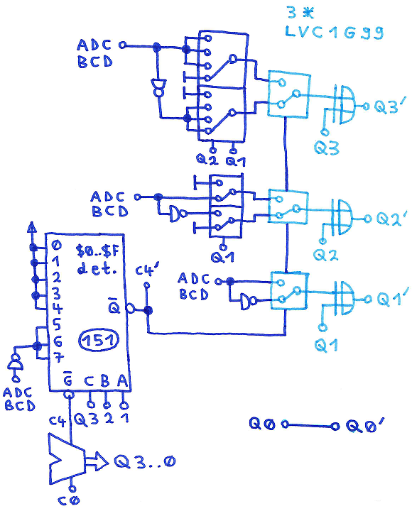

Now to make creative use of the 74LVC1G99 (which happens to have an output enable) for building a BCD correction:
Q0 doesn't need to be corrected.
C4 is the ALU carry output, C4' is the carry output after the $A..$F detection.
That 74151 gated with the ALU carry output just detects $A..$F at the ALU output during decimal ADC, nothing fancy there.
Works like this:
Since the 74AC151 worst case timing is agonizingly slow, another approach for detecting $A..$F at the ALU output would be making creative use of fast FET switches
(that sort of switches we would like to use for implementing the carry chain inside the ALU):

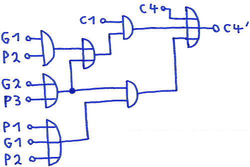

Of course, detecting $A..$F at the ALU output isn't the end of the ladder,
NMOS 6502 makes creative use of the propagate\generate signals inside the ALU instead.
An oversimplified and not 100% technically exact picture of how the NMOS 6502 does it:
//The red box _could_ be a part of the carry chain, but in the NMOS 6502 chip layout, it isn't.
After omitting the BCD_ADD (ADC BCD) signal for better reliability, I'm getting this:
When tinkering a bit with an old test program, I'm getting an alternative approach:
ttlworks

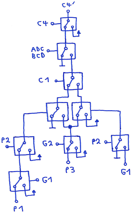

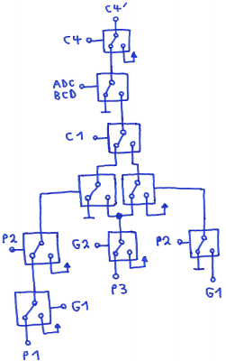

And when tinkering with the alternative form of the $A..$F detection,
an implementation of it by resorting to FET switches would look like this:
And an implementation resorting to multiplexers would look like that:

This is really great Dieter! I’ll take a closer look at the [$A..F] Detect circuits.
I made a few mods to the BCD Adjust circuit above. The propagation delay is reduced significantly if we use FET Multiplexers for the adjust logic, as follows:
In this diagram, BCDLC and /BCDLC are the positive and negative outputs of the [$A..$F] Detect ‘151. They are connected to the Data Inputs of the subsequent FET Muxes. The Select Inputs take much longer to resolve, and use only signals which are available already by the time BCDLC arrives. The switching time of the MUXes is therefore taken out of the critical path. :D
I managed to test the adjust circuits in Logisim, and they both check out — good news.
