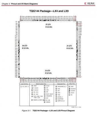

I thought I might back up a few steps and share a little bit how I came to 98 I/O pins that are free to use without contention. I modified Fig. 3.1 of UG385 Pg. 274, in order to show how some of the "multi-function" pins actually must be tied to a logic level for my case without an external CPU controlling pins. Most of the pins are the ones dedicated to the FPGA PROM.
Understanding UG385 is critical to success. I checked this data against past designs, especially the PVB project. The only discrepancy I found was VCCAUX in that project was 2.5V, not 3.3V. It shouldn't be too difficult to swap out a 2.5V to 3.3V VREG once the board is complete just in case.... I know what I did back then: I looked at multiple design schematics which were available online, from Digilent etc., and considered if my design was similar enough to use the settings they used.
EDIT: I found it! VCCAUX must be 2.5V if VCCO is 1.8V according to UG380, Pg.43 Note 16.

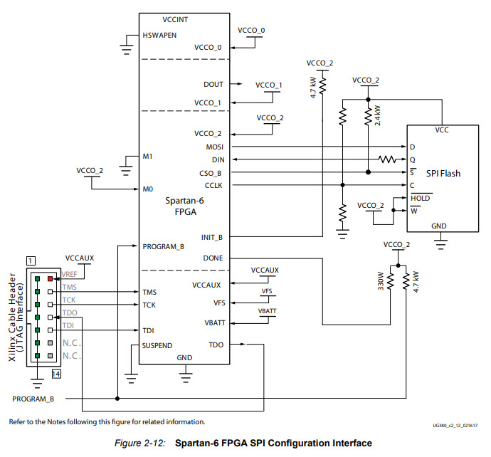

I'm working on Configuring both of the FPGA's so I'm reading alot of UG380. I think I've found a solution to those expensive XCF04 'PROMs' by using the SPI Config interface. If I understand the datasheet correctly, ISE goes about programming the SPI FLASH 'indirectly', i.e. it programs the FPGA and then the FPGA programs the data to the FLASH. Whereas, when I've used the Xilinx XCF PROMs in the past, ISE would see the FPGA and the PROM and you could program either one.

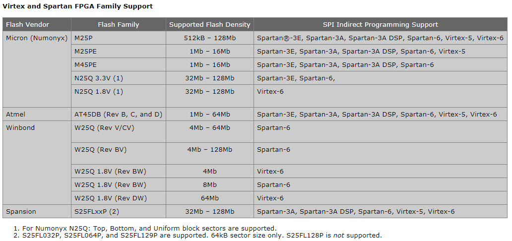

Now which flash to choose. According to this link Xilinx has just a couple recommendations when VCCO is 1.8V, like in my case. I have to use an 8Mb device, when the Spartan 6 LX9 only takes 2.7Mb. I'm all new to this but I don't think the 1 FLASH can program both FPGAs? I have to do more research...

I think that, with the advent of the multi-boot programming feature, using commodity SPI Flash devices, daisy-chain programming of a chain of FPGAs from one SPI Flash on the lead FPGA is probably out. One thing to keep in mind, the Xilinx tools load an SPI Flash programmer into the FPGA connected to an SPI Flash device. That programmer is generally very persnickety about the manufacturer's ID and device type. Since you will not likely want to write your own SPI Flash device programmer application to download into the FPGA using JTAG, then I recommend that you stick to the devices that Xilinx recommends regardless of any particular biases you may have for one Flash manufacturer or another, or one size versus another. If Xilinx does not list the device you select, then there is a very high probability that their programmer will not program the device.

I thought the daisy chain feature might not work using 1 SPI FLASH. I guess we're lucky just to even have the Spartan 6 around for so long. The support has died... So I'll try a reasonable method of MUXing 2 FPGAs with their individual SPI FLASHs to the JTAG IF.
I did very carefully choose the SPI FLASH IC according the the link I posted above. I found it interesting that the Virtex device could use a 4Mb SPI FLASH, but the Spartan6 couldn't. Xilinx recommends the 8Mb SPI FLASH for the Spartan 6 @1.8V VCCO. So that's the SPI FLASH I chose.
Here's a pic:

If you chose to use Slave or Master Serial for your lead FPGA, then the support for programming a chain of FPGAs using this mode from one is still available. The problem with the SPI Flash as the programming source lies in the fact that the FPGA has to transmit a read command, a 24-32 bit starting address, and then a stream of values to the device in order to have the device output its contents. This is unlike the Master/Slave serial modes supported by the XCF0x parts which produce/consume CCLK, respectively, as the only control signal following reset.
I get the impression that Xilinx, as well as the other FPGA vendors, are rapidly increasing the size of their devices faster than they can get compatible Flash devices developed in-house. Their design resources are better spent on the FPGAs instead of continuing to design new generations of Flash programming devices. Commercial demand for Flash devices of ever increasing capacities is rapidly driving the cost of these devices into a price range that the FPGA vendors cannot match. Instead, Xilinx is taking advantage of the decreasing price of the SPI Flash devices to reduce their specific costs and those of their customers.

Thanks so much for your in-depth explanation. For highest chance of initial success, would you recommend a JTAG daisy chain of FPGA using Xilinx XCF series PROMs? They are expensive, but even more offensive is their large footprint for such a basic function but I'm willing to do what's necessary for an early successful programming. Thanks!

I think that you should use SPI Flash devices on each of your FPGAs, and hook your FPGAs in a standard JTAG daisy-chain. I haven't priced the minimum-sized devices needed for your Spartan 6 LX9 FPGAs, but I would predict that the cost of two SPI Flash devices is less than one XCFxx device that is large enough to program two LX9s. I've been switching all of my projects to use SPI Flash devices instead of the XCFxx devices. They are cheaper and have more sources of supply; that's the primary driving factor for me switching the SPI Flash interface.
The chance of initial success is pretty high with the SPI Flash devices. I've not had any trouble getting success on the first try with them when I use a device listed by Xilinx. On ocassion I've had to use a device not listed, and I've been able to coerce the Xilinx tools to support it by making sure that the device I used had the same (programming) organization as one of the recommended devices. I don't recommend this option as it is hit or miss. If you stick with the devices in the table you inserted in your post above, I don't think there will be any risk to your project's initial success: just make sure that you have set the programming interface options correctly as indicated in the Spartan 6 configuration guide.
