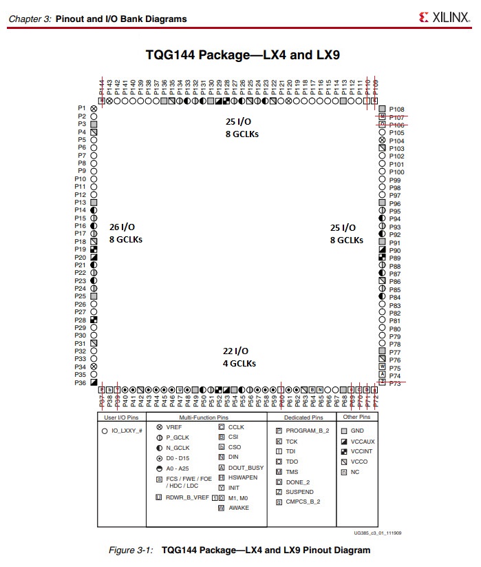

I thought I might back up a few steps and share a little bit how I came to 98 I/O pins that are free to use without contention. I modified Fig. 3.1 of UG385 Pg. 274, in order to show how some of the "multi-function" pins actually must be tied to a logic level for my case without an external CPU controlling pins. Most of the pins are the ones dedicated to the FPGA PROM.
Understanding UG385 is critical to success. I checked this data against past designs, especially the PVB project. The only discrepancy I found was VCCAUX in that project was 2.5V, not 3.3V. It shouldn't be too difficult to swap out a 2.5V to 3.3V VREG once the board is complete just in case.... I know what I did back then: I looked at multiple design schematics which were available online, from Digilent etc., and considered if my design was similar enough to use the settings they used.
EDIT: I found it! VCCAUX must be 2.5V if VCCO is 1.8V according to UG380, Pg.43 Note 16.
