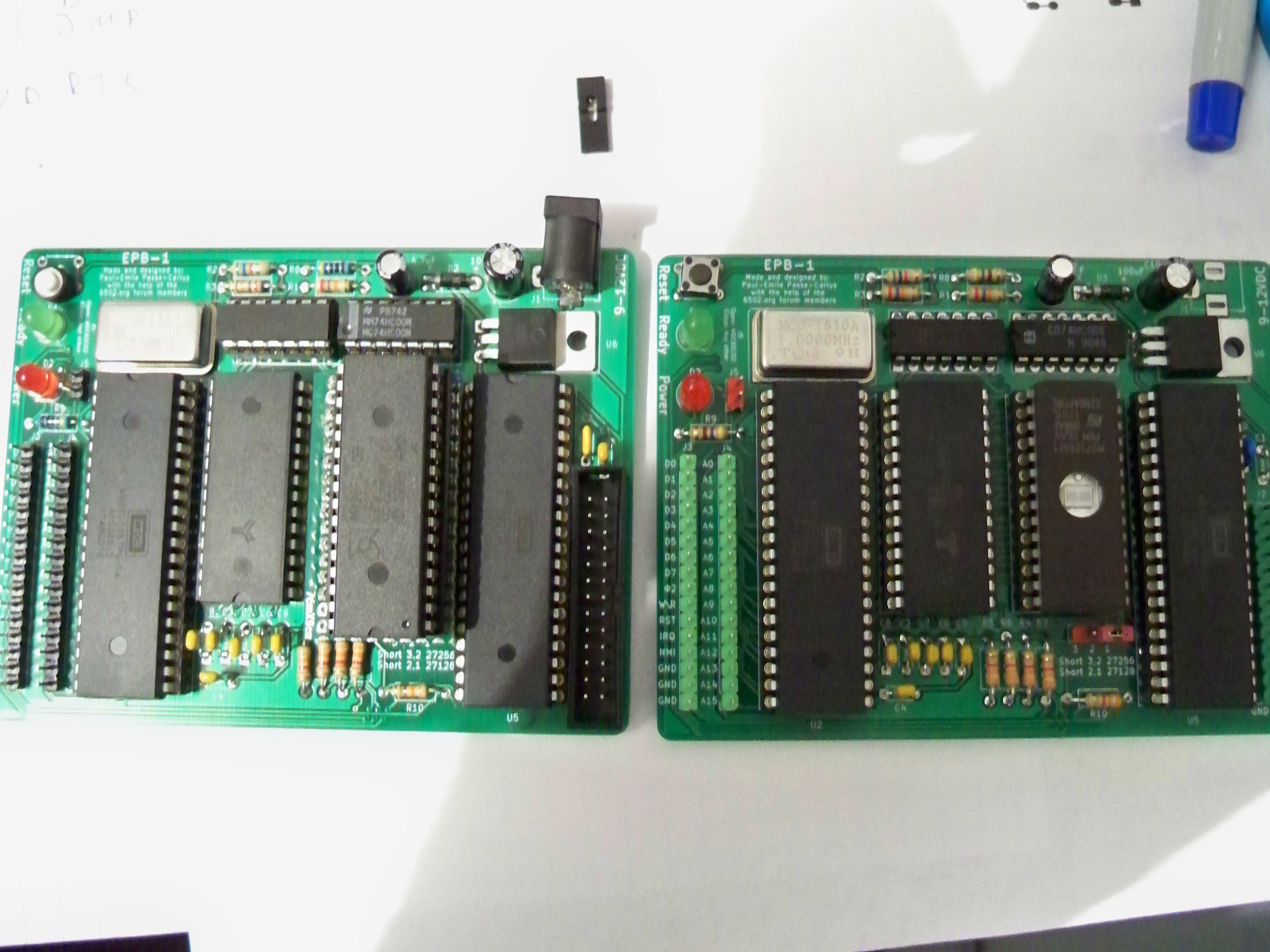

I got tired of burning endless amounts of EPROMs. I also wanted a way of testing my programs without having to carry 10EPROMs + UV eraser. I thought about EEPROMs, but they are expensive. I do have a few 29F010 flash chips. I made an adapter and now it simplifies programming a lot!
I also took the time to build a second board that fixed the issues the first one had (there is a bodge of wires under it, but it's hidden).
-Floopy
When Daryl designed his SBC-2 board, he put in jumpers to allow either an EPROM or an EEPROM to be used. I had always used UV EPROMs but I tried an EEPROM for the first time when I built the SBC-2. I remember thinking how great it was to not need the UV erase step.
At this point, I've been doing all development on an EPROM emulator for years. Not having to unplug anything is even more convenient; almost like programming a modern microcontroller. Now I only burn real chips every once in a while. I usually use UV EPROMs since I still have a bunch of them.
Your board looks good. That's a nice nod to the forum members in the silkscreen!
