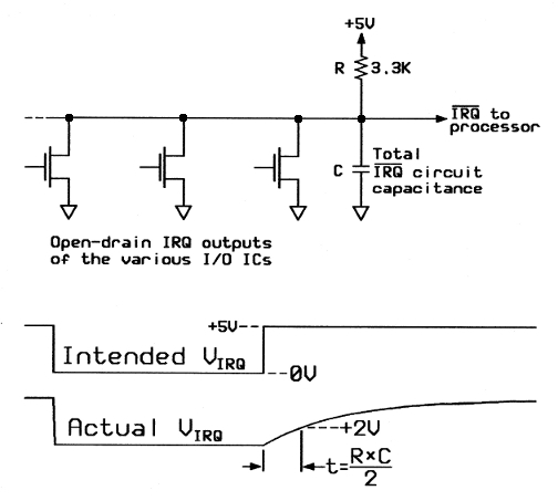

When using I/O ICs that have a wire-OR IRQ\ output, typically a 3.3K resistor is recommended for the pull-up to Vcc. But with only this passive pull-up instead of an active one, the rising edge is quite slow when you clear the interrupt bit in the I/O chip, as illustrated below. Your interrupt-service routine (ISR) should clear the bit early to make sure the IRQ\ line is up by the time the ISR is finished and the μP allows interrupts again. Otherwise you'll get a false interrupt signal.

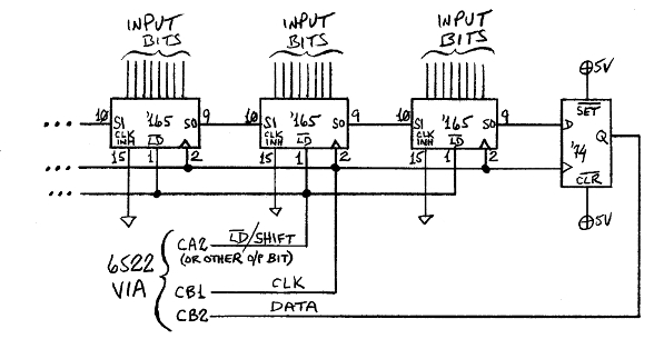

Similar to tip #4, you can use the 6522's SR for inputting hundreds of bits as well, typically using mode 001 or 010 and a daisy chain of something like the 74HC165 or '597. For input at a different voltage, you can use the LM339 comparator between a chain of 4021's and the 6522. Again, hundreds or even thousands of bits can be interfaced to a single 6522 this way.
For more description, see the section of the potpourri page of my 6502 primer where you see the same diagram as above.
There is a bug in all brands of 6522 in mode 011 however. See my next tip.

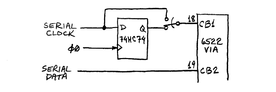

The 6522 has a bug in mode 011, shifting synchronous serial data in under control of external CB1 clock.  All brands have this bug.  If the edge on CB1 falls within a few nanoseconds of the falling edge of phase 2, the CB1 edge will be ignored, so you lose a bit.  Worse, you'll get framing errors on subsequent data.  To get around it, put the external clock signal into the D input of a 74HC74 flip-flop, run the flip-flop's Q output to the 6522's CB1 pin, and clock the flip-flop with phase 0 or phase 2.  I have used this to send data from one 6502 computer to another using CA2 for an extra handshake line.

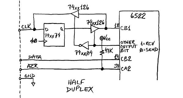

The SPDT switch in the diagram is for direction (up for CB1=output and down for it being an input), and could of course be replaced with 74-family parts to control the switching with software, something like the following which comes from my SS22 interface article:

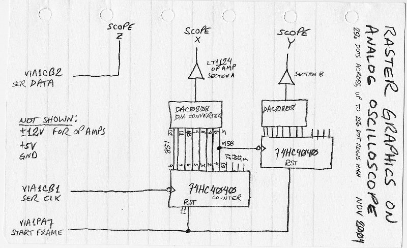

Tip of the day, #12 (duplicate-- How did that happen? So I'll replace it with Tip 12-A, bringing it in from here)

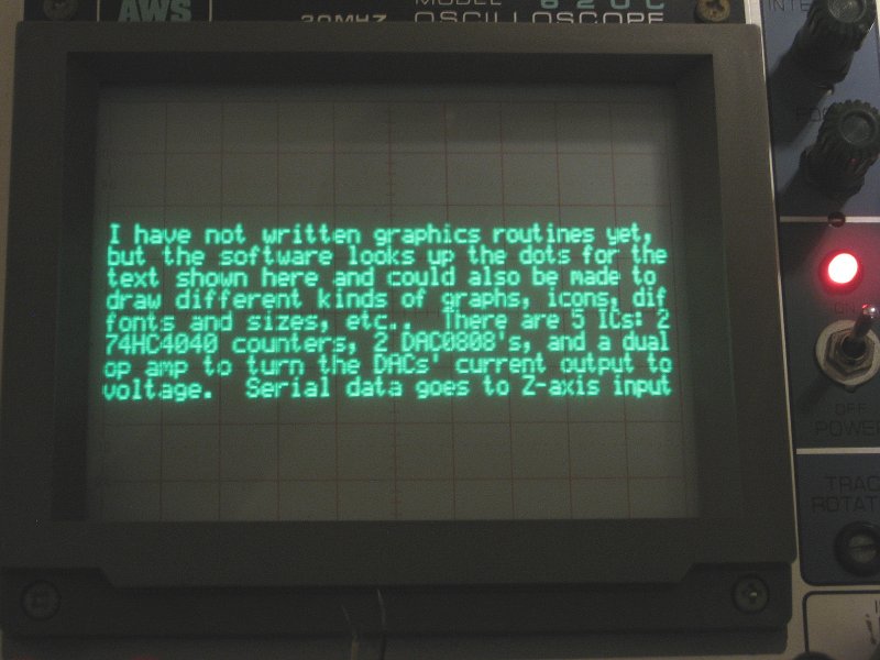

Tip of the Day, #12-A For simple raster graphics using an analog oscilloscope in X-Y mode, you can built a circuit whose counter ICs are fed from the clock line of a 6522's synchronous-serial port, whose data line goes to the Z-axis input. Here's a photo:
Here's a simplified schematic of it (just omitting some resistors and capacitors):
It just takes three pins of the 6522: two for the serial interface and one to reset the frame to start. As you can see, you could make any character you want, any font, and monochrome binary graphics. The 6522 takes constant babysitting though, so to keep the display going while your processor does something else, one way would be to make a separate, very simple computer to take the data and buffer it and run the display.
I should probably interlace it to cut the perceived flicker when scanning a lot of rows at a rate that everything can handle. (The Z-axis input of this scope was not able to handle the data as quickly as the computer could send it out.) It would requiring switching a couple of wires and changing the software. The down side would be that the frame height in number of lines can't change on the fly. I'd have to put in a DIP switch.
