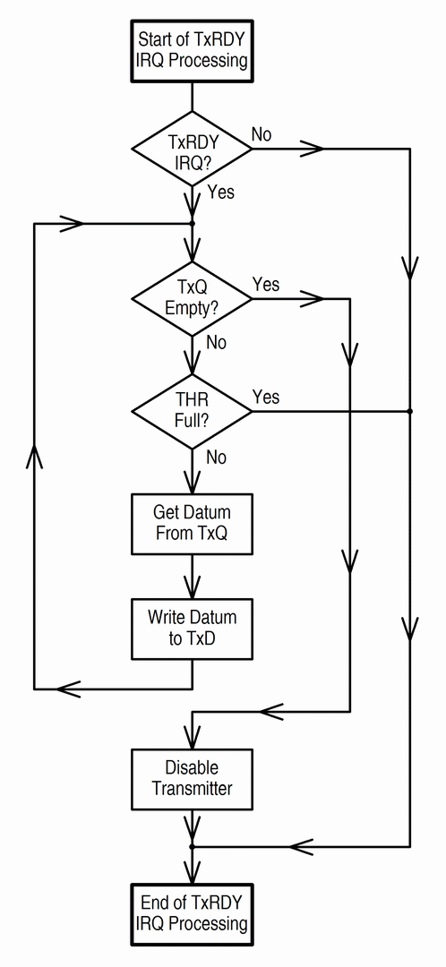

As for driving the transmitter, whether by PIO or IRQs, the basic algorithm is the same, which is to keep stuffing datums into the THR (transmitter holding register, aka FIFO) until the channel status says THR is full. Bit 2 (TxRDY) of the channel's status register (SR) will be cleared when THR is full and will be set as soon as a datum has been serialized and completely shifted out. As the MPU can write datums into THR many times faster than the UART can process them, transmission from the MPU's perspective is handled in very short bursts of activity, followed by long periods of inactivity.
Bit 3 (TxEMT) of SR will be set when THR has been emptied and will be cleared as soon as a datum is written to THR. In a PIO setup, as you are running, you can safely ignore TxEMT and only pay attention to TxRDY. Monitoring the status of TxEMT becomes important if using IRQs, as the setting of TxEMT would cause the UART to interrupt the MPU.

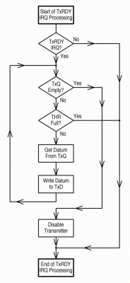

Further down is a flow chart I developed that illustrates a transmission processing interrupt service routine (ISR). In the flow chart, TxD is an abstraction of the UART's transmitter (the MPU only knows about a transmit register, not the internal details of the transmitter itself), and THR is as previously described.

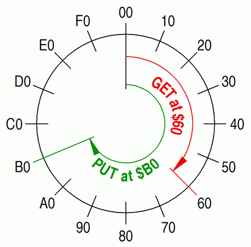

TxQ, which I briefly mentioned above as a circular queue, bears some explanation (also, see Garth's website page on which he explains RS-232 reception using a circular queue—it works on the same principle as transmission). The serial I/O (SIO) primitives consist of foreground and background code subsections. "Background" refers to the DUART's ISR and "foreground" refers to code that acts as an interface between user programs and the SIO driver itself. Only the foreground is accessible to the user.
When a user program wants to transmit, it loads a datum into the accumulator and calls the transmit foreground function:
         lda #datum            ;datum to transmit
         jsr putcha            ;send it out on channel A
The above is for POC V1 and V1.1. In POC V2, a software interrupt is used instead of a subroutine call:
         clc                   ;block until datum is accepted
         cop _putsioa          ;transmit on channel A
Within the foreground, the datum will be stored in TxQ, the circular queue, which is illustrated below.
256 Byte Circular Queue
Following the queuing of the datum, the transmitter will be checked to see if it is running. If the transmitter is not running it will be enabled, which will cause an immediate TxEMT interrupt, and background processing will commence. If the transmitter is already running background processing will likewise be running. Note that the foreground's interaction with the UART is limited to enabling the transmitter if it has been disabled—the foreground does not otherwise "touch" hardware.
The background will respond to TxEMT IRQs by checking the state of THR (i.e., testing the TxRDY bit in SR, indicating full or not full) and if not full, reading the oldest datum from TxQ and writing it to TxD. This process will repeat until THR has been filled or TxQ has been emptied. If THR has been filled the read-write loop in the ISR will terminate and will not be run again until another TxEMT IRQ occurs. If TxQ has been emptied the transmitter will be shut down, which will prevent the MPU from being hammered with TxEMT IRQs that it won't be able to service; a flag will be set somewhere so the foreground will know the transmitter has been disabled.
TxD Interrupt Service Routine Flowchart
Use of IRQs to drive I/O hardware tends to be considerably more efficient than PIO, as the MPU doesn't constantly get stalled waiting on the UART. It can be said an IRQ driver reconciles the processing speed of the MPU (very fast) with the processing speed of the UART (not so fast). This especially becomes the case when the serial interface is running at a high speed, in which case flow control will likely in use. In such a scenario, serial I/O will frequently block until the receiving device can catch up. If transmission is via PIO, the MPU will be busy-waited each time the receiving device tells the transmitter to stop. In contrast, the UART would not tie up the MPU in an IRQ handler, since the UART wouldn't be interrupting if it couldn't accept more data for transmission.

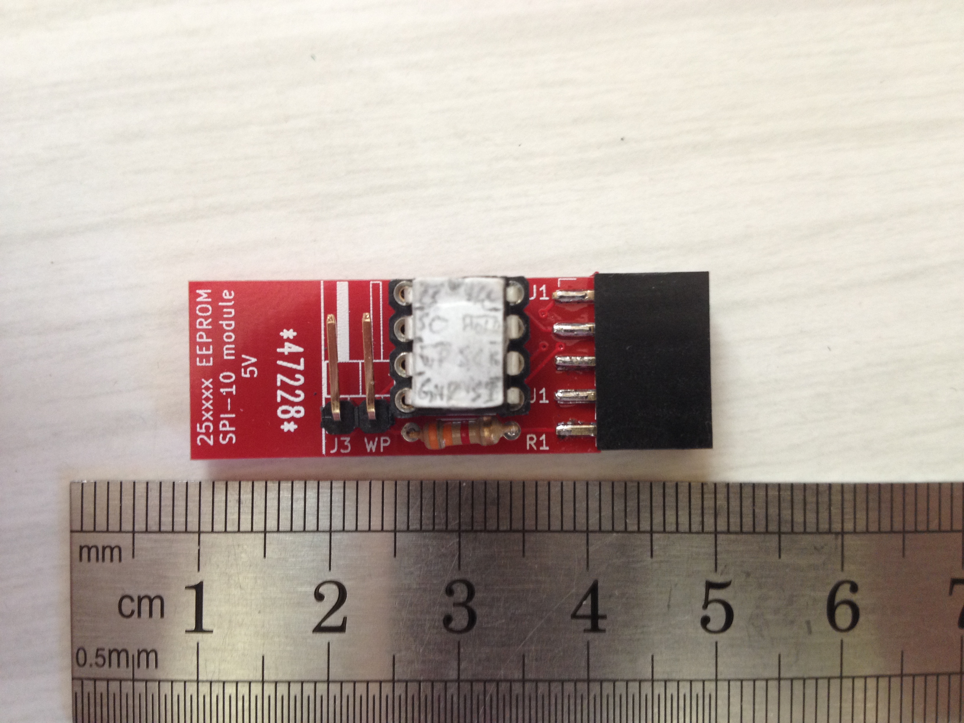

I have my PCBs!(Finally)
Looking them over, I notice I made a number of mistakes. All the capacitor pads are the wrong size(0805 instead of 1206) Luckily, I can still use the pads; they're just annoyingly difficult to use. Two of them look to be unusable, though, as their pads are obscured by the PLCC sockets. However, those sockets sit on little feet, not right up against the board. I might yet be able to get the caps under there.
The resistor footprints are really quite tight on the resistors I have, but that is not insurmountable either.
The single-gate ICs are tiny. Far smaller than I thought. I will almost certainly have trouble with them, and they are definitely going on before anything else in that area.
There's also no soldermask on the mainboards. The SPI-10 EEPROM modules have it, though.
I don't have the schottky diodes for the IRQ lines, but that was lack of prep on my part, and I'm not using them yet, anyway. I also don't have enough milled socket strips for all the ICs. That will slow me up, especially as I do not plan to cannibalize the previous prototype.
I don't think my electrical testing has been exhaustive, but it has checked what I consider the important lines(the address and data buses, Phase 2, /Reset, chip selects, and the 65SPI and DUART transmission lines).

Did you specify solder mask when you ordered the PCBs? Not having solder mask could make soldering the SMT parts quite a challenge.
DerTrueForce
Posts: 483
Joined: 04 Jun 2016
Location: Australia
Re: Ittiara, a 65C02 handheld
Post by DerTrueForce »
I might have failed to include the soldermask gerber... No, I included one. It's a blank, uninterrupted square. Looking at the soldermask layer from the SPI-10 module(which worked correctly), it looks like it's a negative layer. The reason there is no soldermask seems to be because I did an extremely stupid, and put a fill on both soldermask layers. I just got rid of the fill and re-rendered the gerbers, and sure enough, the pads now appear correctly.
Groan.
If it wasn't totally irrelevant, I would post a meme I recently pinched, of a guy facepalming so hard, his hand went right through his head and out the back. That is how I feel right now.
That kind of thing is why I like to view the gerber file results in the free gerbv software before sending it.
https://sourceforge.net/projects/gerbv/ (although I got it from the Ubuntu software center which is just one-click download and install).
