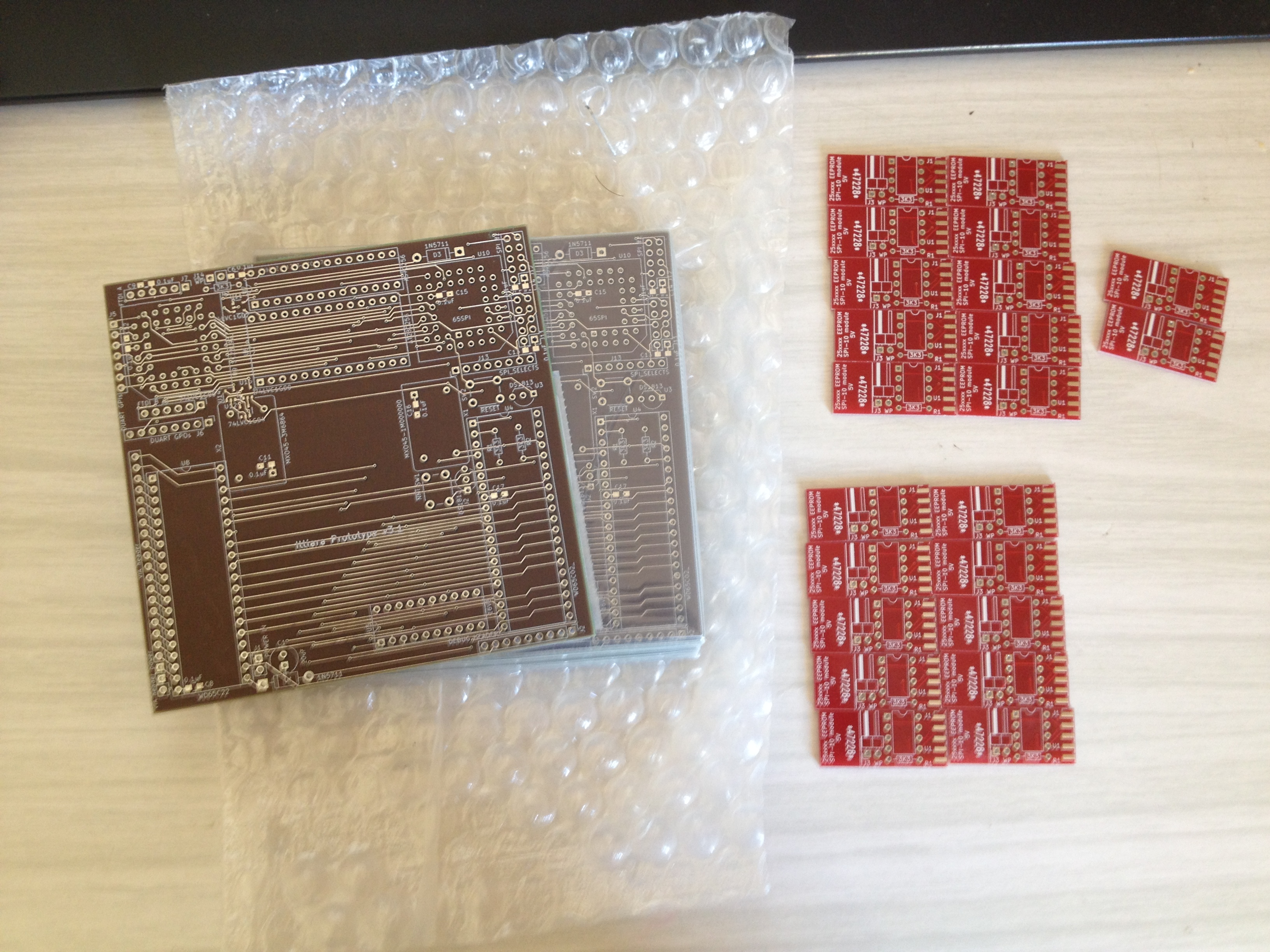

I have my PCBs!(Finally)
Looking them over, I notice I made a number of mistakes. All the capacitor pads are the wrong size(0805 instead of 1206) Luckily, I can still use the pads; they're just annoyingly difficult to use. Two of them look to be unusable, though, as their pads are obscured by the PLCC sockets. However, those sockets sit on little feet, not right up against the board. I might yet be able to get the caps under there.
The resistor footprints are really quite tight on the resistors I have, but that is not insurmountable either.
The single-gate ICs are tiny. Far smaller than I thought. I will almost certainly have trouble with them, and they are definitely going on before anything else in that area.
There's also no soldermask on the mainboards. The SPI-10 EEPROM modules have it, though.
I don't have the schottky diodes for the IRQ lines, but that was lack of prep on my part, and I'm not using them yet, anyway. I also don't have enough milled socket strips for all the ICs. That will slow me up, especially as I do not plan to cannibalize the previous prototype.
I don't think my electrical testing has been exhaustive, but it has checked what I consider the important lines(the address and data buses, Phase 2, /Reset, chip selects, and the 65SPI and DUART transmission lines).

PostPosted: Thu Apr 26, 2018 7:14 am
Posts: 8514
DerTrueForce wrote:
I have my PCBs!(Finally)...There's also no soldermask on the mainboards.
Did you specify solder mask when you ordered the PCBs? Not having solder mask could make soldering the SMT parts quite a challenge.
PostPosted: Thu Apr 26, 2018 9:25 am
Posts: 483
Location: Australia
I might have failed to include the soldermask gerber... No, I included one. It's a blank, uninterrupted square. Looking at the soldermask layer from the SPI-10 module(which worked correctly), it looks like it's a negative layer. The reason there is no soldermask seems to be because I did an extremely stupid, and put a fill on both soldermask layers. I just got rid of the fill and re-rendered the gerbers, and sure enough, the pads now appear correctly.
Groan.

PostPosted: Thu Apr 26, 2018 9:38 am
Posts: 8546
That kind of thing is why I like to view the gerber file results in the free gerbv software before sending it.
https://sourceforge.net/projects/gerbv/ (although I got it from the Ubuntu software center which is just one-click download and install).
