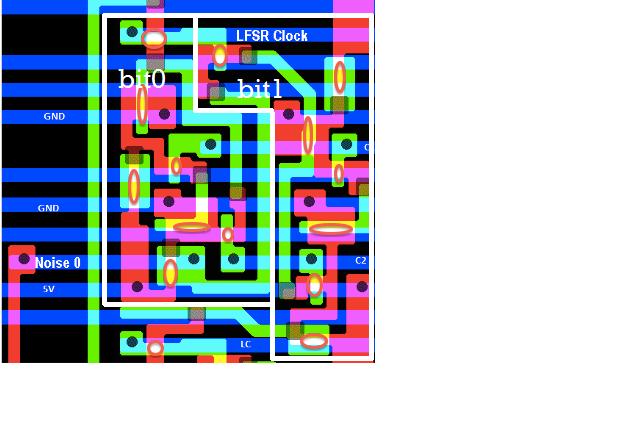

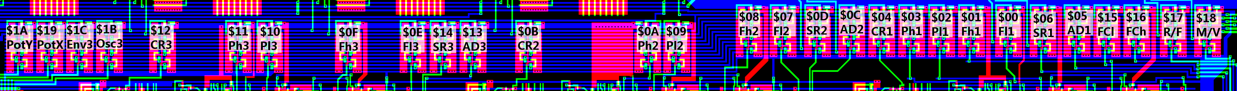

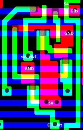

Thanks for marking those transistors.
Tried to draw white lines around the flipflops for bit 0 and bit 1:
drfiemost
Posts: 53
Joined: 07 Jun 2016
Re: Understanding the SID
Post by drfiemost »
Yes, that's correct, and there are seven transistors per bit, no pull-up/pull-down resistor to avoid floating state. Also I'm noticing that the oscillator is not tied to the reset signal even if it is supposed to be zeroed out at startup. :?

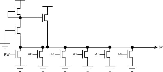

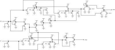

Anyway I started looking at the address bus as suggested.
There are five address pins, from A0 to A4, to allow indexing the 29 chip registers.
Again some big transistors to control timings, but basically this produces two signals, one of which is high when the line is high and the other when it's low. During reset both signals are held at zero.
drfiemost
Posts: 53
Joined: 07 Jun 2016
Post by drfiemost »

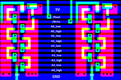

These are two address decoders for the read-only register $1B (OSC3) on the left and the write-only register $12 (CR3) on the right.
Each decoder just NORs the five address lines and the read/write line, taking as input either the active low or the active high ones depending on the register's address and function. A register is therefore activated when all of its inputs are low.
For example the line $1B is active only when the address bus has the value 11011, so if one or more of the A4_low, A3_low, A2_high, A1_low or or A0_low lines are high the decoder outputs a zero. This also happens, being a read-only register, when the write line is high.
This is the full map of the address decoders:
The description of the registers is available here from the reference manual.
Edit: updated schematic.
Edit2: updated line names in the layout.

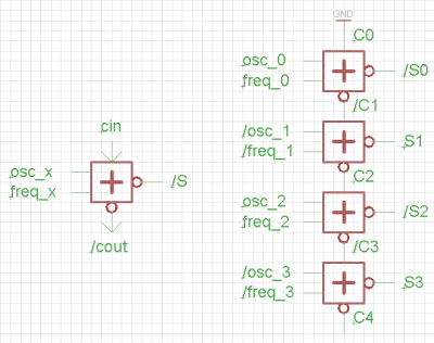

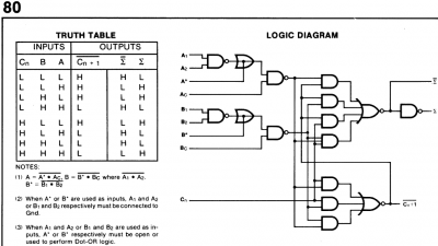

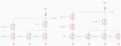

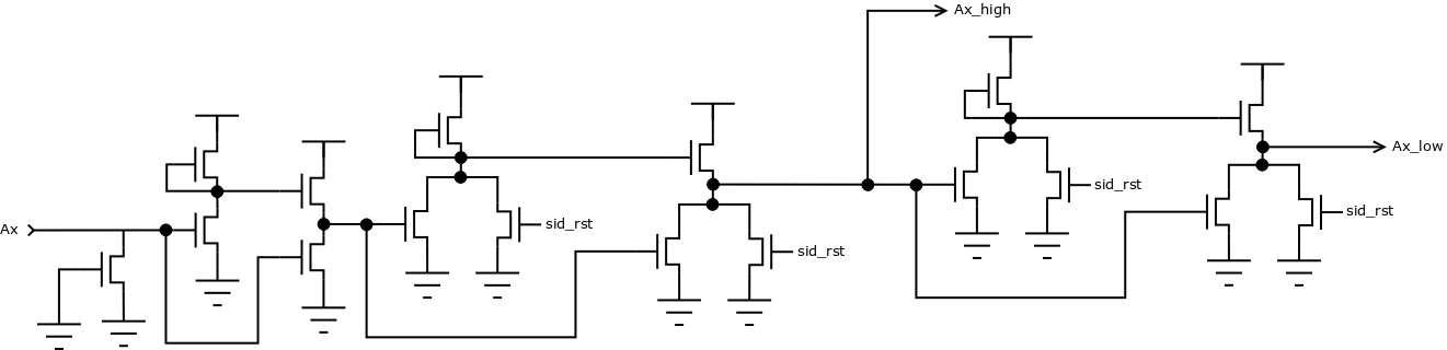

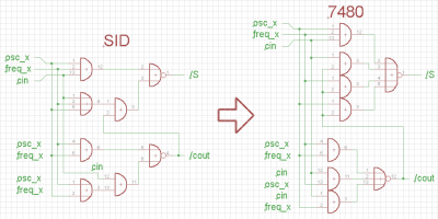

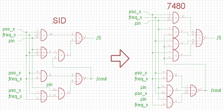

Looks like the adders tied to the oscillator registers
are nothing but a NMOS implementation of the bipolar TTL 7480.
More info about the 7480 can be found here:
http://6502.org/users/dieter/a5/a5_3.htm

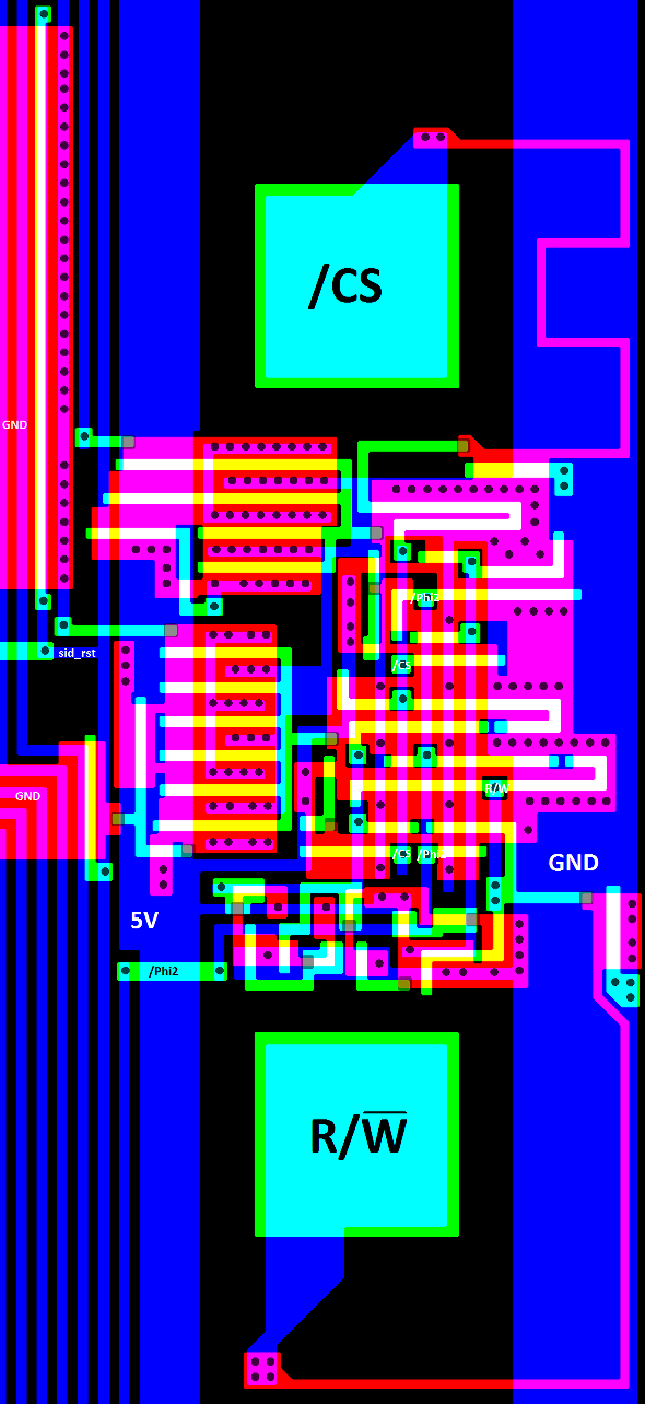

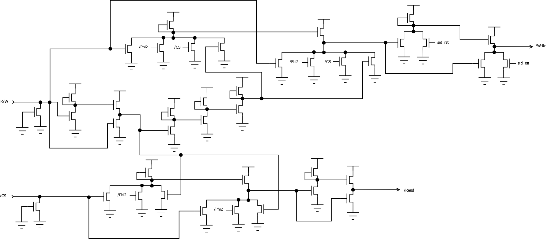

Here is the last bit for the address decoding, the CS and R/W pins. CS is the active low chip select signal while R/W controls the data flow direction.
More details on the pins and the timings can be found in the reference
Both the read and write operations are controlled through NOR gates using the CS, Phi2 and RW signals as input.
The resulting expressions are:
/Write = ¬(¬(RW ∨ ¬Phi2 ∨ /CS ∨ _RW) ∨ sid_rst) = (RW ∨ ¬Phi2 ∨ /CS ∨ _RW) ∧ ¬sid_rst
/Read = ¬(¬(/CS ∨ ¬Phi2 ∨ A)) = /CS ∨ ¬Phi2 ∨ ¬RW
where _RW is the RW signal slightly delayed by passing through a few inverters, maybe to give the data bus some time before doing the actual writing.
The read/write operations are then done when CS is low and Phi2 is high. When RW is high a read is performed otherwise it's a write.
During reset the /Write line is low while /Read is high, meaning that every register is written to as we have seen that all the address lines are low too.
I guess this is used to zero out all the registers at startup, but we need to have a look at the data bus before concluding that. Another interesting thing to find out is what happens when reading from a write-only or from a non-existing register.

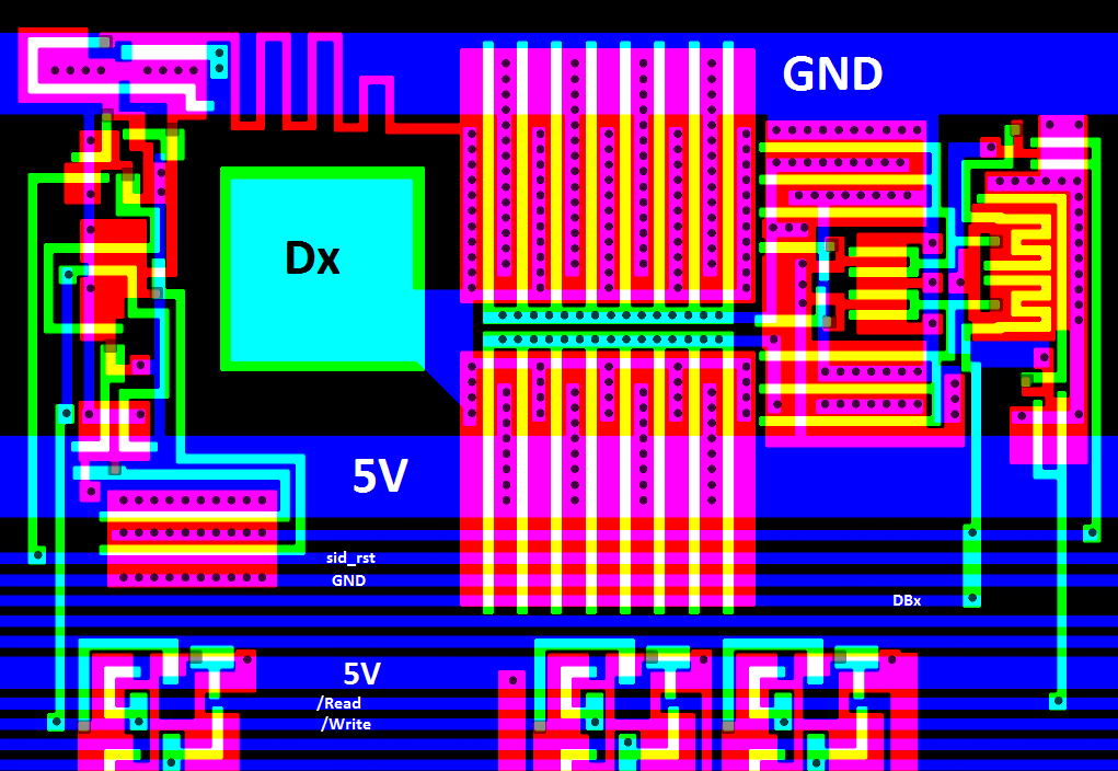

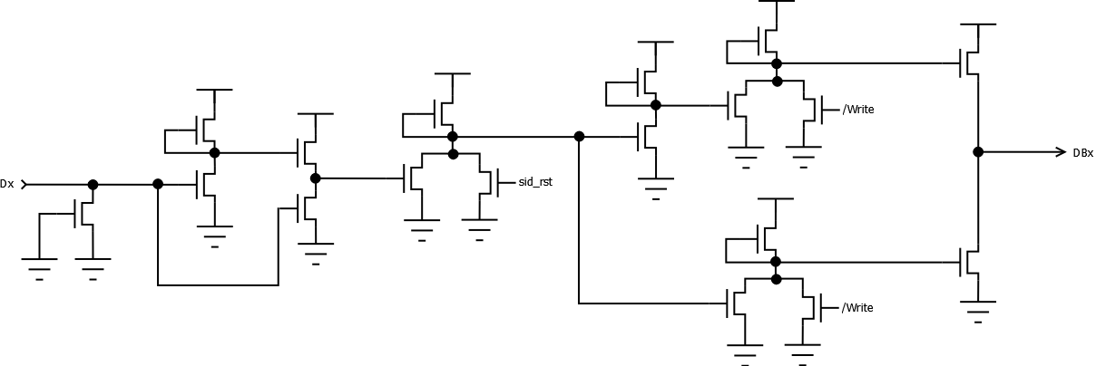

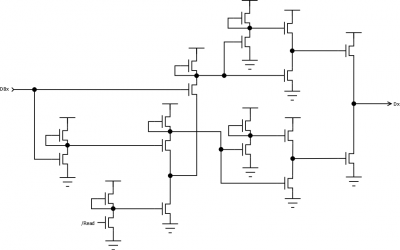

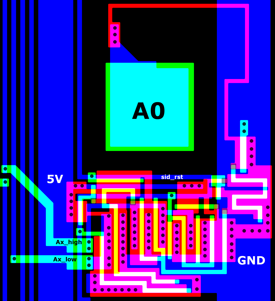

This is one of the eight data pins, the input logic on the left and the output logic on the right.
The input circuitry is based on NOR ports driven by the /Write and sid_rst signals:
The value at the gates of the two transistors on the right side of the picture (a being the one connected to Vcc and b the one connected to GND) are described by the following expressions:
a = ¬(¬(¬(¬Dx ∨ sid_rst)) ∨ /write) = Dx ∧ ¬sid_rst ∧ ¬/write
b = ¬(¬(¬Dx ∨ sid_rst) ∨ /write) = ¬(Dx ∧ ¬sid_rst) ∧ ¬/write
where Dx is the xth bit pin. The resulting truth table is then:
Dx sid_rst /write | a b | DBx
0     0       0   | 0 1 |  0
1     0       0   | 1 0 |  1
0     1       0   | 0 1 |  0
1     1       0   | 0 1 |  0
0     0       1   | 0 0 |  x
1     0       1   | 0 0 |  x
0     1       1   | 0 0 |  x
1     1       1   | 0 0 |  x
When the /write line is high the input is disconnected from the data bus, otherwise the data from the pins is written to it, unless the sid_rst signal is high in which case a zero is forced unto the data bus.
This confirms that during a reset all the writeable registers are initialized to zero.
Writing to a read-only or a non-existant register only puts the input value on the data bus.
The output is based on NAND ports driven by the /Read signal:
The value at the gates of the two transistors on the right are described by the following expressions:
a = ¬(¬(DBx ∧ ¬/read)) = DBx ∧ ¬/read
b = ¬(¬(¬DBx ∧ ¬/read)) = ¬DBx ∧ ¬/read
where DBx is the data bus bit x. The resulting truth table is then:
DBx /read | a b | Dx
0     0   | 0 1 |  0
1     0   | 1 0 |  1
0     1   | 0 0 |  x
1     1   | 0 0 |  x
When the /read line is high the output is disconnected from the data pin, otherwise the value on the data bus can be read from the data pins.
Reading from a write-only or a non-existant register returns the value present on the data bus, which is the one from the last valid read/write. According to the comments in the resid sources this value fades to zero after some time, depending on the chip model and temperature.

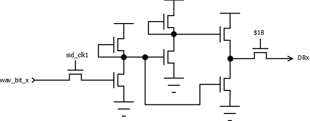

Let's have a look at a couple of registers before getting back to the wave generation.
This is one bit from OSC3, a read-only register which allows access to the upper eight bits of the third voice's waveform.
The waveform bits are latched at sid_clk1 and pushed to the databus when the register's line is activated from the address decoder.

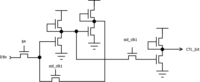

The following is from the voice 1 control register.
The databus bits are latched when the register's line is activated. At sid_clk1 the value is forwarded to the components that need it and is also fed back into the latch to keep the bit alive. The curious thing is that the inverted value is sent out and then passed through another inverter, why couldn't this be avoided?
There is another thing that makes me wonder here: why are the /read and /write lines clocked at /Phi2 (or actually a slightly delayed version) and not sid_clk2?

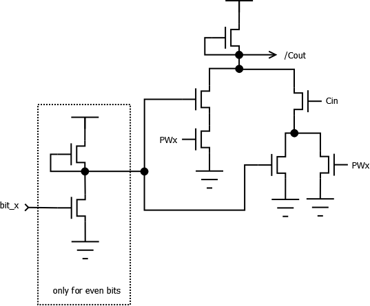

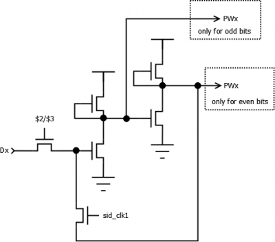

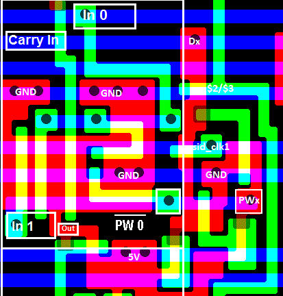

Now on to the wave generation, today we look at the pulse.
This waveform is obtained by comparing the upper 12 bits of the oscillator with a programmable Pulse Width value and setting all the output bits to zero or one depending on the result of the comparison.
In this picture we can see the Pulse Width register bit on the right and an adder's carry-block on the left.
The PulseWidth register bits are formed by a couple of inverters where the feedback loop is clocked by sid_clk1. The input is taken from the data bus and is enabled by the $2 line for the low eight bits and $3 for the others.
The carry calculator is the same as the one in the oscillator adder, with the inverted logic for the even bits.
In order to perform a subtraction the two's complement of the pulse width value is used as input. The pw bits are taken inverted and the carry input (Cin) for the first bit is connected to Vcc (logical 1).
the resulting expression, as we have already seen, is:
/Cout = ¬((bit_x ∧ PW_x) ∨ (Cin ∧ (bit_x ∨ PW_x)))
The output of the last carry calculator is then used to generate the pulse output, unless the test bit is set.
The carry output is latched at sid_clk2 and NORed with the test bit. The result is latched at sid_clk1 and used, after an inversion, for the pulse bits.
When the test bit is set the pulse output is fixed at $fff.

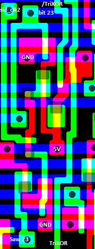

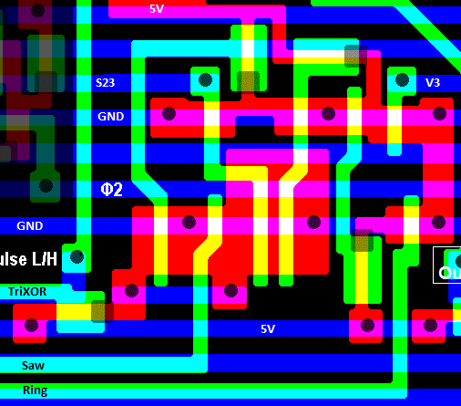

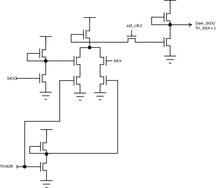

Next one is the triangle waveform.
The upper 12 bits of the oscillator run from 0 to $fff, at a speed dependent on the frequency, producing a sawtooth waveform.
A triangle waveform is obtained by XORing the bits with the oscillator's MSB, in this way during the second half of the wave, when the MSB is 1, the bits are inverted forming the descending ramp of the triangle. As the result is only 11 bits the value is shifted to the left and the LSB is set to 0, thus halving the resolution but retaining full amplitude.
It is possible to apply a ring modulation effect, controlled by Bit 2 of the Control Register, so the MSB is XORed with the (inverted) MSB of the preceeding voice producing non-harmonic overtones.
This is the XOR logic applied to the first eleven bits of the oscillator's output:
The output results from the following expression:
Tri_bitX = ¬((TriXOR ∧ bitX) ∨ ¬(TriXOR ∨ bitX))
= TriXOR + bitX
The xor input is generated by the following circuit:
TriXOR = ¬(a ∨ Saw ∨ (b ∧ bit23))
= ¬Saw ∧ ¬a ∧ ¬(b ∧ bit23)
where:
a = ¬(b ∨ bit23)
b = ¬(V3 ∨ ¬Ring) = ¬V3 ∧ Ring
(V3 is the 23rd bit of the ring modulating voice's oscillator)
resulting in:
TriXOR = ¬Saw ∧ (b ∨ bit23) ∧ ¬(b ∧ bit23)
= ¬Saw ∧ (b + bit23)
= ¬Saw ∧ ((¬V3 ∧ Ring) + bit23)
So TriXOR is high for the following combinations:
S | b23 | V3 | R
0 |  1  | 0  | 0
0 |  1  | 1  | 0
0 |  0  | 0  | 1
0 |  1  | 1  | 1
In other words if the sawtooth waveform is not selected the oscillator bits are inverted when ring modulation is diabled and the MSB is 1 or when ring modulation is enabled and the two MSBs, from the current and the modulating voices, are equal.
When the sawtooth is selected the XORing is disabled as the same output is used for both waweforms.
An interesting thing is that in resid the V3 value is not inverted, so either I've found a bug or I did some mistake. That's something worth exploring :)

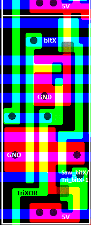

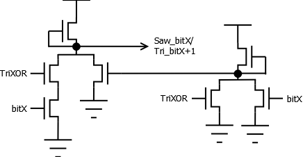

Ah, found something really interesting!
While looking at the 8580 IC I noticed that the triangle bits are quite different, taking up more space with a couple more transistors:
Let's see what's going on here:
There is only one logical port surrounded by a few inverters. The result is the same but the intermediate (inverted) value is latched at sid_clk2.
/Tri_bitX = ¬((¬bitX ∧ TriXOR) ∨ (¬bitX ∧ ¬TriXOR))
= ¬(TriXOR + bitX)
I start suspecting that it is only the sawtooth/triangle output that is delayed one cycle and not the register writes.
There is also a difference in how the sawtooth's MSB is obtained:
In the 6581 the MSB of the oscillator, used as input for the triangle xor logic and the pulse adder last bit, is connected directly to the waveform selector, while in the 8580 it is instead latched at sid_clk2 before being forwarded to the selector.
This has an implication on combined waveforms: in the 8580 if the sawtooth MSB is pulled down it won't affect the pulse and triangle xor circuits.

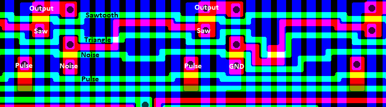

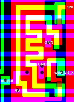

I've already introduced the waveform selector in a previous post but I'll add some more details here.
There are twelve bits each with four inputs for the different waveforms connected as follows:
  • Pulse: each bit is connected to the latched output of the pulse adder;
  • Noise: the lower four bits are grounded while the others are connected respectively to the bits 0, 2, 5, 9, 11, 14, 18 and 20 of the LFSR register;
  • Triangle: the LSB is grounded while the remaining bits are connected to the triangle xor outputs;
  • Sawtooth: the lower eleven bits are connected to the triangle xor outputs while the MSB is connected to bit 23 of the oscillator, directly in the 6581 and through a latch in the 8580.
An interesting thing to note is that in the 8580 the upper eight triangle selector transistors are narrower than the others while the lower four and the sawtooth ones are slightly wider. In the 6581 all selector transistors are the same size.
The output of the multiplexer is then passed through what I think is an op-amp before going to the DAC.

Oscillator adders, re_drawn with switches:
Oscillator adders, SID versus 7480:
A screenshot from a Fairchild 7480 datasheet to confirm this:
http://www.mirrorservice.org/sites/www. ... a_Book.pdf
page 177 (4-94)
IMHO the oscillator adders have to be wired up this way to make it work:
(4 adderes shown)
