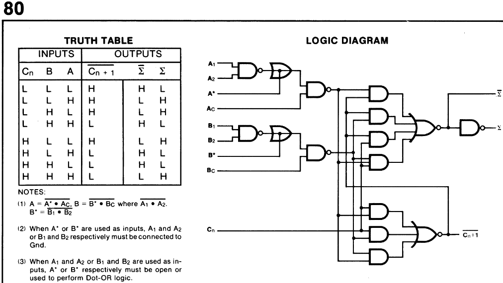

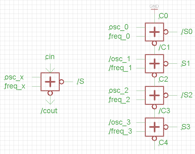

PostPosted: Fri Jul 01, 2016 8:00 am
Posts: 1431
Looks like the adders tied to the oscillator registers
are nothing but a NMOS implementation of the bipolar TTL 7480.
More info about the 7480 can be found here:
http://6502.org/users/dieter/a5/a5_3.htm
Hmm...
so if the frequency tuning word of an oscillator would be $0000,
the oscillator (phase accumulator) would stop running ?
This brings up an interesting question:
When clearing the bits in the LFSR somehow,
then instantly setting the frequency tuning word to $0000
for stopping the oscillator... and the LFSR clock too...
would the bits in the LFSR still flip back to 1 after a while ?
If they would stay 0, the "magic" for bringing those bits back to 1
probably isn't hidden in the bits 0, 2, 5, 9, 11, 14, 18 and 20
of the LFSR. :mrgreen:

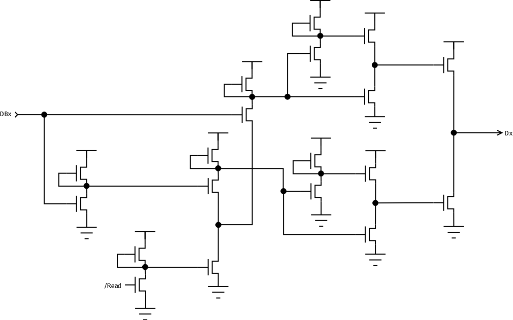

The output is based on NAND ports driven by the /Read signal:
The value at the gates of the two transistors on the right are described by the following expressions:
a = ¬(¬(DBx ∧ ¬/read)) = DBx ∧ ¬/read
b = ¬(¬(¬DBx ∧ ¬/read)) = ¬DBx ∧ ¬/read
where DBx is the data bus bit x. The resulting truth table is then:
DBx /read | a b | Dx
0     0   | 0 1 |  0
1     0   | 1 0 |  1
0     1   | 0 0 |  x
1     1   | 0 0 |  x
When the /read line is high the output is disconnected from the data pin, otherwise the value on the data bus can be read from the data pins.
Reading from a write-only or a non-existant register returns the value present on the data bus, which is the one from the last valid read/write. According to the comments in the resid sources this value fades to zero after some time, depending on the chip model and temperature.

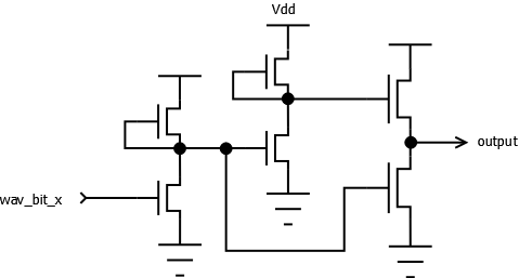

Let's have a look at a couple of registers before getting back to the wave generation.

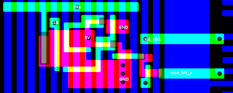

This is one bit from OSC3, a read-only register which allows access to the upper eight bits of the third voice's waveform.
The waveform bits are latched at sid_clk1 and pushed to the databus when the register's line is activated from the address decoder.

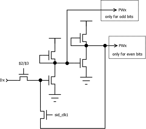

The PulseWidth register bits are formed by a couple of inverters where the feedback loop is clocked by sid_clk1. The input is taken from the data bus and is enabled by the $2 line for the low eight bits and $3 for the others.

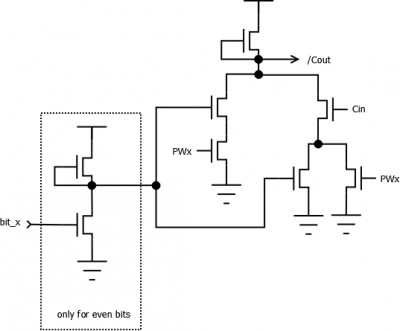

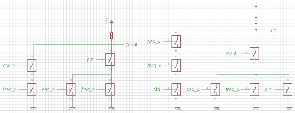

The carry calculator is the same as the one in the oscillator adder, with the inverted logic for the even bits.
In order to perform a subtraction the two's complement of the pulse width value is used as input. The pw bits are taken inverted and the carry input (Cin) for the first bit is connected to Vcc (logical 1).
the resulting expression, as we have already seen, is:
/Cout = ¬((bit_x ∧ PW_x) ∨ (Cin ∧ (bit_x ∨ PW_x)))

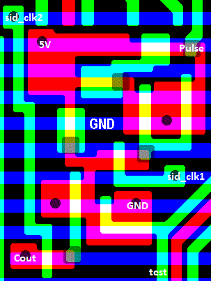

The output of the last carry calculator is then used to generate the pulse output, unless the test bit is set.

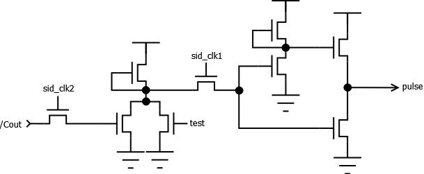

The carry output is latched at sid_clk2 and NORed with the test bit. The result is latched at sid_clk1 and used, after an inversion, for the pulse bits.
When the test bit is set the pulse output is fixed at $fff.
Just to add that the latching, as noted in the resid comments, causes a one cycle delay in the pulse waveform with respect to the oscillator value.
Also I'm wondering if I have to swap the sid_clk1 and sid_clk2 labels, as it will look more logical to me...
By the way, I've updated the clocking scheme again, now it _really_ makes sense.

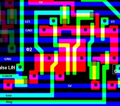

The xor input is generated by the following circuit:
The output results from the following expression:
TriXOR = ¬(a ∨ Saw ∨ (b ∧ bit23))
= ¬Saw ∧ ¬a ∧ ¬(b ∧ bit23)
where:
a = ¬(b ∨ bit23)
b = ¬(V3 ∨ ¬Ring) = ¬V3 ∧ Ring
(V3 is the 23rd bit of the ring modulating voice's oscillator)
resulting in:
TriXOR = ¬Saw ∧ (b ∨ bit23) ∧ ¬(b ∧ bit23)
= ¬Saw ∧ (b + bit23)
= ¬Saw ∧ ((¬V3 ∧ Ring) + bit23)

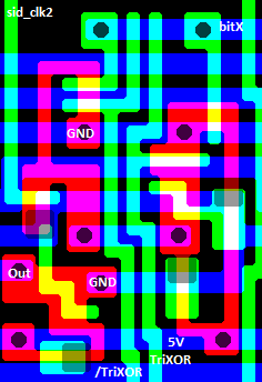

Ah, found something really interesting!
While looking at the 8580 IC I noticed that the triangle bits are quite different, taking up more space with a couple more transistors:

There is only one logical port surrounded by a few inverters. The result is the same but the intermediate (inverted) value is latched at sid_clk2.
/Tri_bitX = ¬((¬bitX ∧ TriXOR) ∨ (¬bitX ∧ ¬TriXOR))
= ¬(TriXOR + bitX)
I start suspecting that it is only the sawtooth/triangle output that is delayed one cycle and not the register writes.

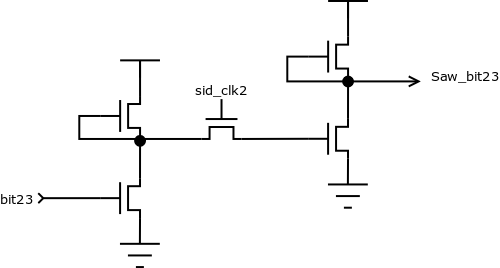

There is also a difference in how the sawtooth's MSB is obtained:
In the 6581 the MSB of the oscillator, used as input for the triangle xor logic and the pulse adder last bit, is connected directly to the waveform selector, while in the 8580 it is instead latched at sid_clk2 before being forwarded to the selector.

This has an implication on combined waveforms: in the 8580 if the sawtooth MSB is pulled down it won't affect the pulse and triangle xor circuits.

I've already introduced the waveform selector in a previous post but I'll add some more details here.
There are twelve bits each with four inputs for the different waveforms connected as follows:
  • Pulse: each bit is connected to the latched output of the pulse adder;
  • Noise: the lower four bits are grounded while the others are connected respectively to the bits 0, 2, 5, 9, 11, 14, 18 and 20 of the LFSR register;
  • Triangle: the LSB is grounded while the remaining bits are connected to the triangle xor outputs;
  • Sawtooth: the lower eleven bits are connected to the triangle xor outputs while the MSB is connected to bit 23 of the oscillator, directly in the 6581 and through a latch in the 8580.
An interesting thing to note is that in the 8580 the upper eight triangle selector transistors are narrower than the others while the lower four and the sawtooth ones are slightly wider. In the 6581 all selector transistors are the same size.
The output of the multiplexer is then passed through what I think is an op-amp before going to the DAC.

The width and length of a transistor directly relates to on-resistance, so it sounds like the 8-series part has a weighting function applied to the inputs - does that fit the facts?

Oscillator adders, re_drawn with switches:

A screenshot from a Fairchild 7480 datasheet to confirm this:
http://www.mirrorservice.org/sites/www.bitsavers.org/pdf/fairchild/_dataBooks/1978_Fairchild_TTL_Data_Book.pdf
page 177 (4-94)
IMHO the oscillator adders have to be wired up this way to make it work:
(4 adderes shown)
