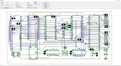

Finally finished my schematic, did a design review with my parents, and have laid out the board (I have not routed the board, only placed the components. I still am looking at PCB prices and deciding if I need to make some components SMD to make the board smaller / cheaper). BOM comes out to $60 for the components and $33/66 for the board (for 2 and 4 layers respectively).
My board is quite large (by my standards) at 6" x 2.75". As such, if anyone has some tricks / tips for decreasing the board size I would much appreciate hearing them. At the moment I am considering exchanging all the WDC DIPs for PLCCs and possibly substituting the ACIA with a MAX3100 driven by the VIA. *Please* tell me if I am crazy (or not) and if these are bad (or good) ideas.
I can post updated schematics and my PCB layout (in either image or diptrace schematic / board form) if anyone would like to take a look...

Finished my board layout and have submitted it for review by my parents and EE instructor (as well as an online DRC from the PCB manufacturer I am planning to use).
I do hope that those caps and resistors aren't too small to solder by hand ;)

Re: Finally starting the schematic for my first W65C02 SBC
Posted: Mon Apr 25, 2016 4:00 am
by GARTHWILSON
Have you run the DRC yet? Whether you use it or not (I don't), do a good visual on every layer. At first glance: Traces look too close to U5 pads 15-24 on the bottom layer. Even if you use an autorouter (which I don't recommend), do a good manual clean-up when it's done.
It will make it a lot easier for someone else to check it if you have one diagram with all the layers, each one shown in a different color.
Posted: Mon Apr 25, 2016 4:14 am
by billylegota
I have run a DRC (both in Diptrace and with the potential board manufacturer) and everything is >= 8 mils apart.
Here is the best I can do within Diptrace:
Posted: Mon Apr 25, 2016 4:18 am
by billylegota
I did all the routing for the bypass caps and the ACIA's oscillator circuit. I think I may just have to do the entire circuit by hand as the autorouter looks like it had a few too many drinks...

Posted: Mon Apr 25, 2016 5:22 pm
by BigDumbDinosaur
billylegota wrote:
That being said, there is nothing that GrafX-2 can't fix ;)
Just an opinion, but you have some traces that are too close to device pins. For example, look at pins 5, 6 and 7 of U6. A sudden slip of the soldering iron could gouge the solder mask on one of those traces and possibly cause a bridge. Passing a DRC is not a guarantee that you won't run into trouble.
Posted: Tue Apr 26, 2016 1:07 am
by billylegota
I have changed *my* DRC to a minimum of 0.015" between traces and a trace width of 0.01" (up from 0.008" for each). I have also tried to do a bit more of the routing by hand (although I must admit, I did eventually give up and let the auto router finish the job).

by billylegota
As BDD pointed out, the previous version had quite a few traces that were dangerously close to where I was going to be soldering. As such I have tried to make sure that the traces are at least a *little* further away from the pads.
Posted: Tue Apr 26, 2016 7:59 am
by BigEd
This revision looks much better to me - no places where two tracks on the same layer squeeze between two pins. There are still a few places where the wires are approximately that close, but it's away from the soldering points. Personally, if the tools allow, I'd do a little manual tidying to space close wires a little more - moving towards a 0.05 inch grid, to the degree that's reasonably possible, without being purist about it.
