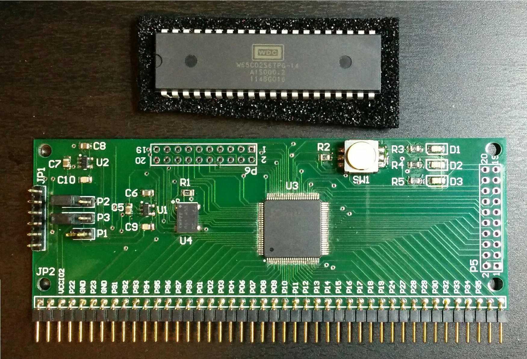

Re: AVR as UART/ACIA IC
I had to look up when the SuperCPU came out, which was a 20MHz '816 accelerator for the C64. It was 1996. I thought it was earlier. Bill Mensch said in an interview that in the early years of 6502, production testing was by hand, apparently functional only (ie, no testing of things like timing margins, drive currents, leakages, input voltage thresholds, etc.), and they marked the part for half of the fastest speed it ran fine at, rounded down to the nearest lower number of MHz. So a 6502 that ran at at 5MHz was marked for 2MHz. He said they had some that ran at 10MHz, even in the NMOS days, before the 65c02.
A friend got an Amiga 500 not long after they came out, and showed me some very impressive graphics demos.
It definitely would be nice to have some new 65xx I/O hardware; but it's not really necessary, as BDD pointed out. It would just make bus interfacing a bit easier. The '22 VIA is great for general-purpose I/O, but the new '51 has been a bit problematic, and there's nothing in production that directly addresses SPI, I²C, video, PWM, A/D, etc..
I have become more and more stack-oriented (including virtual stacks, not just the page-1 hardware stack), and using them to keep and pass parameters, have local variables, etc. makes for a reduced need for processor registers. The data stack works well in ZP. It really reduces the need for variables and the chances for contention between different pending routines wanting the same registers or data memory locations at the same time. Sometimes I have thought it would be cool if ZP and page 1 were onboard and each of these two pages had its own bus, making simultaneous access possible. The 6502-based microcontrollers seemed to mostly put their I/O in ZP, making I/O more efficient. This is where the SMB, RMB, BBS, and BBR instructions come in most useful. As long as I/O is onboard (as in a microcontroller), it would be nice to have that in its own page too.
Soldering SOICs and PQFPs with a chisel-tipped iron is pretty easy. After tacking two opposite corners down, you flood an entire side at once, possibly even with one big bridge, then another side, then get the excess solder off the iron and come back and hold the board vertically and go slowly from top to bottom of the row of pins. The extra solder comes off on the iron, leaving just the right amount on each pin, with no bridges, even though the iron's tip is fat enough to touch several pins at once. It works pretty well with a little practice. Extra flux helps but is not necessary, I've found.
