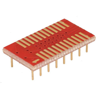

It is unfortunate that so many ICs are not available in DIP form; but fortunately we can get adapters that are easy to use, like this one from Jameco: There are also thru-hole PLCC sockets, even wire-wrap ones (although the WW ones are expensive and hard to find): The 6522's shift register can only go one direction at a time, so you'd need two for full duplex SPI. I think all the SPI ICs I've used used only one direction at a time though, with dummy data going in the other direction. If you do use the SR, sending a byte is as simple as STA VIA_SR. 16 clocks later, you can do it again, if it's running at half the phase-2 rate. If you can get the next byte to send any sooner, you could check the status but it would be more efficient to just put in a NOP or something like that. If you were transferring a block of data like for an SPI serial memory, you might have for example:
Having said that, nothing beats solderless breadboard for trying out new ideas or ideas. I am very impressed with the work that Oneironaut is doing with his Vulcan 74 project (to single out one of many impressive projects shared by members here). If I had no other choice, I'll use a surfboard (SMT to through-hole kludge) to enable me to use parts I can't find in any other format, or I'll just design an entire daughterboard I can easily interface to breadboard as I have done with CPLDs in the past (the source of my TQFP-100 soldering "fun"). But in this case there is a readily available off-the-shelf DIP part which I believe can be made to function as a high-performance UART that will afford no performance degradation to any 6502 system into which it is plugged, and which will have a software interface which will be virtually indistinguishable from the real thing. Well, those are my goals anyway, let's see how close I can get to them. And if I'm successful, I'll leverage the work to add SPI, I2C, and any of the other dozen or so hardware peripherals that make the PIC an attractive platform for embedded work.

Soldering SOICs and PQFPs with a chisel-tipped iron is pretty easy. After tacking two opposite corners down, you flood an entire side at once, possibly even with one big bridge, then another side, then get the excess solder off the iron and come back and hold the board vertically and go slowly from top to bottom of the row of pins. The extra solder comes off on the iron, leaving just the right amount on each pin, with no bridges, even though the iron's tip is fat enough to touch several pins at once. It works pretty well with a little practice. Extra flux helps but is not necessary, I've found.

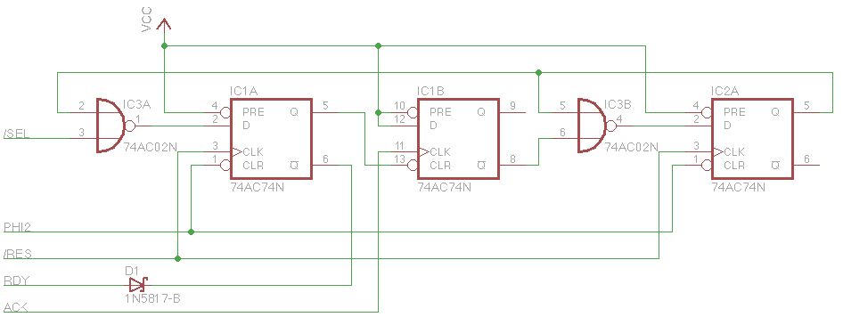

I'm still thinking about starting such a project as well, i.e. using a microcontroller as universal IO. In this thread a lot was discussed related to speed and number of cycles available to the microcontroller etc. But I think what we need is a solution that does neither depend or rely on the speed of the 6502 nor the microcontroller (AVR). Therefore I thought about a RDY generator that allows the 2 CPUs to run at individual speeds without constraints. Here is my proposal
After a Reset all flip-flops are cleared. /SEL is assumed to be the chip-select for IO and is asserted (low) for the IO range. When asserted, this must happen when PHI2 is low, FF IC1A will toggle from '0' to '1' on the next leading edge of PHI2 and pull RDY low. The address bus of the 6502 will be kept in the current state and /SEL will be left asserted. Now the microcontroller can do it's job and when done needs to assert ACK, the leading edge of ACK will trigger FF IC1B (note thate CLR is high so it will follow the D-input on a clock). As now both inputs of the NOR IC3B are low (note that IC2A was cleared after a RESET) the next leading edge of PHI2 will toggle FF IC2A from '0' to '1'. Now one input of IC3A is high and therefore the D-input of FF IC1A will be again high and FF IC1A will toggle from '1' to '0' then next leading edge of PHI2. RDY will now be released and the 6502 will resume it's cycle.
Once the microcontroller has asserted ACK it must de-asssert ack before honouring another IO request.
Using this circuit it does not matter at which clock rate the two CPUs (6502 und microcontroller) will run. Also it does not matter how long the microcontroller takes, the 6502 will wait.
By the way when using this circuit with a 65C816 and using the bank addresses you must take care that the databus of the 6502 will only show the bank address in the first PHI2=Low phase. So you must only latch the Bank address when RDY = high.
Also I would not use /SEL as an interrupt to the microcontroller but rather I would poll the /SEL signal in order to save the interrupt level for other internal tasks of the microcontroller. This also gives you the fastest response.

Re: AVR as UART/ACIA IC
Peter, your circuit looks good except for an apparent typo. The diagram shows the 74_74 /CLR inputs being driven by PHI2, but I think the signal names have gotten reversed on the left side of the drawing -- the labels PHI2 and /RES have gotten exchanged. (I PM'd you shortly after you posted this on Tuesday, but maybe the PM notification didn't reach you.)
