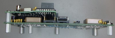

To clarify: Unless you're going to stick with really low frequencies like 1-2MHz, the stuff that's not on the board does not get connected to the processor's own buses.
I’m including the ‘245 bus drivers at this moment. Does a 65C02 or a 65C816 can do without them, even if one decided to go off the board?
I’m clearly uncertain. :roll: :oops:
Marco
Re: 6502 Design & concept questions.
I think their drivers are strong enough for anything you might want to connect; but the point in keeping the buses from going off the board is a different issue, having to do with speed and inductance and transmission-line effects. When connections get long compared to the wavelengths of the frequencies found in high operating speeds and fast edge rates, you'll get reflections and other unwanted effects that make a signal unintelligible unless special measures are taken. To make a real-life illustration of the reflections, think of echo. Recently I was in a parking structure where a car alarm was making the horn beep on and off a couple of times a second; but from where I was initially, it sounded like the horn was honking continuously because of all the echoing. As I got closer, I could start to distinguish the on-off-on-off and tell that it wasn't honking continually. Or think of the announcements in airport terminals that lack sound-deadening materials. It is extremely difficult to understand what they're saying. The same thing can happen with your longer connections through multiple connectors, and the ringing in the signal makes it unintelligible to the receiving end. We have a sticky topic for good construction at high frequencies, at viewtopic.php?f=4&t=2029 .

P/N 856597 is specified as the industrial temperature range. P/N 918647 is the commercial version, which is what you should order. I've attached the 26C92 data sheet in case you don't have it handy.
I’m including the ‘245 bus drivers at this moment. Does a 65C02 or a 65C816 can do without them, even if one decided to go off the board? I’m clearly uncertain. :roll: :oops:
The answer would substantially depend upon your construction methods. The 'C02 and '816 do drive the buses harder than the NMOS MPUs, so they can cope with more bus loading. It helps if all silicon is CMOS, of course.
Bus drivers and transceivers (you'd use the latter on D0-D7) will help—their purpose in life is to strengthen bus signals to cope with increased loading. However, bus drivers may introduce problems with ringing. Also, as Garth noted, transmission line effects related to the effective "wave length" of the signal relative to the length of the bus can result in a variety of problems, e.g., signal reflections, that are not easily resolved by the average hobbyist. As the ideal waveform in a digital circuit is rectangular, very strong odd-order harmonic content is theoretically (and usually) present. Anything that delays or attenuates the higher order harmonics will have the effect of transforming the rectangular waveform into something more akin to a trapezoid, and may cause switching problems in the device that is at the receiving end of the signal.
Schottky diode suppression at the far ends of the bus can be applied to get ringing under control and possibly reduce reflection (see attachment). Higher order harmonic attenuation is more difficult to counteract, however—a good knowledge of transmission line theory is essential. Best practice is to develop an expansion bus that doesn't require direct connection to the MPU's buses and control lines. This is what is done in virtually all professionally-designed computer systems that accept plug-in cards. You can build such an arrangement with some 65C21s or 65C22s driving the expansion bus, along with some adroit glue logic design.
I was able to take the MPU's buses off-board to interface the SCSI host adapter to POC V1.1, suffering a small reduction in maximum stable Ø2 speed from 12.5 MHz to 10 MHz in the process (side-view of the interface between host adapter and mainboard attached). I was careful to keep the overall length of the connections to a minimum and it does work. POC V2 will have the 53C94 SCSI ASIC on the mainboard, which will eliminate the need for the separate host adapter.

POC V1.1 w/SCSI Host Adapter (side-view)
Doing a very short-distance hop as shown in BDD's picture is low-risk. Doing long backplanes with big boards plugged in is another matter—although, like Arlet said, at 1-2MHz, you can get away with murder. [Edit: I must clarify that that refers to timings. If you have fast parts, you still have to keep your nose clean regarding build technique, as poor build technique can bite you even at very low clock rates.]
I wonder though if those diode arrays help much, since they basically duplicate the protection diodes at the inputs of CMOS ICs. If they're fast enough though, having a sudden change in the slope of the curve (where the diode starts conducting), and a sudden increase in current right there, can show up as a spike elsewhere on the transmission line.
Professionally designed high-speed backplanes and plug-in boards have controlled-impedance transmission lines with matching terminations to eliminate reflections; but if the termination doesn't match the characteristic impedance of the transmission line, you won't accomplish the purpose. And with several loads along the line (like you have with a backplane), mathematically it gets very complicated. The easiest way to stay out of trouble is to just keep the lines short for the speeds being used.

Doing a very short-distance hop as shown in BDD's picture is low-risk. Doing long backplanes with big boards plugged in is another matter-- although, like Arlet said, at 1-2MHz, you can get away with murder.
Recall that the original eight bit x86 ISA bus ran at a relatively sedate pace of 4.77 MHz (same speed as the Intel 8088), and that it was part of the motherboard, where presumably the connections would be point-to-point. In fact, IBM went to a fair amount of trouble to minimize spacing between the slots, presumably to avoid signal distortion.
I could see a 65xx system mimicking that arrangement, using 65C21s or 65C22s (or other devices that are similar in function), probably at a clock speed that is a subintegral of Ø2 to ease the problem of reflections and ringing. A scheme would also have to be worked out to deal with IRQs, card selects, etc.
The protection diodes at CMOS inputs are there for ESD purposes and aren't guaranteed to have any particular recovery time. Also, the diodes' zener voltage is not specified as well, but would presumably be somewhat higher than the device's rated input voltage maximum (Vin) to avoid inadvertent input signal clipping.
The Schottky array that I earlier linked is designed to both limit over- and under-shoot, and has a typical recovery time of 8ns. I doubt that a device's internal protection diodes can do that.
