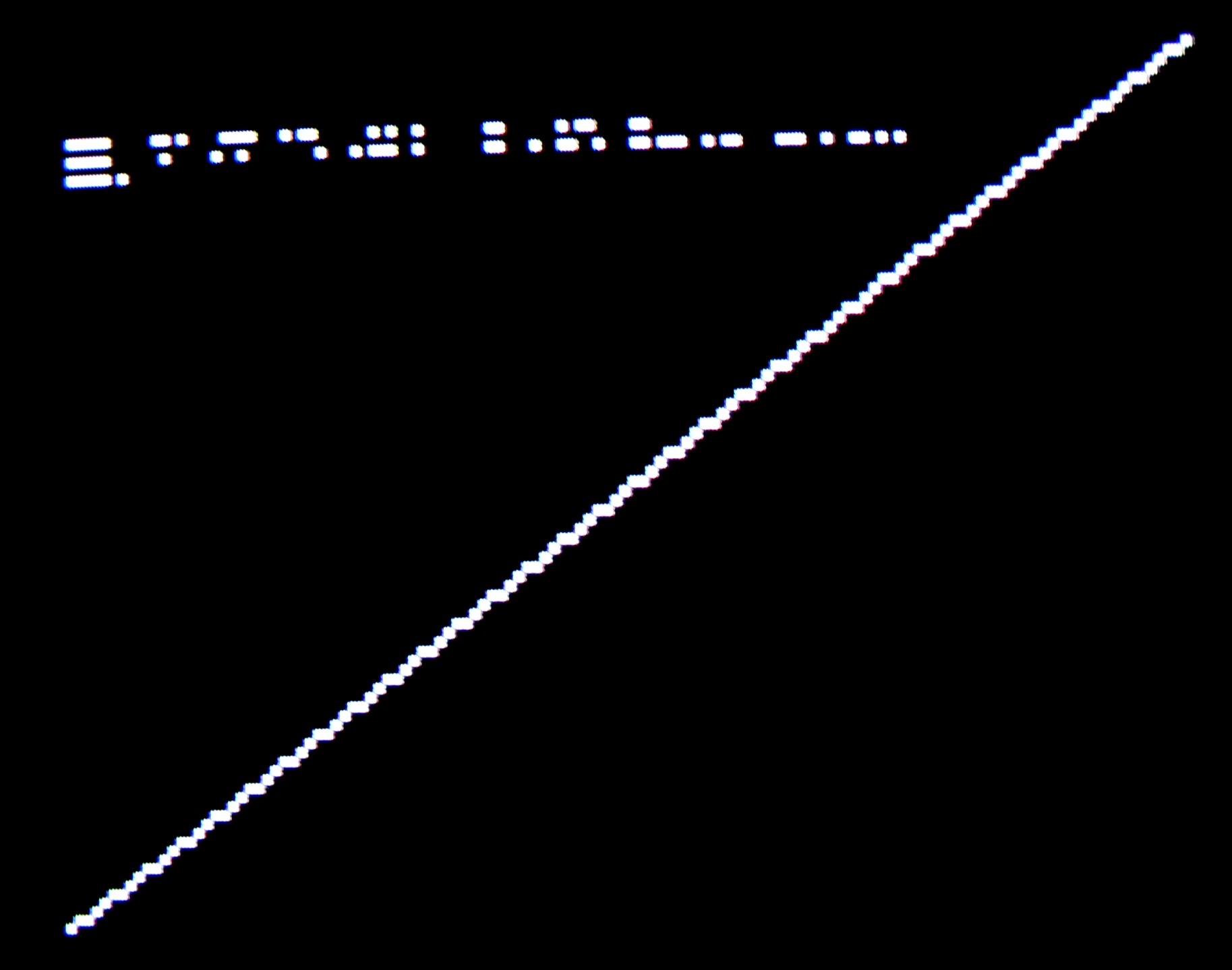

Post by Arlet »
Added support for graphics mode 2 (128x96 monochrome bitmap). The weird stuff to the left of the diagonal line is text because I entered the commands interactively. The screen memory for the text overlaps the memory for the graphics, so the text characters show up as bitmap graphics.
The Atom has 9 graphics modes: one text/semigraphics, plus 4 monochrome graphics, and 4 color graphics modes. This mode 2 was easy to add, because it only uses 1.5kB of memory, so everything fits in one block RAM that I already had for the text mode. I'm planning to put the video memory in external SRAM, but this was easier for a quick test.

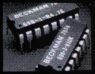

Now fetching video data from external SRAM instead of internal block RAM. Picture resolution is 256x192, which is the highest that the Atom supported. Monochrome only. Back in the days, this took about 4 minutes to load from cassette tape... or 1 minute if you had the extension EPROM with fast tape routines :)
MichaelM
Posts: 761
Joined: 23 Apr 2012
Location: Huntsville, AL
Re: 6502 Sandbox
Post by MichaelM »
Pretty neat.
You really know you've been around electronics too long when you recognize DIP resistor packages such as those in your image.
Michael A.
Arlet
Joined: 16 Nov 2010
Re: 6502 Sandbox
Post by Arlet »
I got the image from this collection. I didn't realize they were resistors, but now that you mention it, I can see the 4.7K and 10K markings on there. Funny to think that those huge DIP packages were once used as convenient space savers.
Re: 6502 Sandbox
I expect it was really more about saving work and reducing manual-stuffing errors, and easing inspection. When we were still doing thru-hole, I was packing 1/8W resistors in tighter than that in our designs. It was one of the things that held our competition at bay. I do have a bunch of surplus resistor DIPs and SIPs here though. I did use a few SIPs to increase density.
bogax
Posts: 250
Joined: 18 Nov 2003
Re: 6502 Sandbox
Post by bogax »
I expect you're correct.
We used SIPs to save space.
But they also made (make?) special purpose
networks with matched resistors (binary ladders
and stuff)
