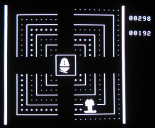

Screen shot from Acornsoft game 'Dodgems'. Works in graphics mode 4.
The game itself doesn't work. I guess because it's directly reading the keyboard matrix, and that's not supported in my hardware model because I only have a serial port right now. That's why I'm planning to add a USB interface in rev2.

Hmm.. I was thinking I can emulate a true keyboard interface using some software help on the PC side. I could make a small PC program that captures raw keyboard events when a key is pressed or released, and translate these events to a byte (1 bit for press/release, 7 bits scancode), and send that over the serial interface to the sandbox board. The FPGA can then decode the events and present an accurate I/O interface for a keyboard matrix on the 6502 bus.

I've implemented the keyboard matrix emulation, and now I'm running with unmodified Atom ROMs. The Dodgems game also works now.
The Atom had very poor keyboard support. No n-key rollover, so you have to type slowly and in staccato fashion, otherwise it would skip the keys. Another problem is that the Atom keyboard layout does not match a modern PC keyboard. Not only are there different keys on there, but some keys are also in strange places, or work differently when combined with 'shift'. This is a tricky problem because for games you'd like to have the keys mapped based on position, but for text entry, you'd like to have the keys mapped according to meaning.
