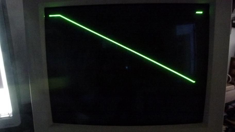

I have made some progress. I see the value in the >>1!
I've tested the Hplot and made the Vplot intuitively. I wish I could say for the most part it works, but it doesn't for some reason. I will have to experiment more... What got me on the right track was when I was trying to do a line from (10,10)to(300,15). The code has changed quite a bit since the last post. One note: when I make y1=40, things do not work as expected. More testing needed.

If num >= denom, you don't want to reset num to the initial value. You subtract denom from it and increment the integer portion.
1 + 7/6 -> 2 + 1/6

OK! now we get down to the nitty gritty so to speak. I did this modification to the Hplot_state in my previous code based on your advice WF. The output was identical to my last pic too. A step in the right direction I think...:

The body of your code generally looks right, but your comments don't match what's going on with dx, dy, and the fraction. I'll leave that to you.
Does the line get drawn onscreen where you expect it to, and the only problem is that it's repeated?
What goes on that the end of the loop? countflag seems to be the only thing that ends the line drawing, and that's externally controlled. At the end of your plot state, you reset the coordinate; I could imagine that if for some reason only the y-coord was reset but not the x-coord, that it would continue re-drawing the line to the right as the picture looks, since the outside world has no indication of when the line is done. WE is also never touched and might be kept asserted somewhere, continuing to draw in some unwanted state.

I had only minutes to change the code and test it out. It looked very similar, if not the same, to the pic I posted on the 28th. Tonight I can try different coordinates. It does appear to be correct, however I am getting away with something regarding writing and reading from the BRAM, because in simulation I see X's coming out. I had started to experiment with adding a WE signal, but stopped short after it appeared it was working correctly.
I am unsure why it is repeating, but it may have something to do in the other module where it reads from the BRAM and plots the coordinates.

White Flame wrote:
... countflag seems to be the only thing that ends the line drawing, and that's externally controlled....
This was a clue! I removed it from the state machine and the plotting is much better! :D I was very surprised at this. Now very many different coordinates appear to be working, except when dy>dx.

always @(posedge clk108)
if ( vblank & vsync )
	state <= init_state;
	else
		case (state)
			init_state :
					state <= prep_state;
			prep_state :
					if ( dx > dy )
						state <= Hplot_state;
					else
						state <= Vplot_state;
			Hplot_state :
				if ( !countflag )
			Vplot_state :
				if ( !countflag )
		endcase
always @(posedge clk108) begin
case (state)
init_state:
	begin
		x0 <= 20;
		y0 <= 20;
		x1 <= 500;
		y1 <= 400;
		dy <= y1 - y0;						// CPU sending coordinates must follow y1>y0
			if ( x0 > x1 ) begin
				dx <= x0 - x1;
				sx <= 0;						// negative "/" slope, sx=0
			end
				else begin
					dx <= x1 - x0;
					sx <= 1;					// positive "\" slope, sx=1
				end
	end
prep_state:
		if ( dx > dy )
			num <= dy;
			else
				num <= dx;
Hplot_state:								// dx/dy=(x1-x0)/(y1-y0).  Hplot_state when dx is larger than dy
		if ( y0 < y1 ) begin
			X <= x0;							// output pixel coordinates to BRAM
			Y <= y0;
			num <= num + dy;				// keep plotting on same raster line...
			x0 <= sx ? x0 + 1 :
						  x0 - 1;
				if ( num >= dx ) begin	// ...until (dx/dy) > 1
					num <= num - dx;		// reset num
					y0 <= y0 + 1;			// next raster line
				end
		end
		else begin							// at end of line (y0=y1) reset origin
			x0 <= 20;
			y0 <= 20;
		end
Vplot_state:
		if ( x0 < x1 ) begin
			Y <= y0;
			X <= x0;
			num <= num + dx;
			y0 <= y0 + 1;
				if ( num >= dy ) begin
					num <= num - dy;                                                                                                                            ;
					x0 <= sx ? x0 + 1 :
								  x0 - 1;
				end
		end
		else begin
			x0 <= 20;
			y0 <= 20;
		end
endcase
end
endmodule
The y1 value does not reach to where it should. More experimentation tomorrow...
