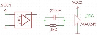

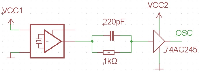

BTW: When running the oscillator and the SBC from different power supplies,
and they both are not powered up at the same time,
another trick for limiting the current that goes through the OSC line from oscillator to SBC
could be something like this:

Regarding the VFO, does the circuit above have the ‘245 without power if VCC2 is down? I thought that might present the same problem Dr Jefyll described, where the VFO tries to supply power. Another idea is having an AND gate, powered by VCC1, with one input being the VFO output and the other VCC2, with a large value pull-down. That way, if VCC2 is down, the pull-down prevents the pin from floating and the AND get will keep the output low. Does that work?
to prevent the VFO output driver and the '245 input protection diodes from being damaged.
Of course, the resistor plus the '245 input capacitance would form up a low pass filter,
and that's why I had added that 220pF capacitor in parallel to the resistor (a smaller capacitor probably would do)
to make sure that the edges of the clock signal at the '245 input would stay "nice and clean".
...Especially if VCC1 > (VCC2 + 0.3V) by accident, like when VCC1 powers up before VCC2.

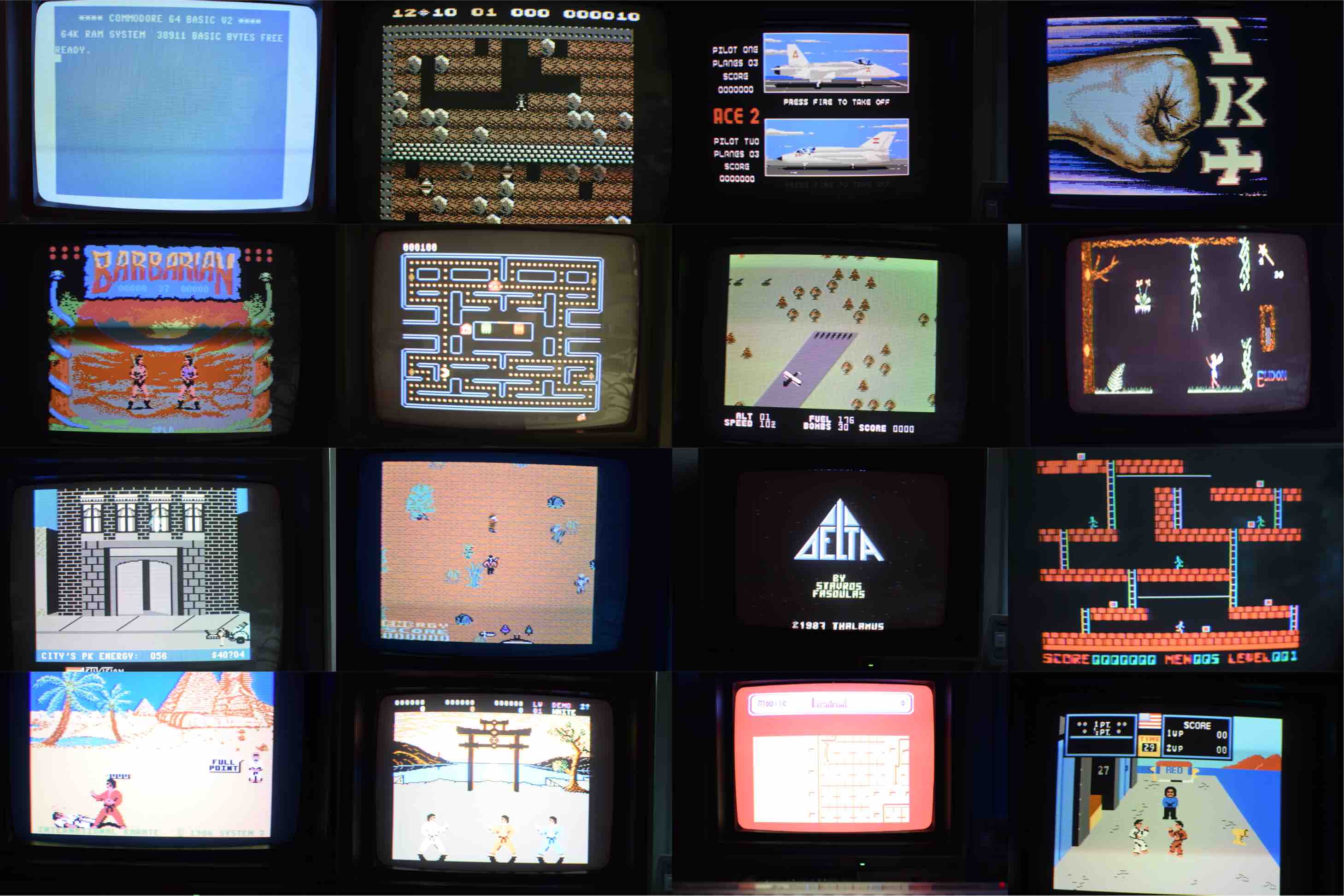

Thanks for the suggestions Dieter. Some good info to work with. I went ahead and got a C64 with a SID chip in it so I could be a little more thorough in the testing. It seems to work perfectly, so far as I can tell, so I was ready to get started with some trials.
The basic functions in the TTL CPU work, so it stands to reason that lots of games should work as well. I still found the whole thing amazing nevertheless -- every successful run of a new game put a smile on my face:
But, there were problems as well. Some of these games push the limits on the C64, and there are lots of subtle tricks being used. It's going to be fascinating to explore the extent of compatibility here. For the actual tests, I used the list of games from FPGA64 above, various other titles, and a list of “best of” titles from one of those showcase YouTube videos. Here now are the results so far:
Some classics and others
Defender — OK
Pac-Man —OK
Pole Position — OK
Space Invaders — OK
Galaga — OK
Pit stop 2 — OK
Rambo — OK
Last Ninja II — OK
Ghostbusters — OK
Kickstart — OK
Commando — OK
Neoclyps — OK
Metroblitz — OK
Mody Dick — OK
FPGA64 list
(http://www.syntiac.com/fpga64.htmll)
ACE2 — OK
Barbarian — OK
Bluemax — OK
Delta — OK
Elidon — OK
Karateka — OK
KillerWatt — OK
Paradroid — OK
IK+ — Runs but crashes
Impossible Mission — Runs but hangs
"Best of" from YouTube
(https://youtu.be/ZLHhyI35Dgw)
1983: Lode Runner — OK
1984: Boulder Dash — OK
1986: Legend of Kage — OK
1987: International Karate — OK
1987: Maniac Mansion — OK
1987: Barbarian — OK
1987: Last Ninja — OK
1987: California Games — Runs but title screen loops ???
1987: Bubble Bobble — Runs but title screen loops ???
Definitely mixed results, but not bad at all for a first go! I've omitted from the list several titles that I either I don't have, or that were flaky (i.e., the games also had problems with the 6510 installed, I'll need to track down reliable versions of these and try again). As for the problems, I’m not altogether sure how to proceed. Are the issues related to cycle-accuracy, timing, illegal opcodes, ??? No idea! I'll have to think about some strategies to investigate. Any and all suggestions welcome on that score.

GaBuZoMeu wrote:
The idea of comparing the TTL-CPU against the 6510 sounds logical - but I suspect it could become a signal quality nightmare
That's why I'm not sure if it's a good idea and suggested to test the concept with two 6510 chips first.
Ideally it could detect any of several illegal instructions. Failing that, the TTL CPU's microcode could be adapted for the job.
But with a different microcode and a little bit of creative tinkering, maybe those 8 additional address lines could be turned into signal outputs for debugging instead...
Problem is, that the microcode PROMs are only one time programmable, and extracting them out of the PCB too often won't be fun because their PLCC sockets
certainly are not designed for this.

GaBuZoMeu wrote:
Just a silly thought.

The NMOS RDY behaviour, only stopping on reads, is certainly relied upon by some extremely tightly-written C64 code which requires cycle-accurate timing. The RDY signal is manipulated by the VIC-II during "bad lines" of the video scanout, and some software is known to rely on the write-RDY interaction to fine-tune their synchronisation with the VIC-II. This is necessary for certain effects involving changing the VIC registers mid-scanline.
Re: TTL 6502 Here I come
Thanks for the info, that's helpful !
So tinkering with the RDY circuitry in the TTL CPU for making it more NMOS 6502 compatible should be tried first.
From the list of games tested with FPGA64, IK+ had worked.
On the TTL CPU, IK+ had failed.
So if tinkering with RDY won't bring results, another idea would be digging into the VHDL code of FPGA64...
