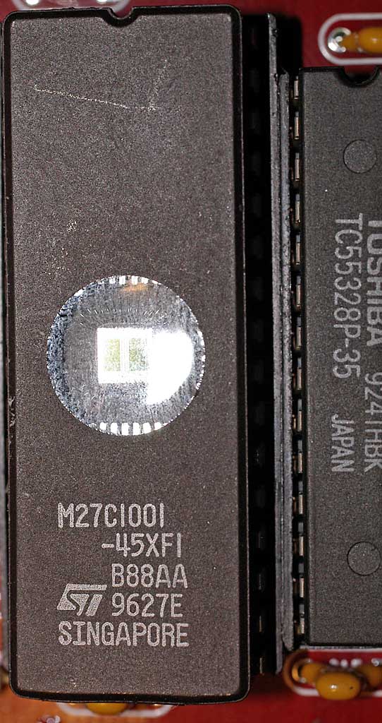

55ns is pretty fast. There are 45ns EPROMS that might help. I've only found 128MB versions, but honestly have not looked at anything bigger.
I'm using the 45nS jobs in my project and they are running happily at over 16mHz. Something begins to fail at 16.7mHz, and I'm fairly sure it's the EPROM. Anyway, if it helps they are ST M27c1001-45XFI units.
I'm using the 45nS jobs in my project and they are running happily at over 16mHz. Something begins to fail at 16.7mHz, and I'm fairly sure it's the EPROM. Anyway, if it helps they are ST MC271001-45XFI units.
I did a search for ST MC271001-45XFI and came up empty. What is your source for them?
I do have some Atmel 27C256 PROMs that are rated for 45ns. POC V1.1 will boot at 15 MHz with one of them, but the SCSI hardware can't keep up at that clock rate. So even if a faster ROM would help I still have to accommodate slow I.O hardware.

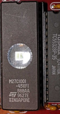

I got them on eBay back in January from a vendor called: xiaobao_semi http://www.ebay.ca/usr/xiaobao_semi?_tr ... 2749.l2754
He doesn't seem to have any left at that speed, but other vendors on eBay do.
I also got the number wrong - they are M27C1001-45XFI - sorry about that.

BillO wrote:
It's an obsolete part, according to ST Microelectronics, and also is not adaptable to POC V2, due to differing package sizes.
