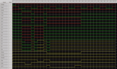

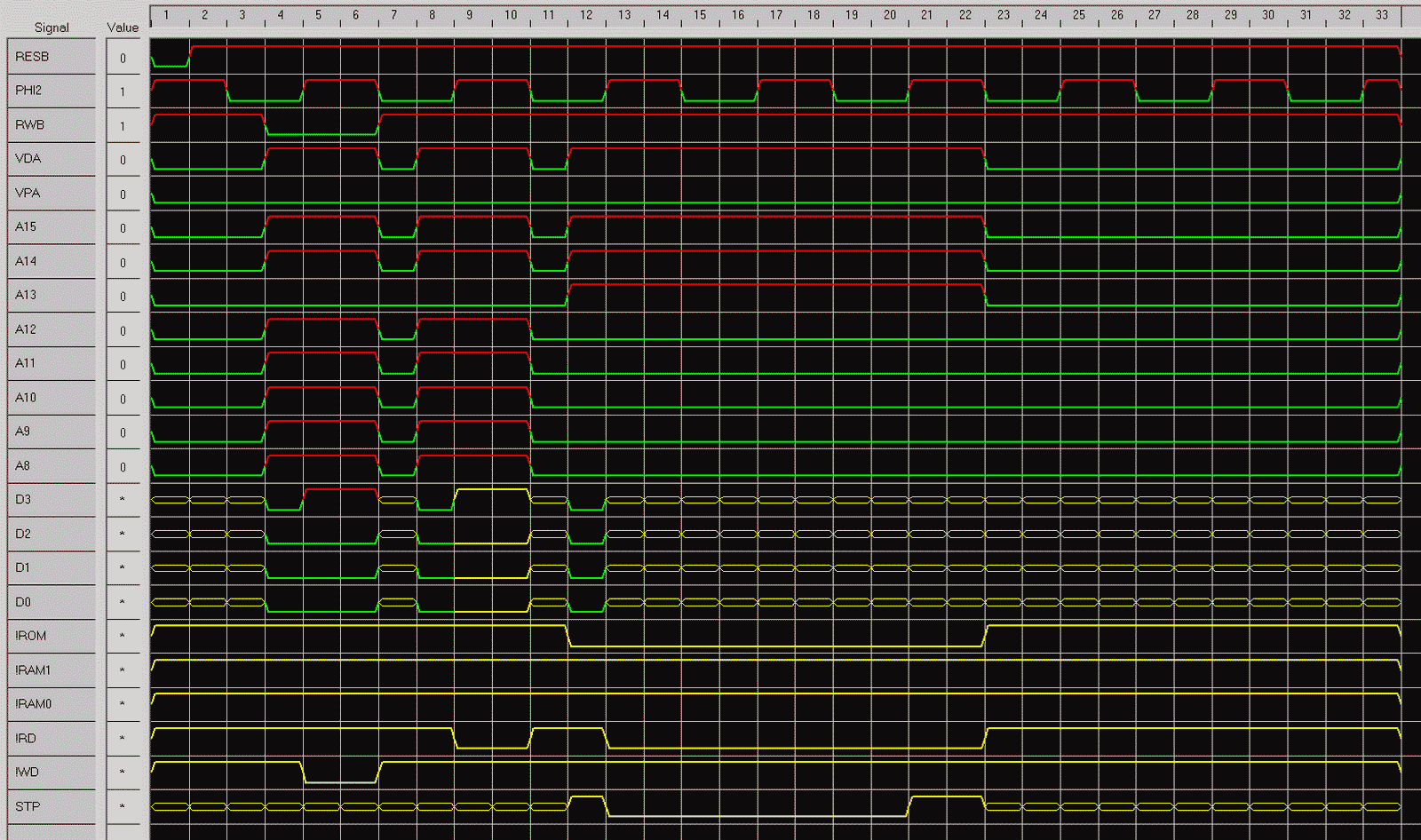

The logic I am using in POC V2's CPLD pulls RDY low as soon as the CPLD recognizes that the '816 is emitting a valid address (VDA || VPA is true) and the address corresponds to ROM or the I/O block. The actual high-to-low transition of RDY occurs on the rise of Ø2. At the expiration of the wait-state period the low-to-high transition of RDY also occurs on the rise of Ø2. Hence timing requirements should be easily met.
Here is the wait-state simulation for POC V2.0's CPLD:
File comment: POC V2.0 Logic Simulation: Wait-State Test
The wait-state starts at vector 12 when the address $00E000 is put on the bus, that address corresponding to high ROM. Recall that the '816 generates a valid address about midway through Ø2 low. So the CPLD "knows" about the address while Ø2 is still low and thus "knows" that a wait-state is going to be needed. Hence at vector 12 the CPLD pin STP, which drives RDY (see bottom trace in the graph), is switched from high-Z to active, which means the CPLD is now driving RDY high—RDY is also pulled up to Vcc through a 3.3K resistor.
At vector 13, the CPLD drives STP low, pulling RDY low and starting the wait-state. Vector 13 is at the rise of Ø2, so the logic easily meets the tPCS setup deadline mentioned by Jeff, as well as the tPCH hold time. The MPU is halted and if one can believe the data sheet, the address bus, VDA, VPA and RWB will remain unchanged. Furthermore, the data sheet indicates the MPU will internally freeze in the Ø2 high state (which infers a wait-state could also be produced by simply halting Ø2 during the high phase—not something I've ever tried, but technically feasible with the POC design).
At vector 21, the wait state expires and the CPLD drives its STP high, a procedure that assures RDY will rapidly return to the high state, regardless of the effects of parasitic capacitance. The data sheet says that with RDY returned high the MPU will resume execution on the next fall of Ø2, which would occur at vector 23. Again the tPCS and tPCH setup and hold times, respectively, would apply. Also at vector 23, the CPLD is done with the wait-state and returns the STP output to high-Z, leaving the pullup resistor in charge of keeping RDY high.
According to Jeff's description, at vector 24 the MPU would either start the next step in the current instruction or enter the opcode fetch phase of the next instruction.
During the wait-state, it is necessary to keep both the ROM's /CS (chip select) and /OE (output enable) control inputs stable. You can see that ROMSEL (ROM select), which is connected to /CS, is asserted at vector 12 and /RD (read data), which is connected to /OE, is asserted at vector 13 (rise of Ø2). Both signals are kept in that state all the way through vector 22.

Perhaps it is too early morning for me, but the two timing diagrams presented shows a two cycle delay. The given schematic from Daryl would produce a one cycle delay. According to the circuit RDY would went low on the rising edge of PHI2 and went high on the next rising edge of PHI2 regardless of the state of WS_EN.
Both timing diagrams shows a RDY signal that went low with the rising of PHI2 but then stays low the next rise of PHI2. This would cause RDY=0 to the CPU 2 times, not one.

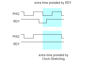

[...] a wait-state could also be produced by simply halting Ø2 during the high phase—not something I've ever tried, but technically feasible with the POC design).
Yes, that's right. For our purposes the following scenarios are exactly equivalent.
BillO made much the same point; sorry I failed to acknowledge this. Guus Assmann also makes a good point. The CPU is fully static, and can be clocked at a very slow pace. That kind of debugging might be the best way to find out what's happening, BDD -- it bypasses the communication challenges that can arise when trying to unravel things by committee on the forum. Maybe the best thing is a "committee" of just one person, :wink: charged with reviewing (and verifying) exactly how the CPU and CPLD are supposed to interact. Have fun, and keep us posted!
Correct. I added a second flop, which in turn, added a second cycle to the wait-state.
