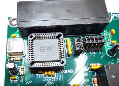

POC V1.3 Serial I/O Hardware
Like V1.2, V1.3 has four, high-speed TIA-232 ports, with a pair of NXP 28L92 DUARTs acting as a virtual QUART—the driver is the same as in V1.2. A change I made to the serial I/O circuit was to replace the two MAX238 transceivers used in V1.2 with a single MAX248. Although the combination of a single MAX248 and its socket (PLCC44) costs slightly more than a pair of MAX238s in SOIC, the MAX248 requires only four charge-pump capacitors to handle all four channels, whereas the MAX238 pair required eight total. Also, I can easily solder a PLCC44 socket, as the pins are on a 100×100 mil grid. Soldering anything SMT has become very difficult for me.
