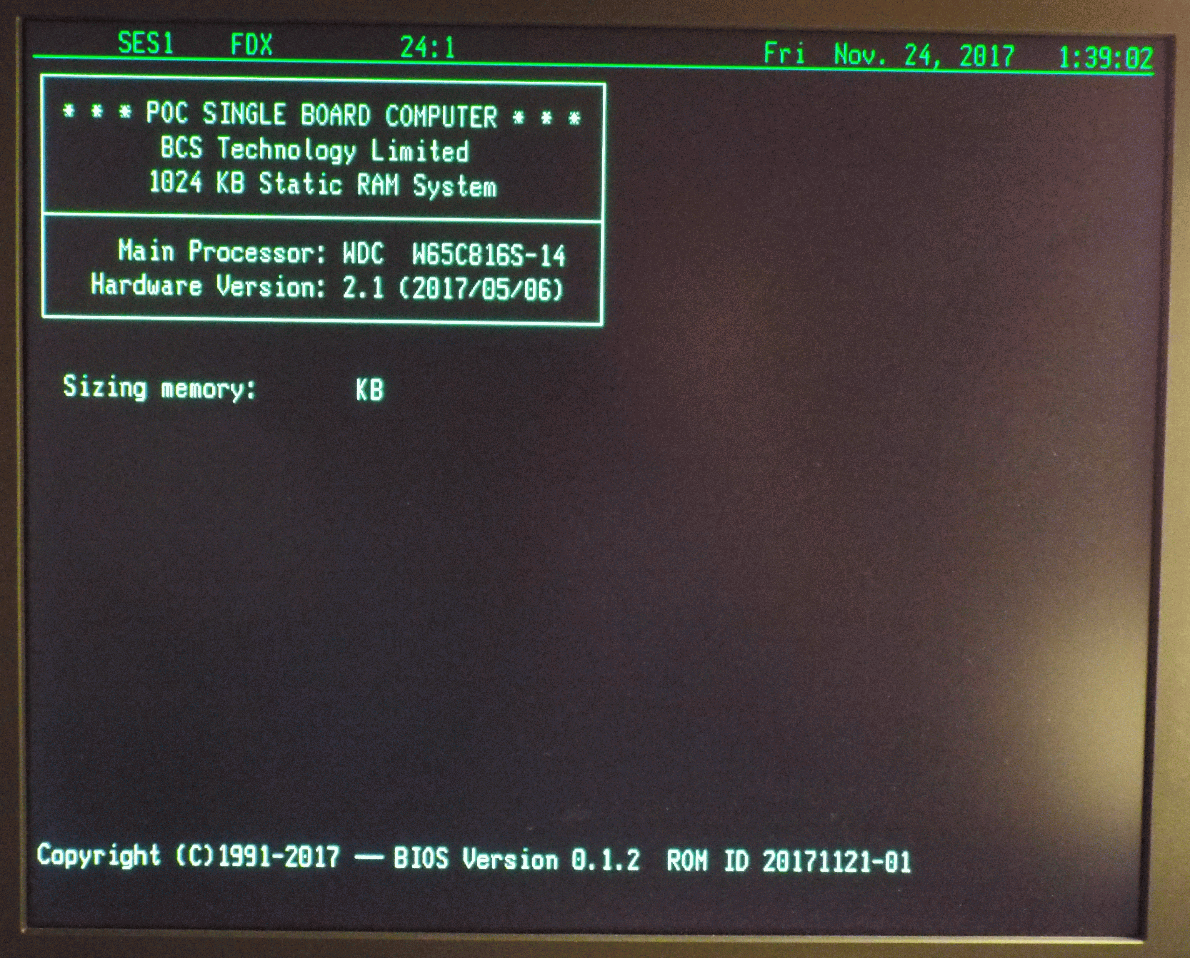

POC VERSION TWO: Progress
A little more progress. I've got interrupt-driven serial I/O working and can print the POST banner to the console.
POC V2.1 Banner Display
POC V2.1 Banner Display Closeup

BTW, I/O works on serial channels A, C and D at 115.2 Kbps. I brutalized the unit by writing a short program that was driving channels C and D at the same time, filling the screens with test phrases that were unique to each channel. It was interesting watching the /IRQ circuit while that was going on. :shock: I haven't tried driving A, C and D simultaneously because I only have two terminals with which to test.
I won't be able to test channel B until the firmware is finished, as that channel is wired to interconnect to one of my Linux boxes for software transfer. Much of the firmware can be "imported" from POC V1, with changes to adapt to POC V2's architecture. I'm particularly eager to see how the monitor will work with all that additional RAM.

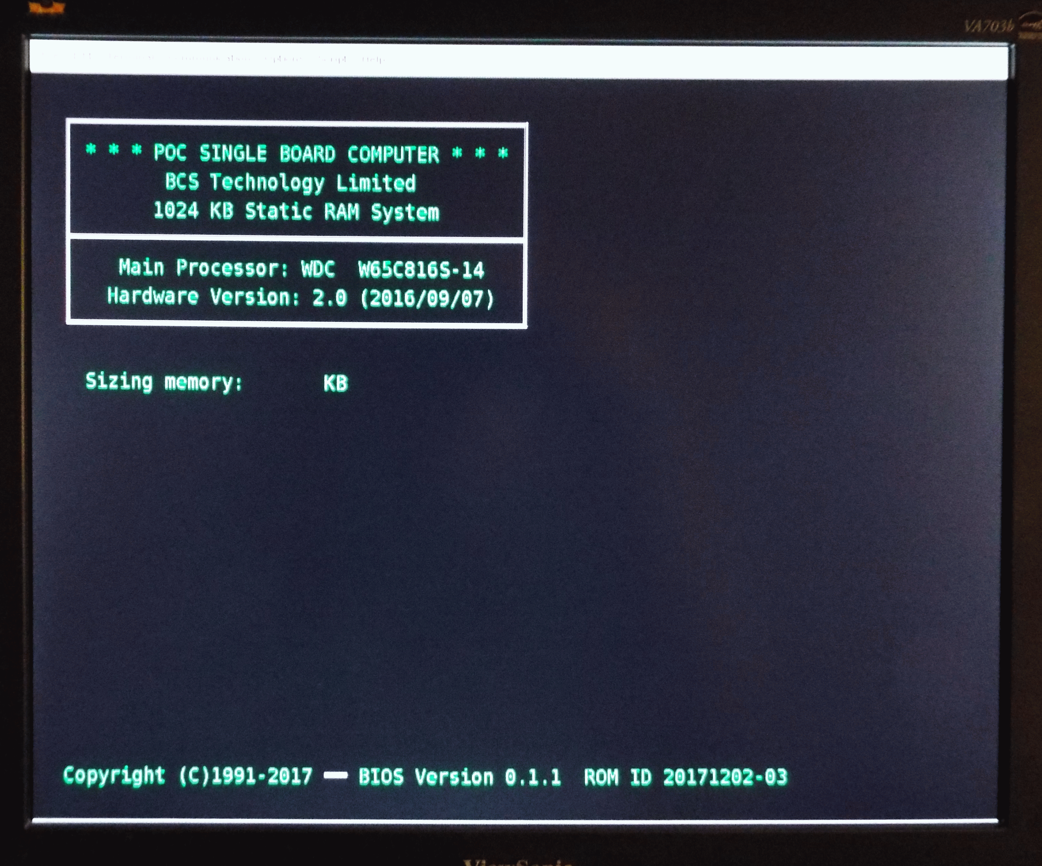

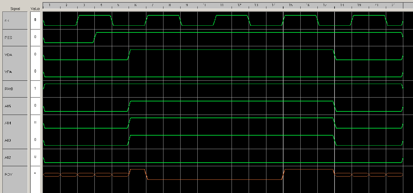

Hmm...I seem to have a problem with V2.1's programmable logic. The function that maps out ROM and exposes RAM at the same address is not working as it should. The test was to "shadow" ROM at $00E000 into RAM at the same address. The logic is supposed to automatically direct a write on an address where ROM is exposed into the RAM at the same address, a feature that I had verified in POC V2.0. In 2.1, shadowing fails and if the HMU (hardware management unit) is told to map out ROM in the $00E000 range and expose RAM, the machine crashes. The CUPL code that I developed for the CPLD correctly simulates and if I read the CPLD after programming, it exactly matches the JEDEC fuse map from which it was programmed. 'Tis a strange problem.

Posts: 9425

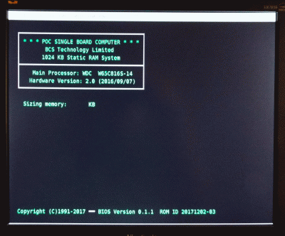

POC VERSION TWO: V2.0 Update
You may recall I couldn't seem to get interrupt-driven serial I/O working with POC V2.0 and decided to shelve V2.0 and take off in another direction. This wasn't to say that I hadn't continued to think about why V2.0 was being so obdurate. A few months ago, I had finally figured out the mysteries of the 28C94's interrupt "bidding" system, which is inadequately documented in the QUART's data sheet. What was helpful was reading the data sheet for the SC28L194, which is also a QUART with interrupt bidding. The description is more lucid and helped me "connect the dots."
As I have a significant hardware bug in V2.1 that is doing a good job of being elusive, I decided to set that unit aside for a while (usually a period of "inattention" results in me figuring out the problem) and see if I could get interrupt-driven serial I/O (SIO) working on POC V2.0. I was confident that I finally understood the QUART's interrupt bidding setup well enough to make it work. Yet I still couldn't get things going. As soon as a write to the console channel (channel A in the QUART) occurred, /IRQ would go low and stay there, and the machine would crash. Clearly the MPU wasn't able to service the IRQ, and I knew to a certainty at this point that the hardware itself was working as designed. It had to be something else that I was overlooking. The solution was to be found by examining the SIO driver code for POC V1.1, which had been used as a test bed to prove the theory behind my "vectored" driver that could be scaled to as many SIO channels as could be built into a system.
The vectored driver consists of a set of foreground routines for sending and receiving datums, and a interrupt handler for driving the UART. As there are multiple channels to process, there is a set of direct (zero) page pointers that point to the relevant chip registers and the circular FIFOs (CFIFOs) maintained in RAM for temporarily holding incoming and outgoing datums. Registers and CFIFOs are selected by passing a zero-based channel index to the driver code. Ultimately, (<dp>,X) addressing is employed to read and write registers and CFIFOs, in which the value in .X is the channel index times two. It's typical 6502 programming.

This technique was tested on V1.1 and V2.1, and worked without a hitch. It should have worked on POC V2.0 as well, but all sorts of bizarre things would happen when SIO was attempted.
Within the firmware is a set of tables that is used to populate the direct page pointers during POST. I don't know why, but my attention got focused on the the source code used to produce those tables and in it, I found an error that resulted in some data being transposed. Cheerfully assuming that fixing that error would fix V2.0, I copied the table code I had used in V1.1's firmware over to V2.0's source file. Following assembly, burning a ROM and flipping on the power, I was greeted with the following display on the console screen.
POC V2.0 POST Screen Display
The above proved that interrupt-driven SIO was working. Also, I have a 100 Hz jiffy IRQ running for timekeeping, which was verified by putting some gratuitous time delays into the code and determining if the delay period was about right.
So it looks as though I'm back on POC V2.0 for a while. :?

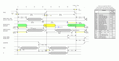

I have been cogitating about an apparent hardware/logic flaw present in both of my POC V2 designs, one that may be contributing to instability. It all may be due to an oversight on my part concerning how the 65C816 behaves when RDY is brought high following a wait-state. In fact, I believe that past presentations on how to properly wait-state the 65C02 and 65C816 may be flawed for the same reason I'm having trouble. I'm going to elaborate a bit and see what sort of response I get from the others here. I'll focus on the '816, but this should be applicable to both MPUs.
First, here's the 65C816 timing diagram as redrawn by Dr Jefyll. Unlike the WDC version, Jeff's is proportionate to the passage of time during a machine cycle.
65C816 Timing Diagram (by Jeff Laughton)
Of interest is the timing for IRQB, NMIB, RESB and RDY. Note that none of these inputs is sampled until the fall of Ø2, assuming setup time is observed. Therefore, a wait-state cannot actually begin until the fall of Ø2. Less clear is the fact that a wait-state cannot end until the fall of the Ø2 clock, which is briefly mentioned in the description of the RDY pin in the 65C816 data sheet:
  • 2.24 Ready (RDY)
    The Ready is a bi-directional signal. When it is an output it indicates that a Wait for Interrupt instruction has been executed halting operation of the microprocessor. A low input logic level will halt the microprocessor in its current state. Returning RDY to the active high state releases the microprocessor to continue processing following the next PHI2 negative transition....
There is some ambiguity in the above. What exactly is meant by the "...the microprocessor [continues] processing following the next PHI2 negative transition" statement? Is the data sheet saying the MPU will resume completion of the current instruction on the next fall of Ø2, or is it saying the MPU would move on to the next instruction on the next fall of Ø2? All along, I assumed that the latter would happen. However, now that I have two pieces of hardware with wait-stating capabilities that are misbehaving in the same fashion, I'm thinking the former interpretation of what happens when RDY is returned high is correct.
Assuming I'm not off the rails with this, what this means is the glue logic has to not only release (or drive high) RDY at the desired end of the wait-state period, it has to maintain all logic conditions that existed at the start of the wait-state period for an additional Ø2 cycle after the expiration of the wait-state. This is because the MPU will not complete the wait-stated operation until the completion of that following Ø2 cycle.
Again, assuming I'm understanding this as I should, the wait-state logic I concocted for POC V2 would seem to be wrong. The logic is based upon a simulation I did using a GAL, which design had came from a discrete circuit that 8Bit (Daryl Rictor) had presented in December 2010:
Discrete Wait-State Circuit
The simulation of the GAL version (also by Daryl) of the discrete circuit looked like this:
Wait-State Simulation
The above appears to be correct, but to my revised thinking, is not. The flaw in the logic would be at vector 18, which is when the wait-state period has come to an end. Although RDY (bottom of the graph) returns high at vector 15, the MPU doesn't actually restart until at vector 17, coinciding with the fall of Ø2. However, the logic's assumption at vector 18 is the event that required the wait state is over and the MPU has moved on to the next instruction. I don't believe this to be the case, which would mean the glue logic would no longer agree with what the MPU is up to.
Opinions?

It seems to me if the CPU was in a write cycle it may have just completed an instruction when Phi2 goes low and the asserted /RDY takes effect. In which case I would expect the CPU would move on the next instruction when /RDY is released and Phi2 goes low again. However, if it had just fetched an opcode or was part way through a multi-cycle instruction when halt takes effect, I would expect it to continue with that last instruction once the halt is over.
It seems discarding a partially executed instruction could end up corrupting the stack or something else, leaving it in a unknown or unwanted state. Or am I crazy?
Posts: 9425
Re: POC VERSION TWO
Therein lies the confusion. I reevaluated my thinking based on the following conditions:
  1. The MPU is in the opcode fetch stage of the instruction.
  2. The address placed on the bus is ROM and hence needs a wait-state.
  3. The MPU maintains the state of the address bus, as well as RWB as long as RDY is low (also VDA and VPA in the '816) so glue logic conditions remain stable for the duration of the wait-state.
Obviously the MPU can't move on to the next instruction at the expiration of the wait-state, since it hasn't finished the current instruction. So just what does it do when RDY returns high and Ø2 goes low again?
