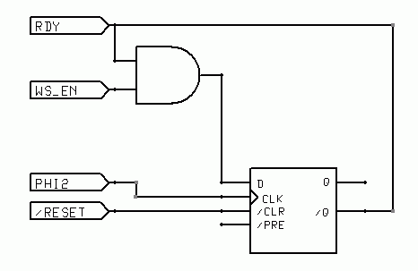

Hmm...I seem to have a problem with V2.1's programmable logic. The function that maps out ROM and exposes RAM at the same address is not working as it should. The test was to "shadow" ROM at $00E000 into RAM at the same address. The logic is supposed to automatically direct a write on an address where ROM is exposed into the RAM at the same address, a feature that I had verified in POC V2.0. In 2.1, shadowing fails and if the HMU (hardware management unit) is told to map out ROM in the $00E000 range and expose RAM, the machine crashes. The CUPL code that I developed for the CPLD correctly simulates and if I read the CPLD after programming, it exactly matches the JEDEC fuse map from which it was programmed. 'Tis a strange problem.

MACHINE ARCHITECTURE & HARDWARE MANAGEMENT UNIT DEFINTIONS
           +--------------------------+ $0FFFFF
           |  Extended RAM  (960 KB)  |
   +-------+--------------------------+ $010000
   | HIRAM |       HIROM (8 KB)       |
   +-------+--------------------------+ $00E000
           | Hardware Management Unit |
           +--------------------------+ $00DF00
           |      D8RAM (1.75 KB)     |
   +-------+--------------------------+ $00D800
   | IORAM |       IODEV (2 KB)       |
   +-------+--------------------------+ $00D000
   | LOROM |       LORAM (4 KB)       |
   +-------+--------------------------+ $00C000
           |      BASRAM (48 KB)      |
           +--------------------------+ $000000

I have been cogitating about an apparent hardware/logic flaw present in both of my POC V2 designs, one that may be contributing to instability. It all may be due to an oversight on my part concerning how the 65C816 behaves when RDY is brought high following a wait-state. In fact, I believe that past presentations on how to properly wait-state the 65C02 and 65C816 may be flawed for the same reason I'm having trouble. I'm going to elaborate a bit and see what sort of response I get from the others here. I'll focus on the '816, but this should be applicable to both MPUs.
First, here's the 65C816 timing diagram as redrawn by Dr Jefyll. Unlike the WDC version, Jeff's is proportionate to the passage of time during a machine cycle.
File comment: 65C816 Timing Diagram (by Jeff Laughton)
Of interest is the timing for IRQB, NMIB, RESB and RDY. Note that none of these inputs is sampled until the fall of Ø2, assuming setup time is observed. Therefore, a wait-state cannot actually begin until the fall of Ø2. Less clear is the fact that a wait-state cannot end until the fall of the Ø2 clock, which is briefly mentioned in the description of the RDY pin in the 65C816 data sheet:
    2.24 Ready (RDY)
    The Ready is a bi-directional signal. When it is an output it indicates that a Wait for Interrupt instruction has been executed halting operation of the microprocessor. A low input logic level will halt the microprocessor in its current state. Returning RDY to the active high state releases the microprocessor to continue processing following the next PHI2 negative transition....
There is some ambiguity in the above. What exactly is meant by the "...the microprocessor [continues] processing following the next PHI2 negative transition" statement? Is the data sheet saying the MPU will resume completion of the current instruction on the next fall of Ø2, or is it saying the MPU would move on to the next instruction on the next fall of Ø2? All along, I assumed that the latter would happen. However, now that I have two pieces of hardware with wait-stating capabilities that are misbehaving in the same fashion, I'm thinking the former interpretation of what happens when RDY is returned high is correct.
Assuming I'm not off the rails with this, what this means is the glue logic has to not only release (or drive high) RDY at the desired end of the wait-state period, it has to maintain all logic conditions that existed at the start of the wait-state period for an additional Ø2 cycle after the expiration of the wait-state. This is because the MPU will not complete the wait-stated operation until the completion of that following Ø2 cycle.
Again, assuming I'm understanding this as I should, the wait-state logic I concocted for POC V2 would seem to be wrong. The logic is based upon a simulation I did using a GAL, which design had came from a discrete circuit that 8Bit (Daryl Rictor) had presented in December 2010:
File comment: Discrete Wait-State Circuit
The simulation of the GAL version (also by Daryl) of the discrete circuit looked like this:
File comment: Wait-State Simulation
The above appears to be correct, but to my revised thinking, is not. The flaw in the logic would be at vector 18, which is when the wait-state period has come to an end. Although RDY (bottom of the graph) returns high at vector 15, the MPU doesn't actually restart until at vector 17, coinciding with the fall of Ø2. However, the logic's assumption at vector 18 is the event that required the wait state is over and the MPU has moved on to the next instruction. I don't believe this to be the case, which would mean the glue logic would no longer agree with what the MPU is up to.
Opinions?
PostPosted: Sun May 20, 2018 10:43 pm
Posts: 1007
It seems to me if the CPU was in a write cycle it may have just completed an instruction when Phi2 goes low and the asserted /RDY takes effect. In which case I would expect the CPU would move on the next instruction when /RDY is released and Phi2 goes low again. However, if it had just fetched an opcode or was part way through a multi-cycle instruction when halt takes effect, I would expect it to continue with that last instruction once the halt is over.
It seems discarding a partially executed instruction could end up corrupting the stack or something else, leaving it in a unknown or unwanted state. Or am I crazy?
PostPosted: Sun May 20, 2018 10:54 pm
Posts: 8505
Therein lies the confusion. I reevaluated my thinking based on the following conditions:
  1. The MPU is in the opcode fetch stage of the instruction.
  2. The address placed on the bus is ROM and hence needs a wait-state.
  3. The MPU maintains the state of the address bus, as well as RWB as long as RDY is low (also VDA and VPA in the '816) so glue logic conditions remain stable for the duration of the wait-state.
Obviously the MPU can't move on to the next instruction at the expiration of the wait-state, since it hasn't finished the current instruction. So just what does it do when RDY returns high and Ø2 goes low again?
Last edited by BigDumbDinosaur on Mon May 21, 2018 4:27 am, edited 1 time in total.
