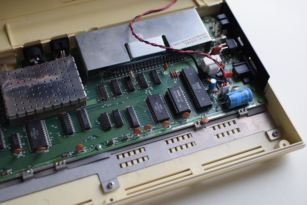

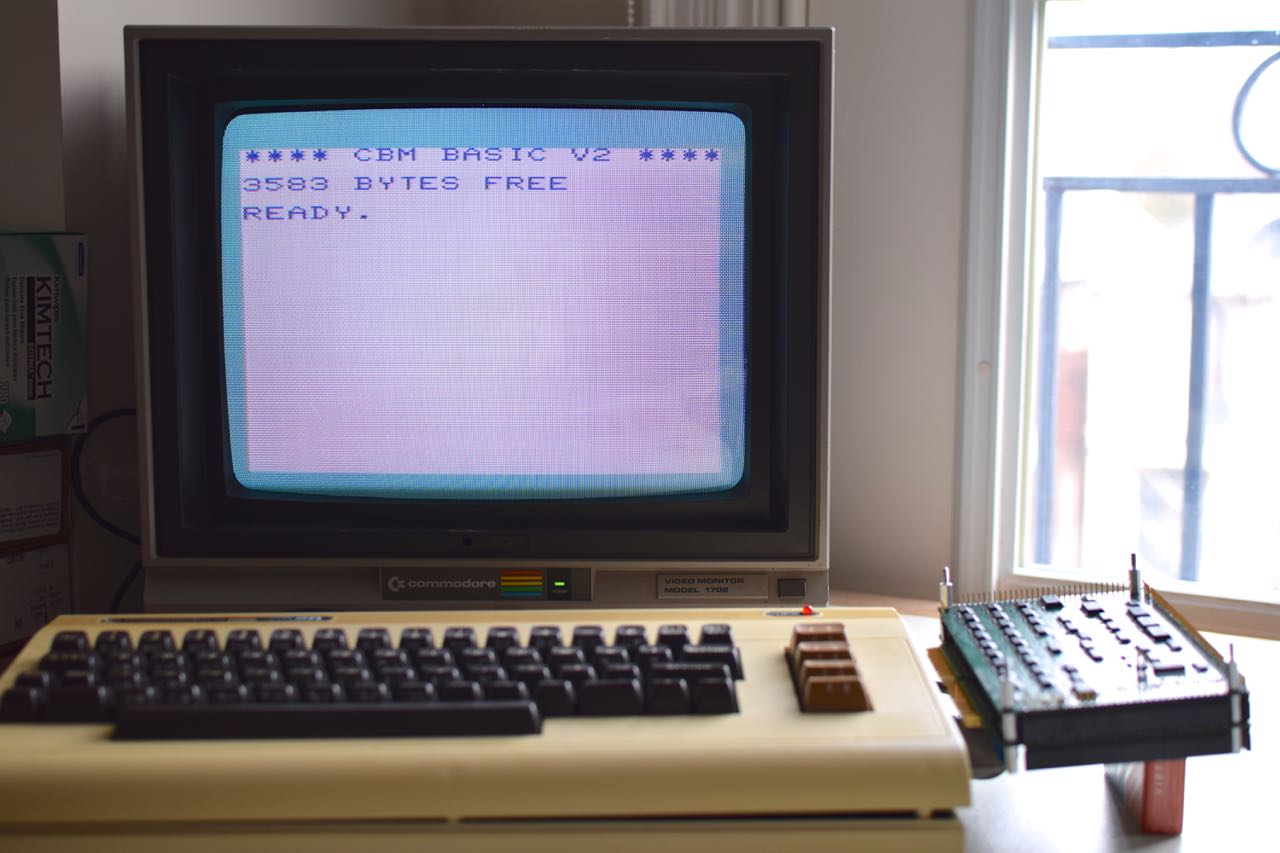

One of the objectives of the project is for the TTL CPU to be "plug-in" compatible with the target processors. So far we’ve managed to replace the WDC 65C02 on the C74-SBC. But it’s one thing to run tests on a purpose-built machine, and quite another to step into the shoes of an original NMOS 6502 in a vintage system! The plan was to start with my VIC 20 and put the CPU through its paces with a first “real-world” challenge!
To get the CPU ready, a couple of ICs needed to be replaced with ACT variants, and the 6510 port disabled. Pin 1 is grounded in the VIC 20, so the /VP jumper must be disabled on the CPU side. Pin 5, on the other hand, is floating on the VIC 20, so it was safe to leave /ML alone. Finally, the TTL CPU has a pull-up on pin 36 for BE, so again it could be left alone. All other pins are as on the 65C02. And so with that, I plugged in the ribbon-cable into the NMOS 6502 socket on the VIC 20, and things we're ready to go.
It was a little nerve-racking to flip the power switch, but after just a moment, the screen snapped on! :shock: Honestly, I was NOT expecting that! That 6502 IC was first installed in or about 1983. Now the TTL CPU sat in its place and the computer knew no difference.
Here are some pics to mark the occasion …
I spent a pleasant couple of hours running some programs and playing various games -- and ne'er a glitch. In the end, I couldn't help but pay a little homage to the original! From 1983 to 2018 - a wonderful 35 year journey. :)

Fantastic! A brain transplant.

Congratulations !
Playing games would be more fun on a C64, of course.
Go, Drass, go. :)

[Wait, what? ... screen is on ... cursor is blinking ... what does that mean? ... must be the CPU ... yes, it's the CPU doing that! ... Wooohooo!] :)
Yeah, I know! And you gotta love how unabashedly impractical it is. I mean honestly, replacing a perfectly good IC with two densely-packed PCBs that only replicate its function -- engineering blasphemy! :lol:
