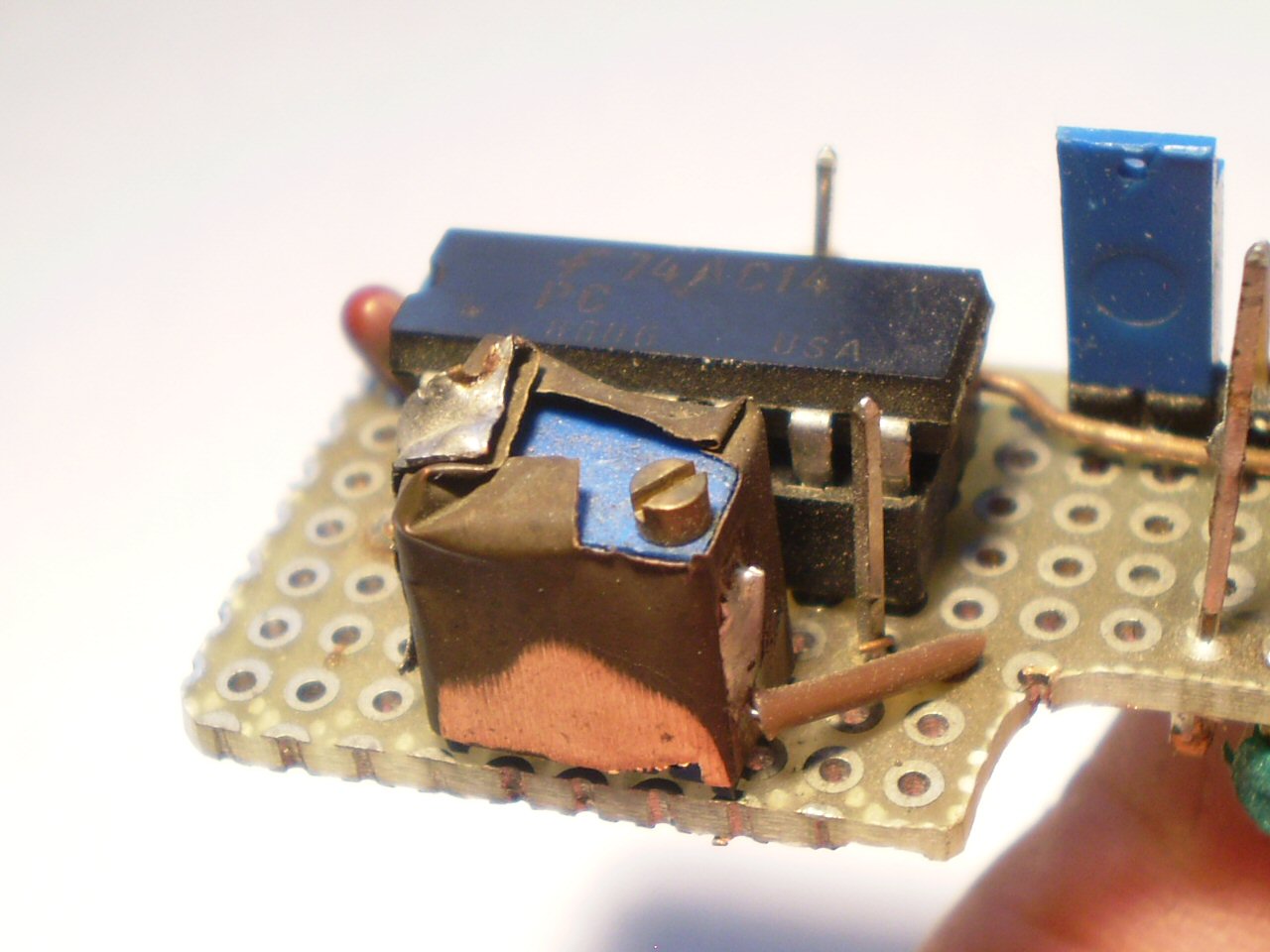

BTW instead of swapping crystal oscillators, you can consider making a variable oscillator that's continuously adjustable with a trim-pot. Here's a photo of one I use for testing KK's 16x clock (ie, 80MHz, plus or minus). It's basically just a 74AC14 and the potentiometer. It uses a single inverter section and an RC. The pot is the R and the gate's input capacitance is the C. (I don't recall what value pot I used.) I shielded the pot with grounded copper foil but that's probably unnecessary, especially if an actual capacitor were in-circuit. And you'd wanna add that cap anyway to lower the frequency.
Edit: another approach (offering different tradeoffs) is to use a fixed-frequency oscillator but feed its output through a PLL-based programmable multipier-divider IC like this:

For home-made VFOs, see also viewtopic.php?p=10619#p10619 and the rest of that topic. (It's linked in the clock-generation page of the 6502 primer.)
IDT_525-01-02_DST_20150330-3.pdf
Thanks for these suggestions! I was already scratching my head wondering about various "divide-by" circuits. This approach is MUCH better and just the ticket. A "VFO" will certainly be required to find the maximum operating frequency, whatever that turns out to be! For now, I'm heads down running tests using a 40MHz oscillator with the divide-by-2 flip-flop in the SBC. All I can say is, it's sure hard to type with the fingers on both hands crossed. :wink:
