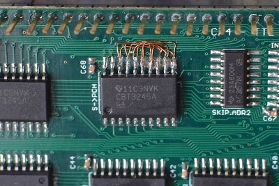

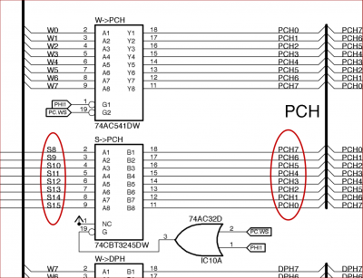

After all the checking and re-checking, it's hard to believe this got through the QA process: :roll:
S->PCH (a 74CBT3245 buffer) carries the result of the 16-bit Incrementer to the high-byte of the PC register, and all eight data lines were going to the wrong pins ... argh! This little mishap had the effect of inverting the bit-order of the high-byte of PC every cycle.
Good thing I picked up some practice patching the SBC. Here is what the afflicted area looked like after some head-scratching and careful rework:
The output pins of S->PCH are lifted off the board, jumpers are soldered to each and then run to the correct pads below the raised pins. I used some silicone to cover the pads after the jumpers were soldered on, and amazingly there were no shorts once the job was complete. The multimeter confirmed all the data line connections are now correct and sound.
With that fix in place, I'm thrilled to report that the CPU passed it's first significant test! It ran a complete reset sequence and then went on to execute NOPs in succession beginning at address $EAEA, two cycles per NOP. Wow, this means that the basic piping is working: reading the data bus, latching into IR, stepping through microcode, incrementing PC. Hurray! :D :D :D
So? Just put a footnote in the datasheet. Any programmer who can't be bothered throwing together a software workaround for a minor glitch like this is obviously lazy or incompetent! :wink:
Seriously, nice work on the patch. Did you consider placing four jumpers on each side of that IC, instead of all eight on one side? It might've been slightly less crowded if the swaps of D0<->D7 and D2<->D5 were on one side and the swaps for D1<->D6 and D3<->D4 were on the other.
Hmm, nice idea ... might have been easier. Still, getting at the pads below alternate pins without touching their neighbours would also be tricky.
