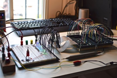

So, onto a setup for initial debugging of the logic:
Connecting the PCBs together with jumpers allows access to the underside of the boards. Flipping them over is hardly comfortable even with this arrangement, but at least touching a logic probe to an IC on the bottom layer without loosing state is actually possible - and pretty much essential to sanity.
The ribbon cables on the left carry the CPU signals out to a breadboard, where a makeshift toggle-clock and control panel now reside. On display currently is the address bus, while the data bus is set to $EA (ready for the inaugural NOP test). Moving the RESET line manually to GND and toggling the clock puts the device into reset. Thus far the reset sequence makes it only to the third cycle before failing; it’s a long way to go yet, but it’s something. Honestly, the first time I saw the internal state counter increment, I was thrilled. It was the first reliable and correct logic operation this unwieldy beast has ever performed, and I could hardly believe it! There is hope yet. :)

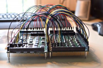

Here is a closer look at the inter-connected boards:

Lookin' good, Drass! :)
Can I presume your makeshift toggle-clock switch is debounced somehow? Just checking. Also, is it the ribbon cables which carry +5 and ground to the CPU boards? Personally I don't trust jumpers for that. I usually take the time to establish soldered power connections, even if it's just a temporary test setting. This is in the "essential to sanity" category you mentioned.
Thanks for sharing the pics, and good luck with the debug!
For some reason, after looking at your contraption this tune is running through my head. :wink:
