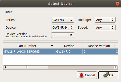

enso1 wrote:
Hoglet: are you sure?
Fairly sure....
enso1 wrote:
But please show me I am wrong -- I would absolutely love a dual ported BRAM!
OK, can you check in the Gowin device selection window that you have the "C" version of the part selected:
With this, in the Place & Route report I'm seeing this:
Screenshot from 2024-08-21 19-20-05.png (5.58 KiB) Viewed 4089 times
There is a total of BSRAM 20 used out of 26 (77%)
SDBP is Semi Dual Port BSRAM (one write port and one read port)
DPB is true Dual Port BSRAM (two independant read/write ports)
This example is from AtomFPGA, where the true dual port RAM is the 8KB frame buffer, hence it using four BSRAMs (16Kbit each).
Now, it turns out in this case I ended up instantiating this using the DPB primitive, rather than inferring it:
https://github.com/hoglet67/AtomFpga/bl ... ram_8k.vhd
I don't remember why, but possibly because trying to infer it didn't work.
But anyway, I'm pretty convinced the device does have dual port BSRAMs, and it's the tools that are being problematic.

I think yosys may not be up to date with the C devices and treat them as plain GW1NR9's. I haven't tried re-synthesising in the GOWIN IDE in a while, and I think i had bogus verilog early on, likely resulting in double BRAMS...
Thank you for clarifying.

Yes, confirmed that GOWIN IDE creates a dual-ported BRAM. I will double-check and open an issue at yosys as it appears that they are not aware of this GW1NR-9C capability.
P.S. My J1 synthesis report show fmax of 72MHz (vs 100MHz with Xilinx Spartan3), and 6% logic, 2% register, and 8 of 26 BRAMS. Not bad.
There is a footnote in the help: https://github.com/YosysHQ/apicula?tab= ... 7301045f7a
Basically, you need to pass
--device GW1NR-LV9QN88PC6/I5 --family GW1N-9C
to nextpnr, and use
gowin_pack -d GW1N-9C
for packing. There are examples that manually use dual-ported BRAM, seems it can also infer them.

I have a verilog J1 system that works when built in GOWIN IDE, but does not work (and shows double the BRAM count) in yosys. I don't like the IDE, but it is also much faster for this project, not to mention it works.
My makefile shows exactly the settings you mentioned, dmsc... Thanks for the link, I will do more digging.
