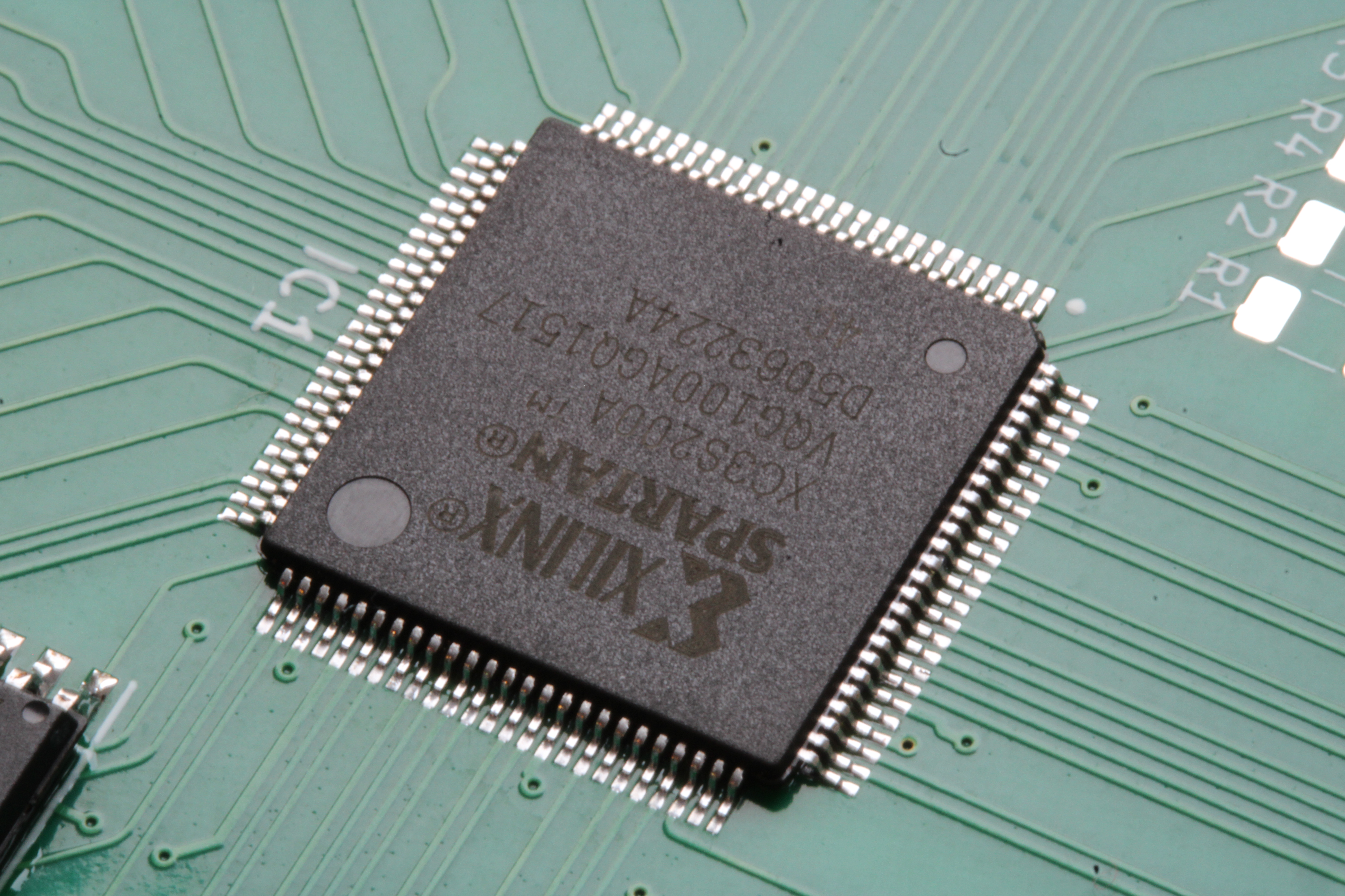

Placed an order for the boards. Made this one a 32K one to keep complexity down and also making it able to reuse my existing components. If all (or even some) of the concepts I want experiment with work out well, I'll make a bigger better version later on.

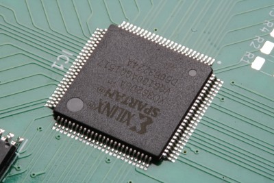

What is U2?  Is that the FPGA you mentioned a few posts ago?  I see what looks like a QFP package.  Are you able to solder that?
J64C
Posts: 239
Joined: 11 Jul 2021
Re: The J64C
Post by J64C »
Certainly is an FPGA. :D
Yeah, thankfully my soldering is fairly reasonable. While not the most fun thing to hand solder, this is the typical outcome from my previous efforts. Fairly traumatising at the time, but worth it.

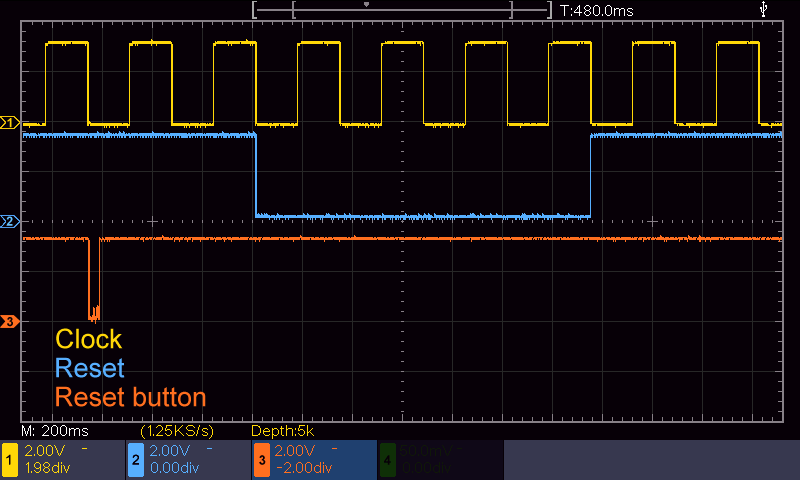

OCD mode enabled, in anticipation for my boards and parts to arrive.
The reset circuit.
I know the 'requirement' is two clock cycles, but what's an extra couple between friends. :lol:

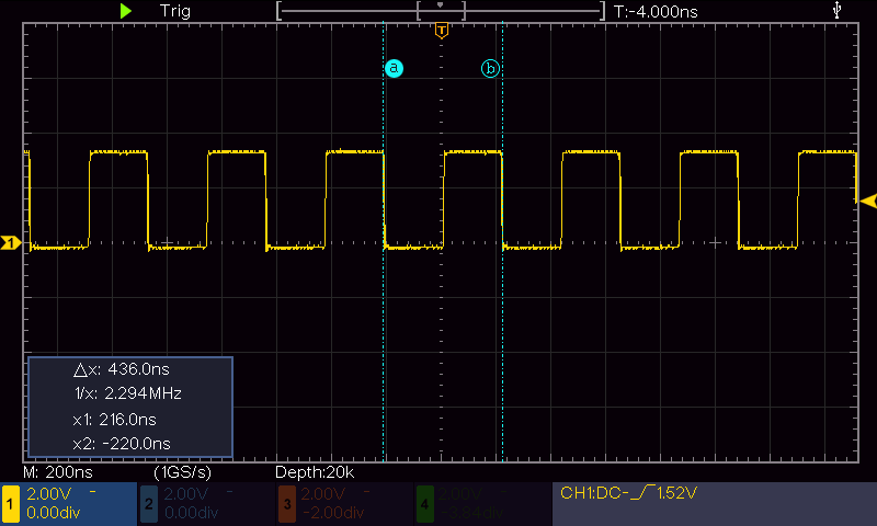

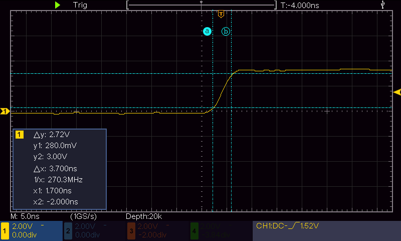

Post by J64C »

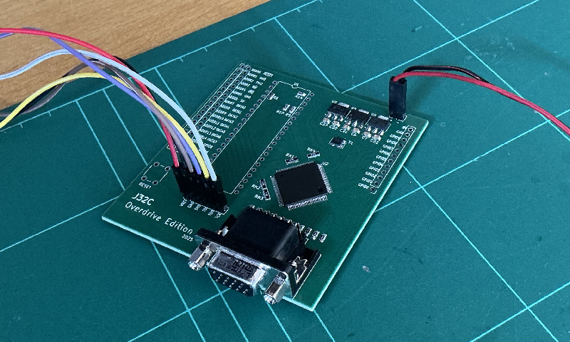

Parts are here and assembly has begun. I've soldered the extremely nasty components and am testing as I go. So far so good!
Quite happy with how clean the clock has come out, measured at where the PHI2 input will be at the 6502. Very clean, no ringing, and a 3.7nS rise/fall time.

W65C02 will run reliably at 25.175mhz at 3.3V. You’ve got enough parts on board to get VGA display running.

Yep. VGA already running now. Working on more of that front today and hopefully get the 6502 going also.

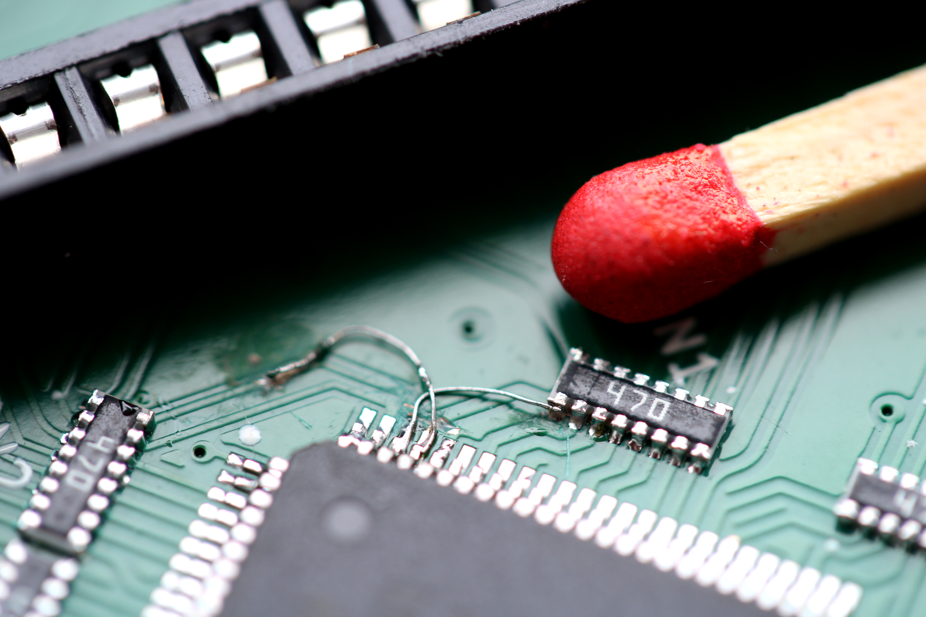

Post by J64C »
One of the more traumatic modifications I have ever had the pleasure to conduct.
barnacle
Posts: 1831
Joined: 19 Jan 2004
Re: The J64C
Post by barnacle »
My, that's a big match! :mrgreen:
J64C
Posts: 239
Joined: 11 Jul 2021
Re: The J64C
Post by J64C »
Certainly is! :lol:

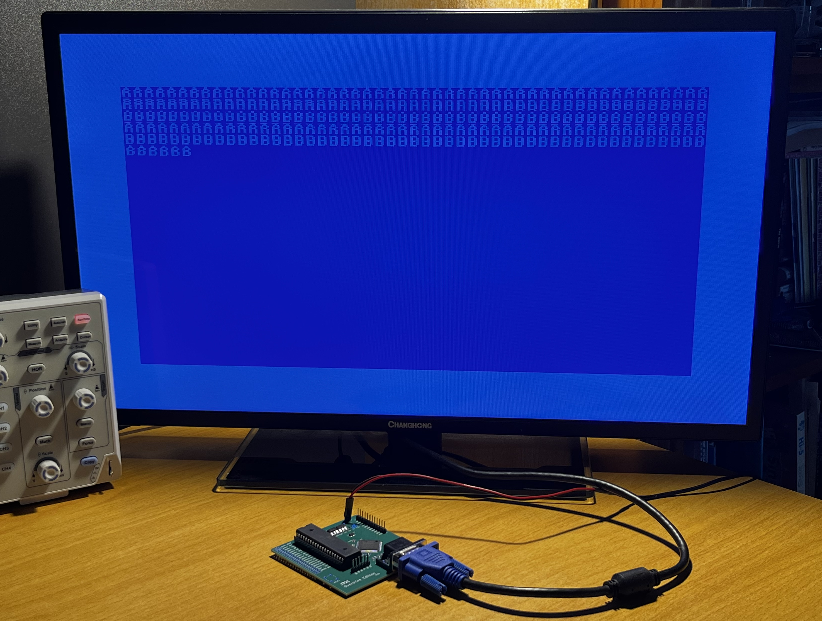

So far so good. Two chip design, executing a routine to fill 256 characters between A & B. Running at a modest 18.8 MHz at 3.3v. I'm sure it will clock higher but the next jump is 37.6 MHz, which is a bit much at 3.3v (I know, I tried it. :lol: ).

What are we seeing?  The screen looks almost black to me.  Is it perchance mostly blue?

Yep, blue on blue. Will change the colour scheme on the next run, as I remember you are “colour challenged”. Don’t worry, I’m starting to become “vision challenged” overall. Some of this soldering wasn’t fun at all. Hehe!

Here we go, BDD. :D
The letters look mangled at this speed, but they are fine. I haven't added any form of vSync testing yet, so they are getting overridden mid raster.
Had a quick attempt at some clock stretching but I couldn't get it as granular as I was hoping (not at 6 am in the morning anyway :lol: ). Will rethink how I'll approach that later on, so ~18.8 MHz is it for the moment. Will probably look at some boolean approaches later on.
