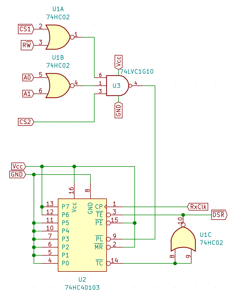

For those still wanting to use the W65c51, warts and all, the idea of externally counting time and feeding back a signal to the /DSR input is a good one. There's an easier way to do it, however, which will work in most practical configurations with less "gubbins". I think I have it down to two dedicated ICs, plus an inverter that might be left over from somewhere else in the design.
My solution would be to use a 74HC40103 (an 8-bit presettable down-counter) to count pulses of the RxC clock, which the W65c51 presents as an output if neither Rx nor Tx are configured to use an external clock. With both configured for the internal clock, both also run at the same baud rate, and the RxC output pulses at 16x rate. The external clock input feature is primarily used to explicitly synchronise one ACIA to another, or to run at a non-standard baud rate such as for MIDI, so for most applications RxC will accurately reflect the Tx clock.
In 8N1 format (10 bit times per frame), and 16 clock pulses per bit, each byte transmitted takes 160 pulses. This can be hardwired into the '40103 preset, or you could play it safe by presetting it to 192 instead (12 bit times); either option straps two pins high ($A0 and $C0 respectively) and the rest low. An active-low pulse on the /PL pin will load this value into the counter independently of the RxC clock. Tie /MR and /PE high to prevent spurious presets.
When the counter expires, it will pull the /TC output low. Feed this through an inverter and back to the /TE input, so it will stop counting at zero and keep /TC asserted, then resume counting when the preset is loaded. No additional flipflop is required to hold this status. Either the active-low direct or active-high inverted /TC drives /DSR on the W65c51. The /DSR status bit then replaces the TxBUSY status bit as previously described.
As well as saving several ICs, the major advantage of this approach is that you don't need to change anything to support different baud rates or frame formats, largely because the RxC clock is automatically varied by the ACIA for you. The 192 preset (12 bit times) is enough to cover an 8-bit byte, a parity bit, and two stop bits - a maximum combination which I'm not sure the W65c51 even supports in the first place. Smaller frame sizes will also work with this preset, but there will be slight gaps between characters and the transmission rate will be correspondingly reduced.

I managed to distill this into a diagram:
Re: Working around the W65C51 transmit buffer empty bug
Nice and compact, I think you ought to AND in PHI2 though on the PL signal, otherwise it could get triggered erroneously while the buses transition.
If that proves necessary, it could be done by substituting a /WE signal (which most systems will have anyway) for the R/W input to the trigger circuit. Same gates otherwise.

Here's another spin -- one of many possible -- on the supporting logic.
