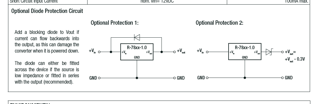

Garth reminded me that back in the day, we used to place a zener that way to protect the circuit from an overshoot that sometimes occurred at power-on.
Of course switching regulators like this weren't available back in the day, but it's well known that linear regulators require a protection diode in certain circumstances, the goal being to prevent current from flowing backwards through the regulator at powerdown.
Although superficially that may seem impossible, it can occur in certain circumstances. For example, the circuit (the load) attached to the regulator output may include considerable capacitance due to the bypass caps that are present, and that capacitance will contain stored energy. At powerdown, that energy needs to be discharged, and if the regulator input voltage plummets too rapidly, current will pass backwards through the regulator (unless the protection diode is present).
A look at the Recom datasheet (attached) reveals that their handy little switching regulator likewise faces that powerdown issue, and a protection diode may be required for that reason. (The datasheet also suggests a minimum load of 10 mA, which presumably explains GamerFox's inclusion of R2 and R3.)

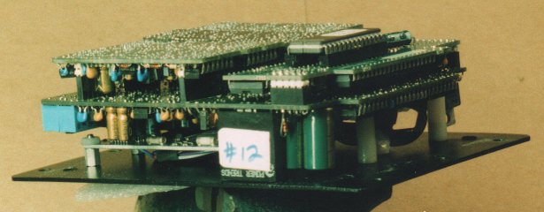

My comment came specifically from using one of Power Trends' integrated switching regulators, the 78SR112 12V regulator, in a design in 1994. You can see it here as the approximately 1" square black thing with the "#12" label on it.
It's kind of a thermoplastic box with the other side open where you can see the components in it. They required a 5W ZD at the output to shunt out turn-on overshoot. I don't know why they didn't just integrate it into the integrated switching regulator.

Re: 65c816 "Core"
Here's the inside:
It's an 18-watt regulator. Since the board is not all way way down in the box, there may be parts on the back, too (or maybe it's only the other half of the inductor core).
