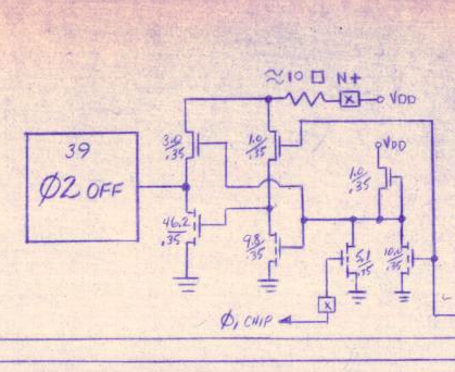

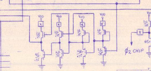

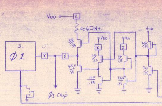

As for the schematics, here are a few crops from the blueprints, as kindly scanned by Donald Hanson and shared with the following agreed attribution: "(Credit: crops from MOS Technology Sheet 2 "650X-C Logic Diagram Microprocessor" "Engineering Approval by ORGILL, MENSCH" dated 8-12-75, Scan: Courtesy of Donald F. Hanson, Dept. of Elec. Engr., Univ. of Mississippi)."
These are all from the north edge and relate to the clock pins. See also the crop previously linked on the wiki page - that's an archive link because the original is unfortunately offline at present.
Sorry this is a bit of a jigsaw puzzle, but the original scans are not freely redistributable. It would be a good thing for someone to draw out what's going on here: 3 pads, 2 on chip clocks, and metallisation options to allow either 6501 or 6502 usage of the pads.
The circuitry under (to the south of) pad 37, as seen on the wiki page, shows a NOR gate, which presumably was sufficient to make the on chip clocks non-overlapping.
Credit: phi1off driver, optionally drives pad 3, cropped from MOS Technology Sheet 2 "650X-C Logic Diagram Microprocessor" "Engineering Approval by ORGILL, MENSCH" dated 8-12-75, Scan: Courtesy of Donald F. Hanson, Dept. of Elec. Engr., Univ. of Mississippi
Credit: phi1chip pad 3 cropped from MOS Technology Sheet 2 "650X-C Logic Diagram Microprocessor" "Engineering Approval by ORGILL, MENSCH" dated 8-12-75, Scan: Courtesy of Donald F. Hanson, Dept. of Elec. Engr., Univ. of Mississippi
Credit: phi2off pad 39 cropped from MOS Technology Sheet 2 "650X-C Logic Diagram Microprocessor" "Engineering Approval by ORGILL, MENSCH" dated 8-12-75, Scan: Courtesy of Donald F. Hanson, Dept. of Elec. Engr., Univ. of Mississippi

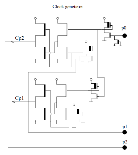

Well, between being able to see only small excerpts of the MOS 6502 schematics, my poor skills at reading them and the Visual 6502 Wiki being down it seems I'm not going to get much out of those unless someone else wants to supply some help. However, I did see a mention of on this archived wiki page of a "Giant Schematic" which I eventually found here and have also attached to this message with a slightly clarified name. My understanding from the page above is that this is a Rockwell 6502 schematic and the title in the upper right corner, "R6502," seems consistent with that. It's at least NMOS, so I would imagine should not be too far from MOS behaviour.
The part of the circuit relating to the three clock pins is down in the lower right corner and seems exceedingly simple:
If I'm reading this right the ϕ0 input seems to go through very minimal processing before becoming the chip clock signal which is also directly output to ϕ2. I would guess there that there is going to be a tiny bit of delay on the output, but not enough to cause any issues with using ϕ0 instead of ϕ2 to clock things. But I'm not clear what's going on then with the slow rising edge I'm getting out of the CPU I captured near the top of the thread, which is marked as an R6502 (but might be some other chip, though it's definitely NMOS from the power consumption).
Is the schematic above basically the same as the MOS schematics that have been posted to this thread?

Posts: 11464
Re: When should Φ2 be used over Φ0? (Or: Φ0 vs. Φ2 vs. RWB)
Hi Curt, good idea to look at Balazs' giant schematic. There's a pretty good chance it matches the MOS blueprints - but I have a bad head today and can't do the necessary investigation.
As for the slow rising edges, it's a typical problem of NMOS technology that it's difficult to get a fast pullup, so I think what you saw there is very likely just indicative of that. The crucial voltage of the on-chip clock will be down near 1v, and certainly below 2v, as that's when pass transistors will turn on. The remainder of the rising edge being quite slow won't have much effect, I think.

To my eyes, the bottom diagram ("phi2 off") matches the top left four transistors in your diagram plus the three just to the right of them, but the ones to the far right on your diagram aren't on the hand-drawn one. Note that it shows a connection to "phi1 chip" that connects to the rest of your diagram. Your one is missing the resistor to VCC, which would explain the slow rise time on ph2out (which is something I've observed in an NMOS 6502 in the past as well, so I don't think it's unusual).
The bit missing to the right of the cropped diagram is just an inverting buffer - it may actually be just on the right hand side of the first diagram BigEd posted, slightly cropped off the edge.
I'm having more trouble corresponding the phi1 side of things between your diagram and the hand-drawn ones. The hand-drawn ones seem to have a lot more buffering in them.
So in your diagram then, looking at what it actually does - the three transistors in the top right form an inverter from p0 (with one of them just being there to protect against static discharge or out-of-range input voltage I think). The three transistors down an left from that are very important - they form a NOR gate, NORing this inverted phi2in with phi1. This ensures that phi1 and phi2out are non-overlapping - they'll never be high at the same time. Effectively phi2's rising edge will get delayed until phi1 has settled low.
Then the four transistors in the top left just invert that signal twice, with totem pole inverters, which will buffer it I guess before it gets used in a lot of places on the chip.
The phi1 side is simpler - inverted p0 is re-inverted, then inverted again, and then fed through two more totem pole inverters before going out to the rest of the chip and the outside world.
The top diagram in BigEd's post does the same as this but re-inverts another two times. It's possible that they originally designed it that way, but then took out the extra two inverter stages; or the diagram you found was just simplified a bit.
Edit: taking a second look, the middle hand-drawn diagram in BigEd's post does match the lower half of the diagram in your post. I'm not sure what the top diagram in BigEd's post is about.
