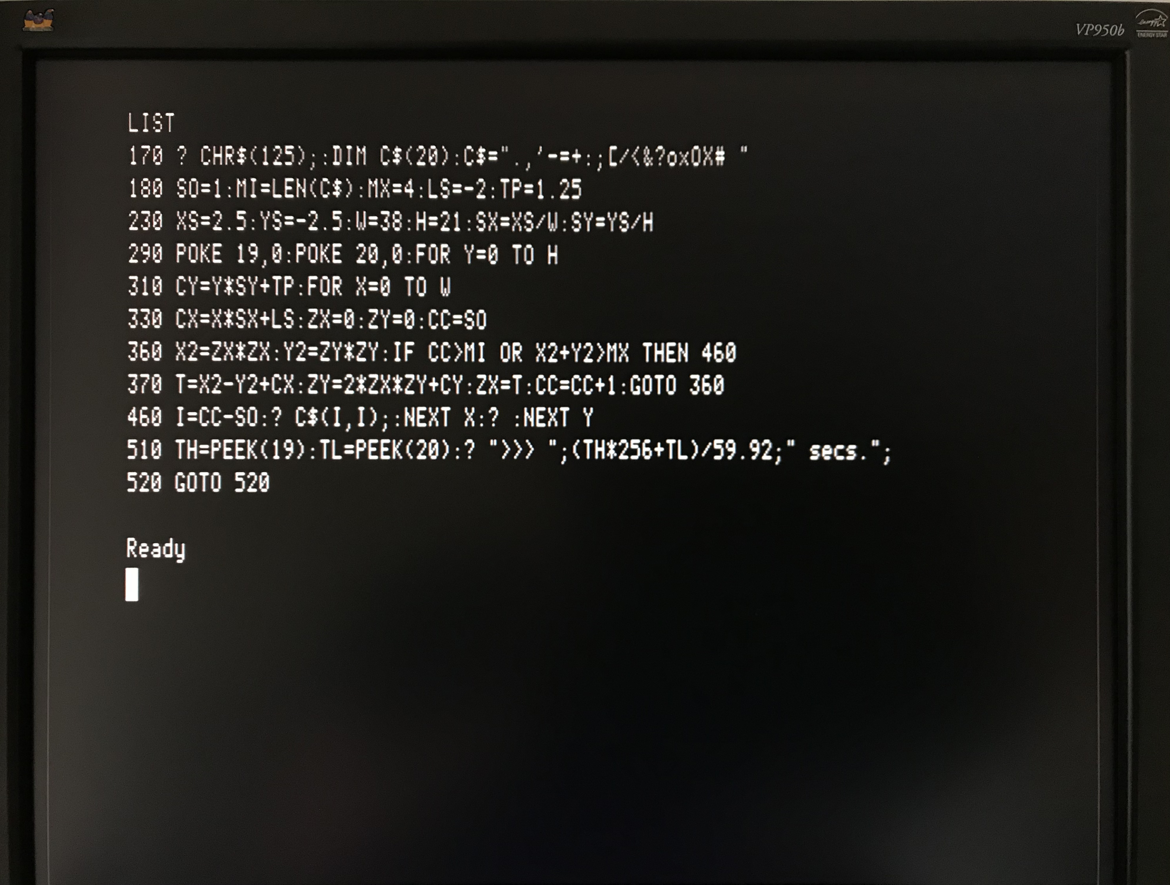

On actual Atari 800 / XL hardware, running Altirra Basic 1.57 (8KB) and Altirra 3.28 FP rom (2KB, part of OS-rom), exactly fittimg originally address space, thus being a byte-for-byte replacement (no need to burn them, as Atari XL's MMU fully supports soft-loading these packages on stock HW from any SIO-attached disk):
Slightly re-arranged code to shorten the lines-list (chops 4 secs. from original 110.33 secs run).
Output running on XEP80 80-cols display ('Console-mode") enabling 6502 to run at full 1.79Mhz tilt, minus OS overhead. Exactly same as stock machine by simply turning Antic's DMA operation OFF and then ON via OS vector (559=0, or 559=34, decimal)
We have not even tried TurboBasic XL v1.5 (interpreted) or FastBasic v4.0, which will blow these times out-of-the-water.

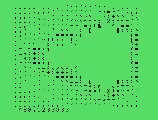

I have just got data for a very unusual computer. It is about the TI-99/4A. It was the first 16-bit home computer though some people think that the first true 16-bit home computer was https://en.wikipedia.org/wiki/Electronika_BK
The TI-99 has only 256 bytes of fast 16-bit RAM. The other 32KB of RAM is an optional expansion that is only available via the 8-bit bus.
The TMS9900 is the processor for the TI-99. Its architecture is memory mapped and therefore resembles the 6502. The TMS9900 can easily do register context switching and this resembles the Z80. The TMS9900 has 16 GPR and this resembles the ARM. The TMS9900 ISA is almost orthogonal and this resembles the DEC PDP-11. This processor uses +5, -5, +12V and this resembles the 8080. The TMS9900 has also several unique traits like unusual arithmetic flags.
The TI-99 Basic screen has 24 rows and 28 columns. Actually there are 32 columns on Basic screen but it is possible to use only 28 of them for PRINT. It seems that some ancient TV sets couldn't show characters on the screen edges properly. The TI-99 has a 40x24 video mode but Basic doesn't support it.
The software system timer on the TI-99 is only 8-bit wide. It is a very odd for a 16-bit system. This oddity can be explained by the fact that the timer has poor accuracy, because the system disables the timer every time the video memory is accessed. So I had to implement a wider timer and make its correction.
The sources are available on https://gitlab.com/retroabandon/bascode
