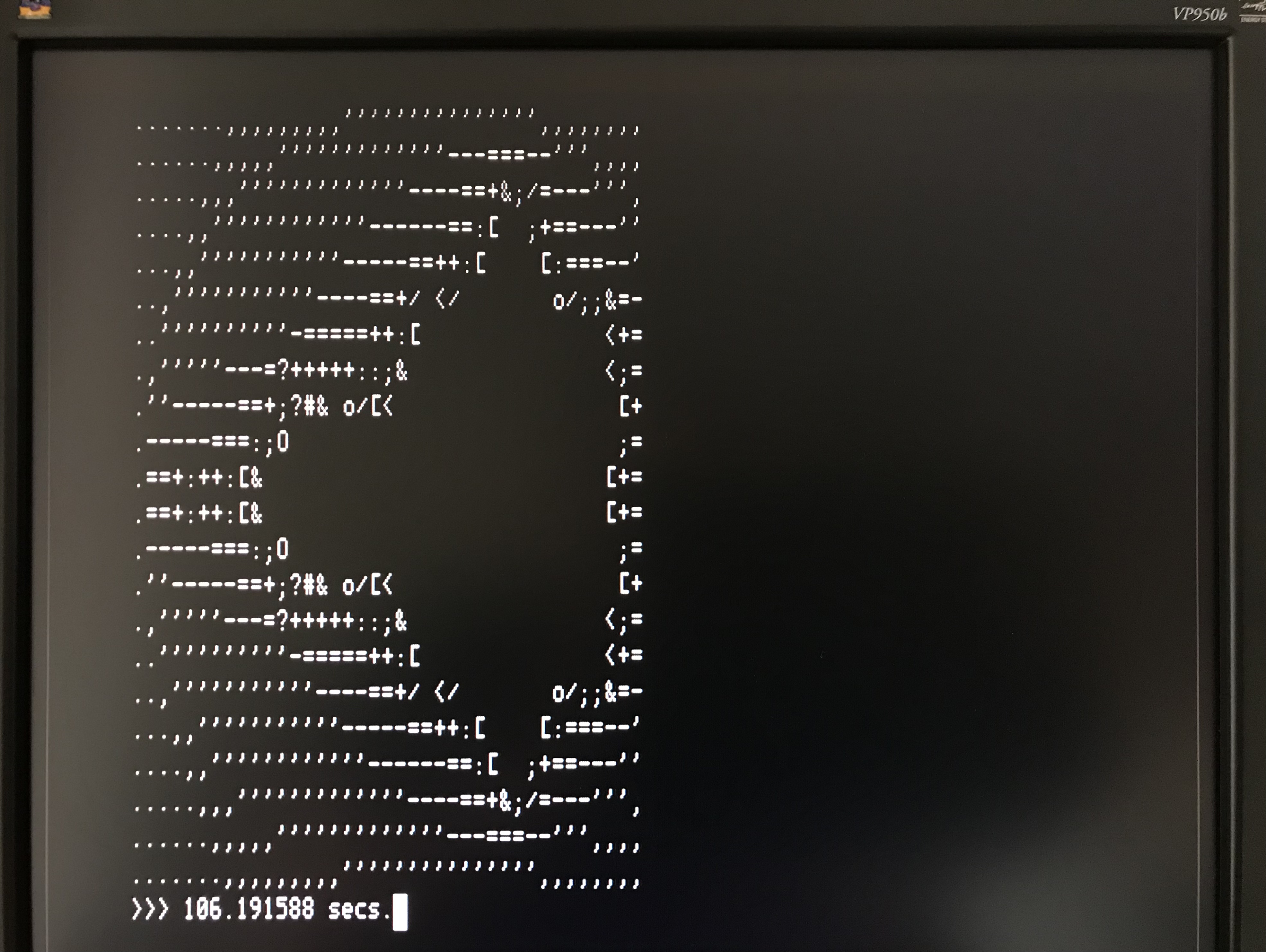

On actual Atari 800 / XL hardware, running Altirra Basic 1.57 (8KB) and Altirra 3.28 FP rom (2KB, part of OS-rom), exactly fittimg originally address space, thus being a byte-for-byte replacement (no need to burn them, as Atari XL's MMU fully supports soft-loading these packages on stock HW from any SIO-attached disk):
Slightly re-arranged code to shorten the lines-list (chops 4 secs. from original 110.33 secs run).
Output running on XEP80 80-cols display ('Console-mode") enabling 6502 to run at full 1.79Mhz tilt, minus OS overhead. Exactly same as stock machine by simply turning Antic's DMA operation OFF and then ON via OS vector (559=0, or 559=34, decimal)
We have not even tried TurboBasic XL v1.5 (interpreted) or FastBasic v4.0, which will blow these times out-of-the-water.
