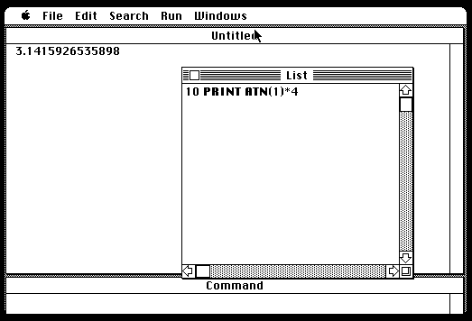

While poking around, I stumbled upon an in-browser emulation of "MS BASIC 2.00.00" running on what appears to be a first-generation Macintosh. The mouse doesn't track exactly right on my PC, but the functionality seems to be there, at first glance anyway, and the user interface is clumsy by today's standards but still intuitive.
(... looks like it offers 64-bit MS floats ... nice!)
