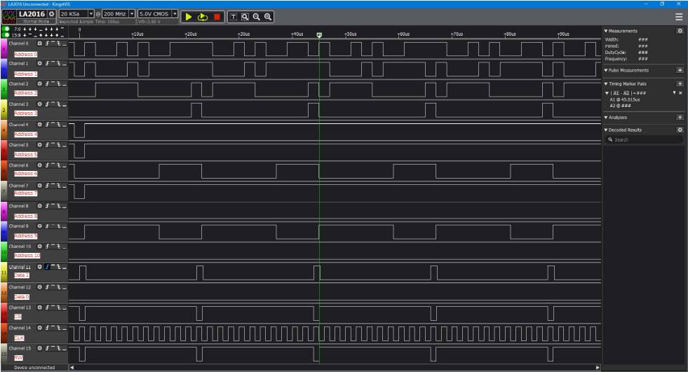

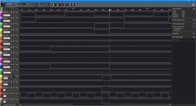

after over a month I come here with another problem :) A lot lot lot of debugging with very little free time .....
In my design I have a 8k window in the 64kByte address space to map in the VGA memory or future memory expansions. That worked as expected when using 2kByte HT6116-70ns SRAM. But when I used IS61C5128 in the same environment - with 8 address bits set to 0 - something strange happened. Sometimes writes would modify 2 or more addresses with the same value. I think I finally figured out the reason for that - take a look at this capture from the logic analyzer.
The addresses change before CE and RW lines go high. I guess the fast RAM just has enough margin to write additional cells before CE/RW go high.
I have an idea how to solve that - put in a buffer on the address lines (2 74xx574 chips) instead of the 245 I need anyway and trigger them on the rising clock pulse.
Any better ideas?

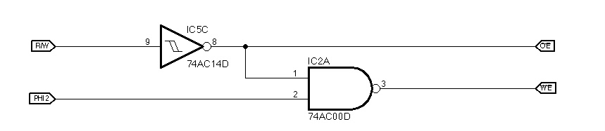

Try qualifying R/W with PHI2 to derive a /WE signal for RAM, like this:
Other signals going to RAM usually trail the fall of PHI2 by some margin and will therefore hold steady while /WE is low. That should prevent other addresses from being modified by the write.

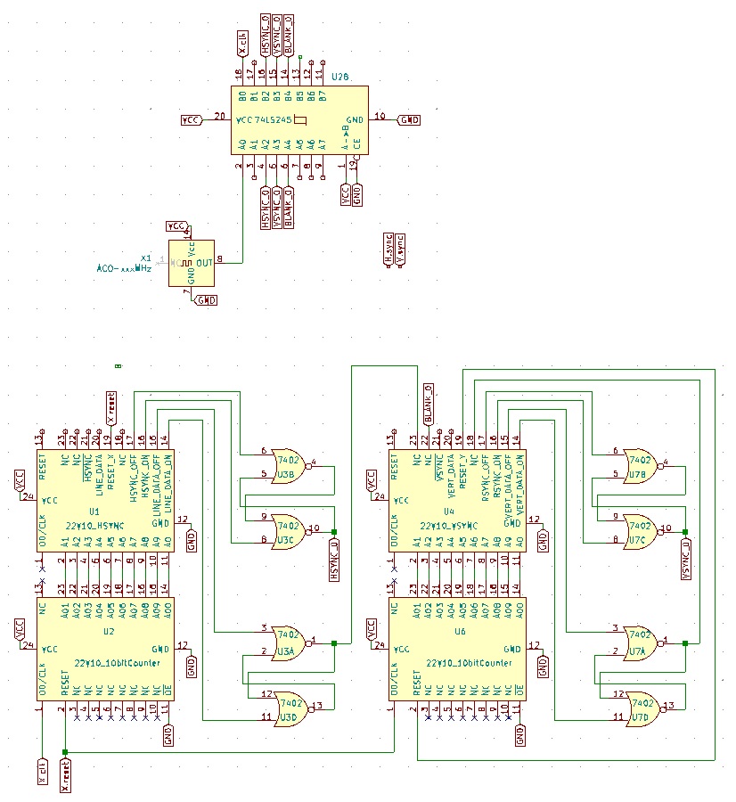

so that was a long break, but when COVID hits your son's daycare suddenly all free time evaporates. At least no one in my family got sick :)
Last report was on write problems to the DIMM. I could solve that issue by converting to CPU R/W line into a 20ns pulse, so that writes happen only during a short period of the complete 6502 write cycle. That solved all issues, and I could program the memory to generate all SYNC signals correctly. Unfortunately .... when I hooked up to the monitor it would not synchronize. The reason was simple. The monitor did not recognize the 640x400 resolution I had programmed, but tried instead to go to 720x400.
At that point my plan to be able to switch between various resolutions vaporized. Looks like modern LCD monitors are not truly multisync, but have a number of fixed frequencies programmed in. I have to stick to standard VGA, and with that in mind using a programmable memory did not make sense anymore. So I decided to do SYNC generation with 2 more GALs and 2 74LS00:
The code for HSYNC GAL:

Originally I tried to implement the logic as state machine. Although it worked well in simulation, in real life I could not get it to work, so I settled for this simpler approach which worked pretty well. One more issue bugged me - I saw two horizontal areas on the screen that were considerably darker slowly moving up or down (depending on exact timing used). I tried for almost 2 weeks to figure out why the picture was not stable.
Until I realized that the behavior was very much akin to an acoustic beat https://en.wikipedia.org/wiki/Beat_(acoustics) between the nearly 60Hz picture frequency and 60Hz power. Replacing the power supply with a battery and the error was gone

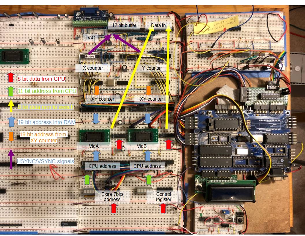

Here is a first pass of the new setup:
The XY counter generates all the time necessary VGA sync signals. It can also serve as 19bit address counter to either Video Ram. In that case the data from that Video Ram is switched via "Data In" chips onto the 12 bit buffers and send out to the VGA connector.
Alternatively the CPU can get access to either Video Ram. I use a 4kByte window (6 bit x by 6 bit y), augmented by 7 bit of a additional address register to map all 512kbyte into the 6502 address space.
too late today, schematic next time :)

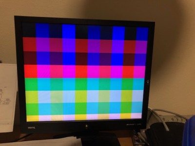

Quick update
it liiiiiiiives ......
The board is a little bit messy though .....
