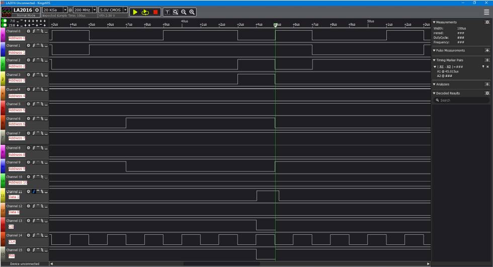

after over a month I come here with another problem :) A lot lot lot of debugging with very little free time .....
In my design I have a 8k window in the 64kByte address space to map in the VGA memory or future memory expansions. That worked as expected when using 2kByte HT6116-70ns SRAM. But when I used IS61C5128 in the same environment - with 8 address bits set to 0 - something strange happened. Sometimes writes would modify 2 or more addresses with the same value. I think I finally figured out the reason for that - take a look at this capture from the logic analyzer.
logic_Analyzer-why sometimes several addresses get changed - 01-a.jpg [ 58.65 KiB | Viewed 1120 times ]
logic_Analyzer-why sometimes several addresses get changed - 02a.jpg [ 52.11 KiB | Viewed 1120 times ]
The addresses change before CE and RW lines go high. I guess the fast RAM just has enough margin to write additional cells before CE/RW go high.
I have an idea how to solve that - put in a buffer on the address lines (2 74xx574 chips) instead of the 245 I need anyway and trigger them on the rising clock pulse.
Any better ideas?

Try qualifying R/W with PHI2 to derive a /WE signal for RAM, like this:
Other signals going to RAM usually trail the fall of PHI2 by some margin and will therefore hold steady while /WE is low. That should prevent other addresses from being modified by the write.

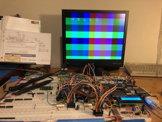

so that was a long break, but when COVID hits your son's daycare suddenly all free time evaporates. At least no one in my family got sick :)
Last report was on write problems to the DIMM. I could solve that issue by converting to CPU R/W line into a 20ns pulse, so that writes happen only during a short period of the complete 6502 write cycle. That solved all issues, and I could program the memory to generate all SYNC signals correctly. Unfortunately .... when I hooked up to the monitor it would not synchronize. The reason was simple. The monitor did not recognize the 640x400 resolution I had programmed, but tried instead to go to 720x400.
At that point my plan to be able to switch between various resolutions vaporized. Looks like modern LCD monitors are not truly multisync, but have a number of fixed frequencies programmed in. I have to stick to standard VGA, and with that in mind using a programmable memory did not make sense anymore. So I decided to do SYNC generation with 2 more GALs and 2 74LS00:

Originally I tried to implement the logic as state machine. Although it worked well in simulation, in real life I could not get it to work, so I settled for this simpler approach which worked pretty well. One more issue bugged me - I saw two horizontal areas on the screen that were considerably darker slowly moving up or down (depending on exact timing used). I tried for almost 2 weeks to figure out why the picture was not stable.
Until I realized that the behavior was very much akin to an acoustic beat https://en.wikipedia.org/wiki/Beat_(acoustics) between the nearly 60Hz picture frequency and 60Hz power. Replacing the power supply with a battery and the error was gone

Oszi shows some strange dips of about 0.5V on all signals in line with the image. Putting 470uF capacitors on all small breadboards improved situation, but problem is still noticeable.
After a few changes to the firmware I could generate images out of the Video Ram.
