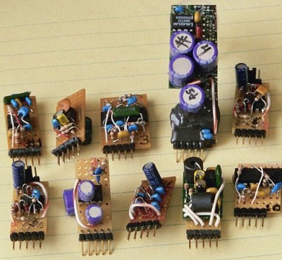

Reusable modules are great. Goals for a home-made computer tend to quickly become too lofty to carry them out in your lifetime—or change faster than you can build. It helps to have various sections ready-made (hence my memory modules, and other tiny ones I hope to offer). For my own use, I have a lot of reusable tiny analog modules so I don't have to keep re-building them for every breadboard. This is about one-third of them:
YES!
This is a great idea and one I have used a lot, especially in microcontroller work. Saves so much time, effort and mess. Works with digital stuff too.
That's a great idea. "Shields" before we called them shields.
