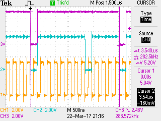

Perhaps I didn't express it well enough. The information given in the datasheet of the W65C265 (Table 3-4 AC Parameters) is headed with "VDD=5V / 8MHz". The timing specs within this table says "tCYCF = 250ns Min." but this is 4 MHz not 8 MHz! So I am a bit puzzled. Is it just a typo in the heading of that table? Or could it be that the W65C265 is limited to less than 8 MHz? If the other timing specs (worst cases) were correct, then it might last 90ns (tODA) after falling PHI2 until new addresses and data were valid. In case of 8MHz = 125ns cycle time there would no much time left. None of this timing specs doesn't belong exclusively to the SXB board nor to the new tiny QBX board.
I was simply confused with these specs and that no one else had said something about that in this forum.
This evening I took a scope and did some measurements (using the SXB board, taking signals from J1 XBus816 Connctor):
(The clock frequency is 3,6864MHz)
1. an endless loop LDA Long STA Long Jump loop executed out of internal RAM.
upper trace RWB - mid trace CS7B - bottom trace PHI2
2. same prog, first write access then jump back and read access

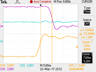

3. closer look to RWB and CS7B become asserted during PHI2 = 0
4. RWB and CS7B were deasserted after PHI2 = 1
This looks ways better than what is stated in the datasheet. OK, this way one cannot verify the specs, there are no extreme conditions (temp/voltage/bus load/etc). But at least it gives an idea of whats going on :)

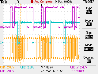

In order to make one post not too lengthy here are 3 more screenshots:
Same conditions, this time software runs in external memory (32KiB on board). The loop reads one byte from long addressed memory, then does a EOR #$FF and writes it back.
upper trace = D0, medium trace = CS7B, bottom trace = PHI2
Data ("1") is fetched, inverted, and stored back. But there is no RAM @ DD7722 so next time again a "1" is loaded.
closer look to D0
The databus is around 8ns after assertion of PHI2 settled -- so there is plenty time for a RAM to fetch it.
If my 265 isn't an extraordinary superfast exception, running the device with 8MHz or perhaps 10MHz should be possible.
