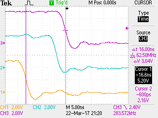

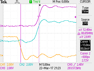

This evening I took a scope and did some measurements (using the SXB board, taking signals from J1 XBus816 Connctor):
(The clock frequency is 3,6864MHz)
1. an endless loop LDA Long STA Long Jump loop executed out of internal RAM.
File comment: upper trace RWB - mid trace CS7B - bottom trace PHI2
2. same prog, first write access then jump back and read access
3. closer look to RWB and CS7B become asserted during PHI2 = 0
4. RWB and CS7B were deasserted after PHI2 = 1
This looks ways better than what is stated in the datasheet. OK, this way one cannot verify the specs, there are no extreme conditions (temp/voltage/bus load/etc). But at least it gives an idea of whats going on :)

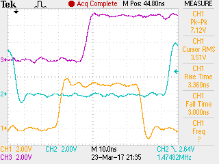

In order to make one post not too lengthy here are 3 more screenshots:
Same conditions, this time software runs in external memory (32KiB on board). The loop reads one byte from long addressed memory, then does a EOR #$FF and writes it back.
File comment: upper trace = D0, medium trace = CS7B, bottom trace = PHI2
Data ("1") is fetched, inverted, and stored back. But there is no RAM @ DD7722 so next time again a "1" is loaded.

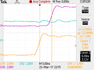

closer look to D0
The databus is around 8ns after assertion of PHI2 settled -- so there is plenty time for a RAM to fetch it.
If my 265 isn't an extraordinary superfast exception, running the device with 8MHz or perhaps 10MHz should be possible.
When writing to SRAM, meeting access time is not usually in data setup, but in address setup. I've done a few designs myself with both W65C02 and W65C816, and fast SRAM, and measured the relevant bus timing. In practice address becomes valid roughly 5 ns into the first half cycle and data roughly 5 ns into the second. Imagine address and data as registered at the CPU boundary, clocked on their respective clock edges, and you'd probably be very close to how it's actually implemented.
If it's anything like the WDC 65C02 or 65C816, it will run up to around 24 MHz. My designs do. And that's at 3V3.

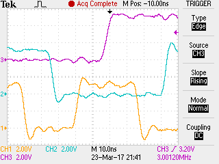

Well, I open the throttle a bit.
With 11,0592MHz (3x 3,6864MHz) signals are quite acceptable:
File comment: Top: D0; Center: CS7B; Bottom: PHI2
Next to 4x 3,6864 I used 15,0 MHz:
Now the 16..17ns delay PHI2fall to CS7=0 as well as nearly 20ns from PHI2rise to D0=1 becomes pretty prominent.
Next try with 22,1184MHz didn't work - but may be the quartz was unsuitable. It simply won't oscillate.
So far I'm quite confident with these results. Using 11,0592MHz seems to me an acceptable choice.
